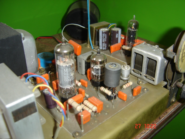

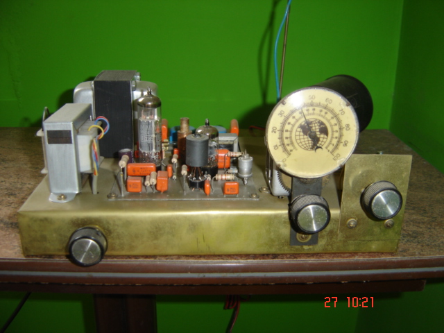

ECL85 has been designed for vertical oscillator and output in tube B&W TV's, where kink would be visible, not audible. I am using it in a regenerative receiver for AM using it in ultralineal classic way (Tap in the output trafo) with no problem at all.

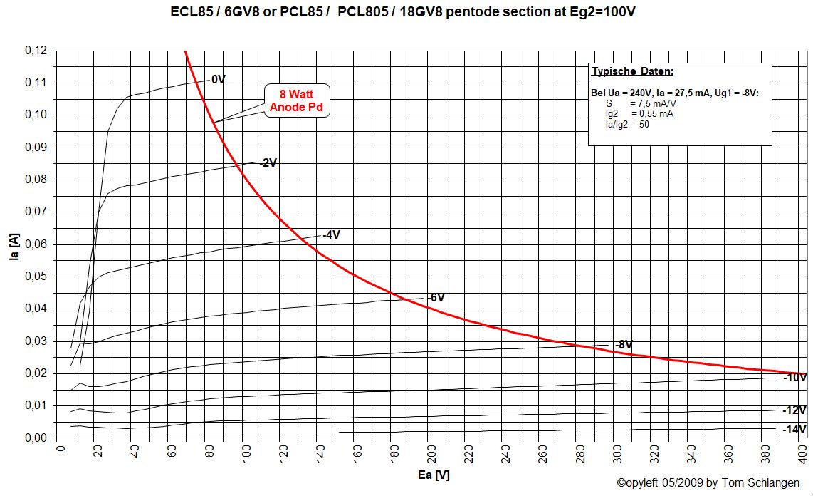

Head for lower Eg2 and enjoy a more useful operation area you can put your loadline in. Principle works for many tv deflection duty type beam tetrodes. Example plot for power section of ECL85 / 6GV8 or PCL85 / PCL805 / 18GV8 attached. Sorry, no plot for Eg2 = 80V yet 😉
Regards, Tom
How do you deal with kinky pentode curves such as those for 6GV8/PCL85 when designing a SE amp with them? It would seem one would want to stay away from that region but is pretty hard to do within power specs.

My experience with pentodes is that the lower the screen voltage, the less kinky behavior and less distortion. I always use the lowest screen voltage that I need to get the knee of the Vg=0 curve where I need it.

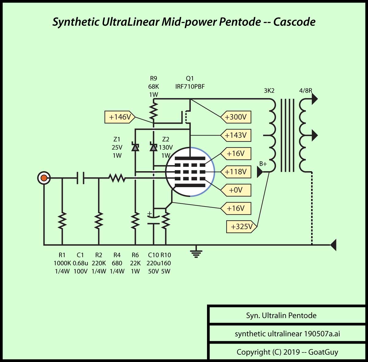

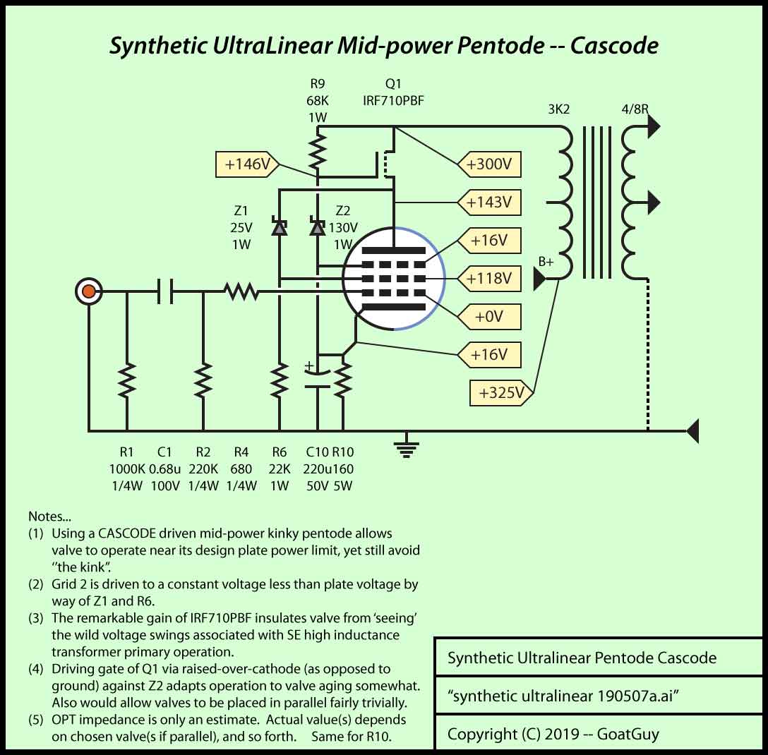

I had thought that if I ever made an SE amp, it would be a cathode follower, so on a whim I decided to see if I could build a driver that would drive such an output stage with low distortion. It also has application in my homemade Unity-Coupled amp which needs 160Vrms to drive the output stage to clipping.
But yeah, I learned some cool things about how to best use pentodes, which I think can improve the characteristics of this tube. Just lower the screen voltage and the kinkiness should get somewhat better. It might also be a good idea to grab a less kinky tube if that is a possibility. This one doesn't seem particularly great and will probably yield high distortion.

Tho' the design I posted didn't generate replies yet, I think it is a general purpose idea that grabs your position and allows the experimenter to “run with it” in almost any sense that makes sense to follow.
Just saying,
GoatGuy ✓
PS... did you mean 160 mVRMS? ... just wondering

Sure, it keeps the plate voltage fairly constant, thus avoiding the kinky area.
I did mean 160Vrms for the other amp, it is a 50% CFB configuration so takes a lot of voltage drive.
