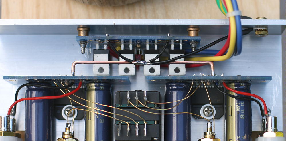

Even though the LM3875TF is isolated, it still needs heat sink compound between the back face and heat sink. Just make sure your metal chassis goes to the safety ground on the power in.
I can't seen in the pic, but are the RCA inputs isolated from the metal chassis.
PD does ground the power supply to the heatsink (chassis) in this pic.
PD LM3875 instructions.
https://audiosector.com/wp-content/uploads/2019/01/LM3875-kit-instructions.pdf
There is heat sink compound between chip and chassis, which has safety ground. RCA's are isolated. I don't think the mounting points on the PS board are part of the circuit, but my mounting point. is grounded through the mounting screw.

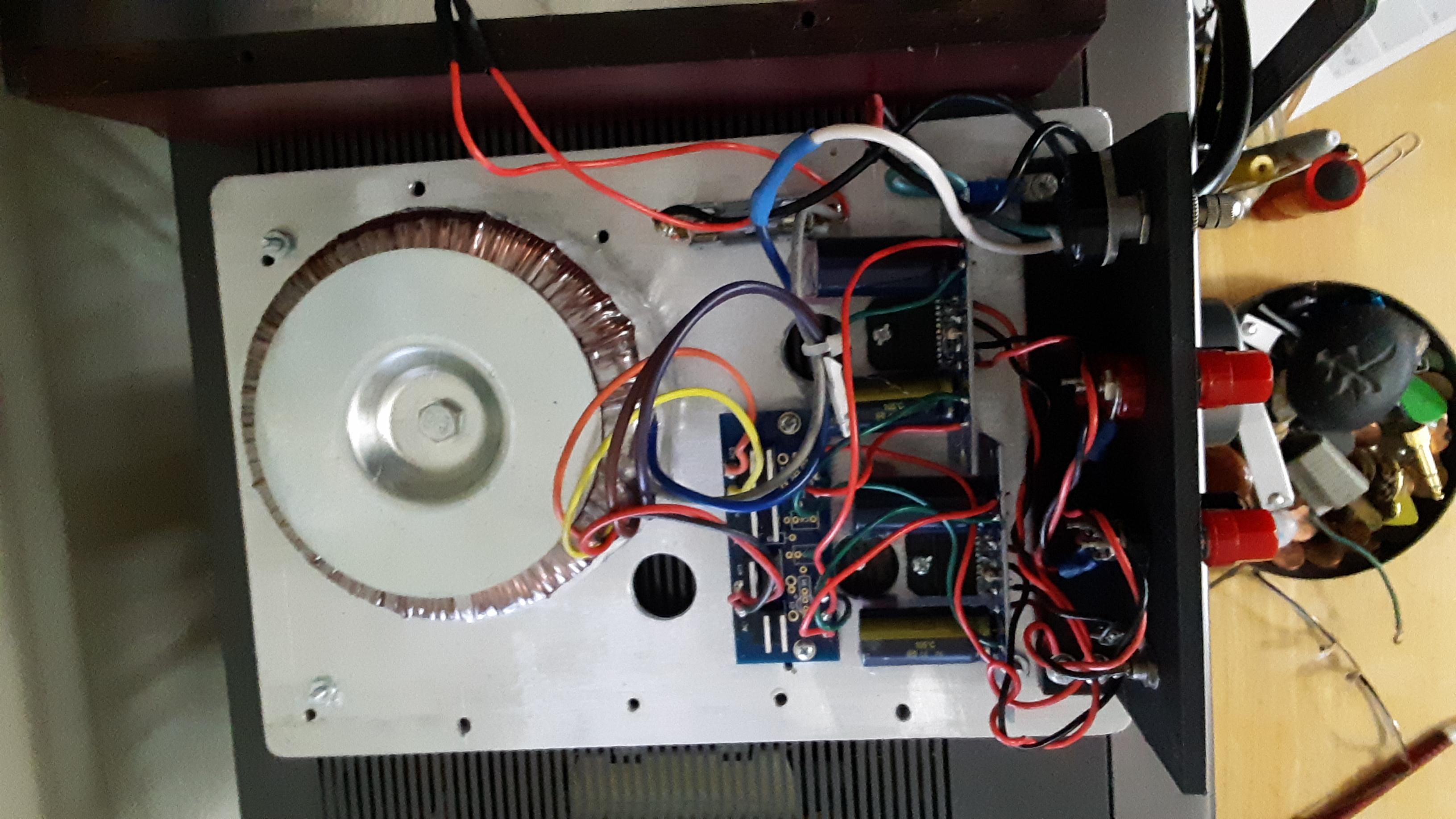

Well, I thought I had it. I found a short from one of the transformer secondaries to ground through the outer surface of the transformer. I couldn't see it, but removing the transformer from the chassi removed the short. I cut a sheet of thin plastic for an insulator, and the short is gone. The 15V to the chassis is gone. The buzz is still there. Time for a beer.
That is some progress anyway 🙂 Perhaps a metal burr or something on the chassis has penetrated the insulation of the secondary.
Buzzing from the speakers is a different issue and you would need to be looking at wiring layouts and grounding.
If it is mechanical buzz from the transformer then that is a different problem altogether.
Perhaps you need an audio isolation transformer in-between you source (PC if I understand correctly) and your amp?
I GOT IT! I started over, and the output had to be grounded to mains (which could be done now that the short was gone).
