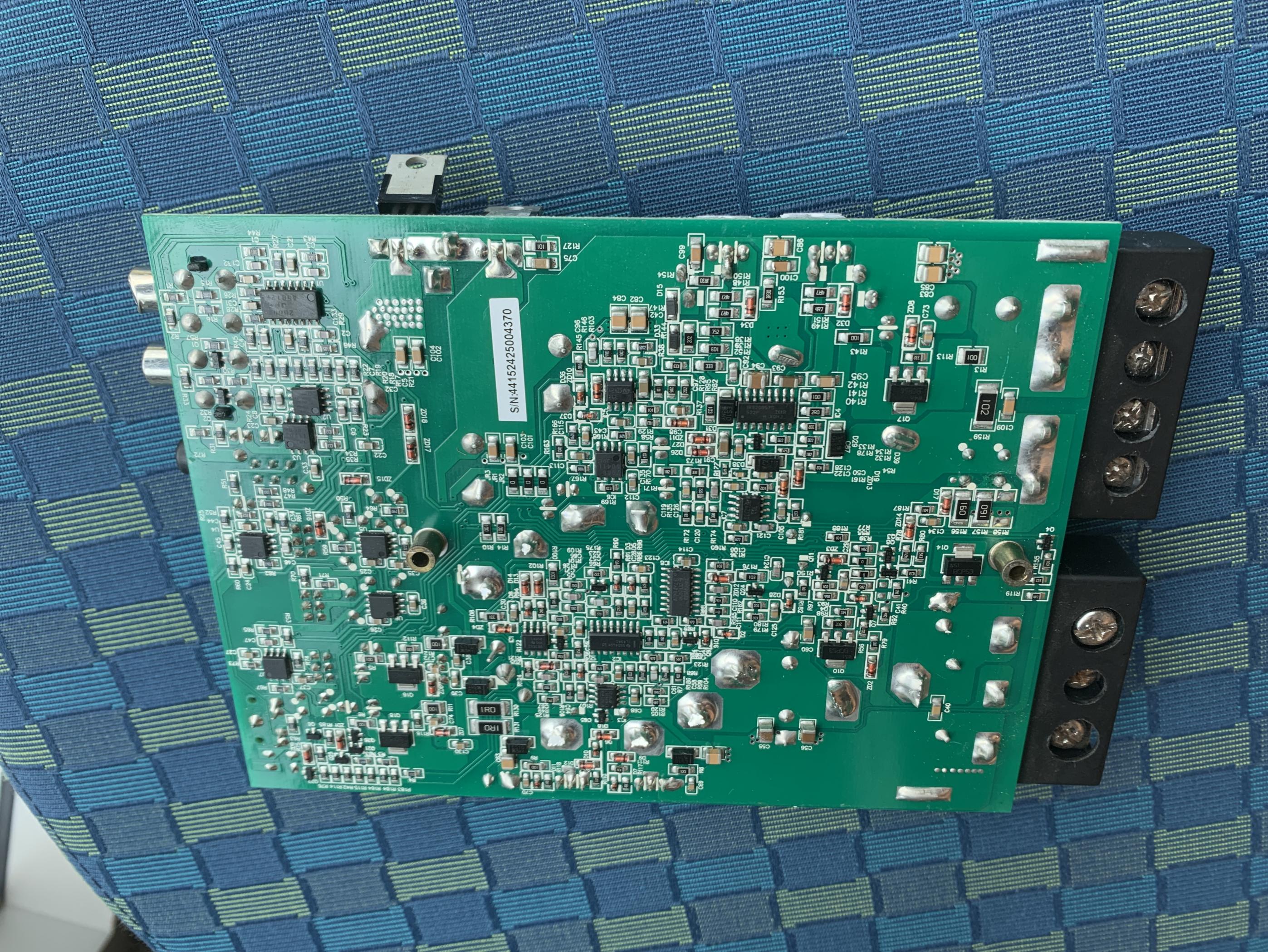

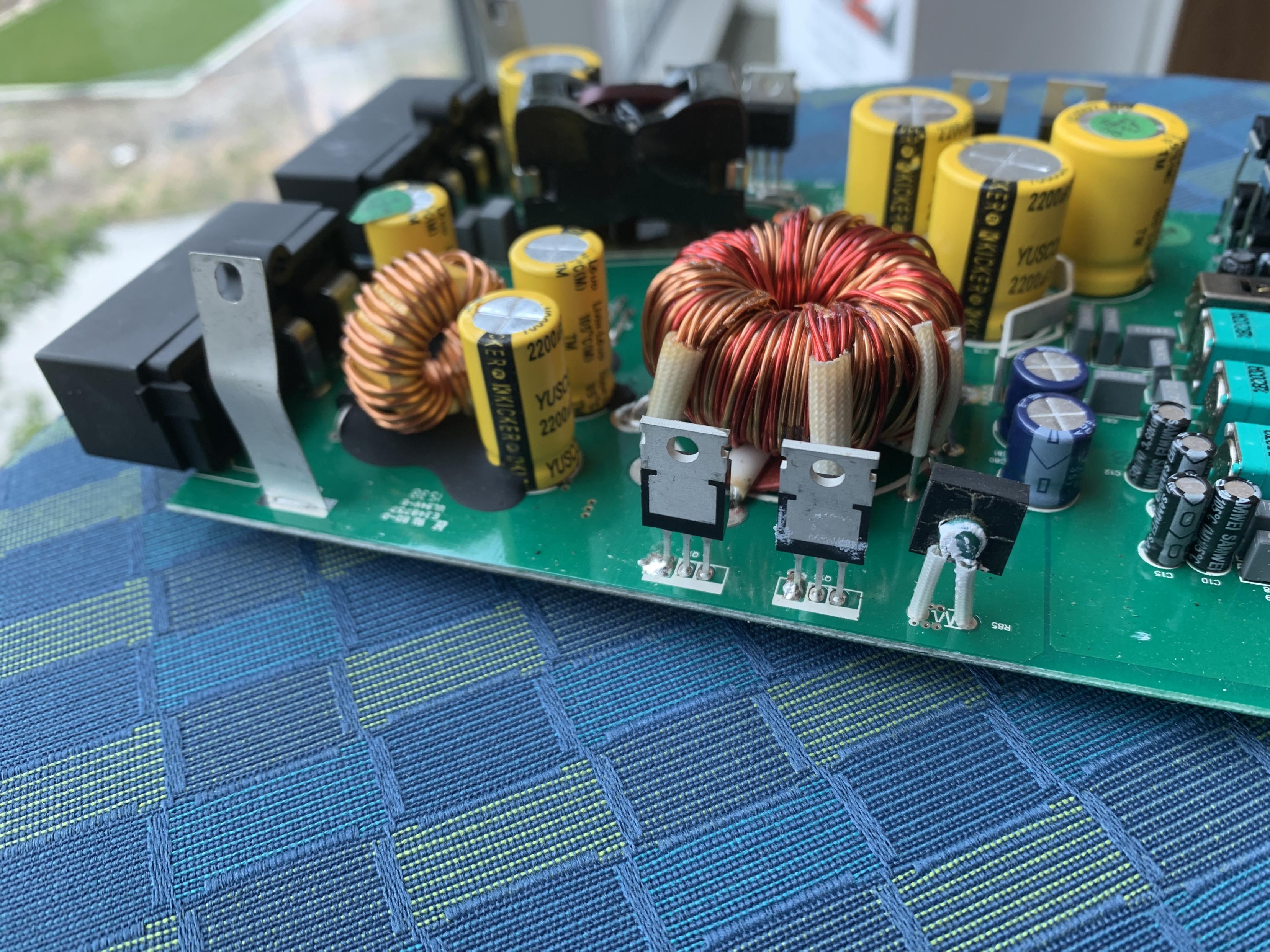

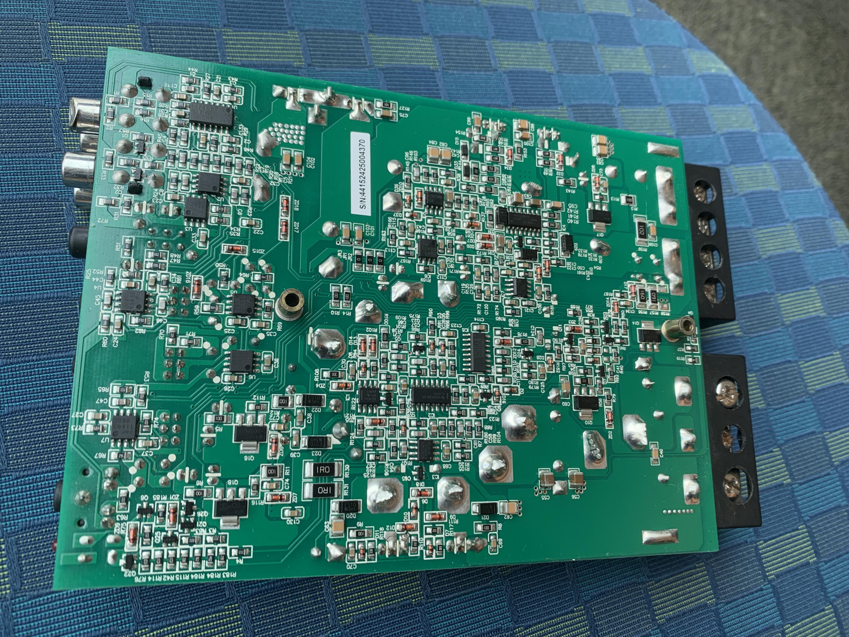

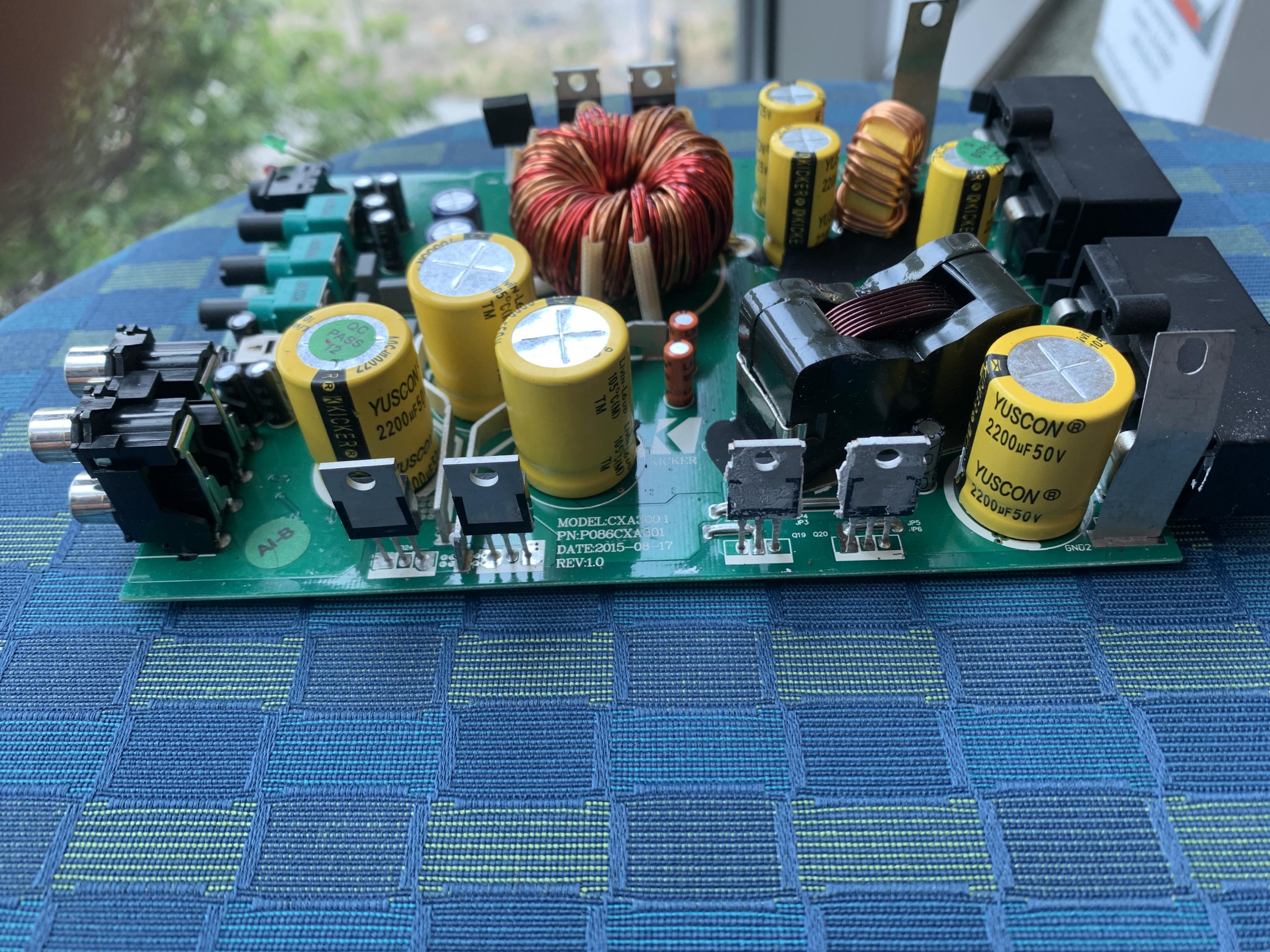

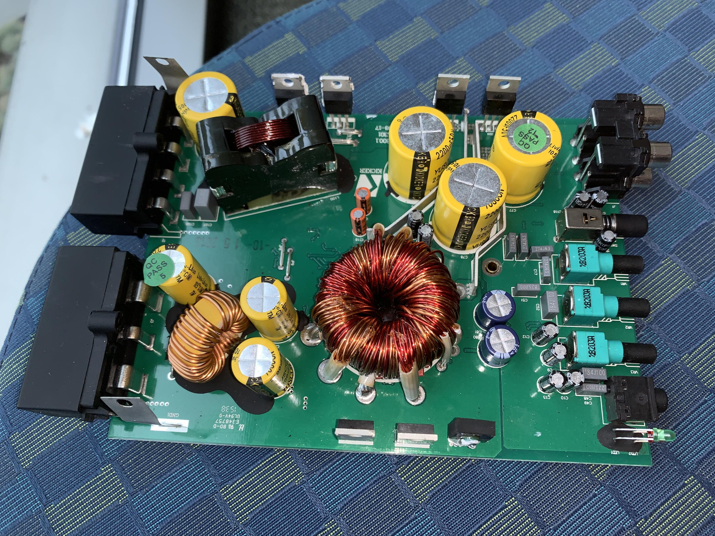

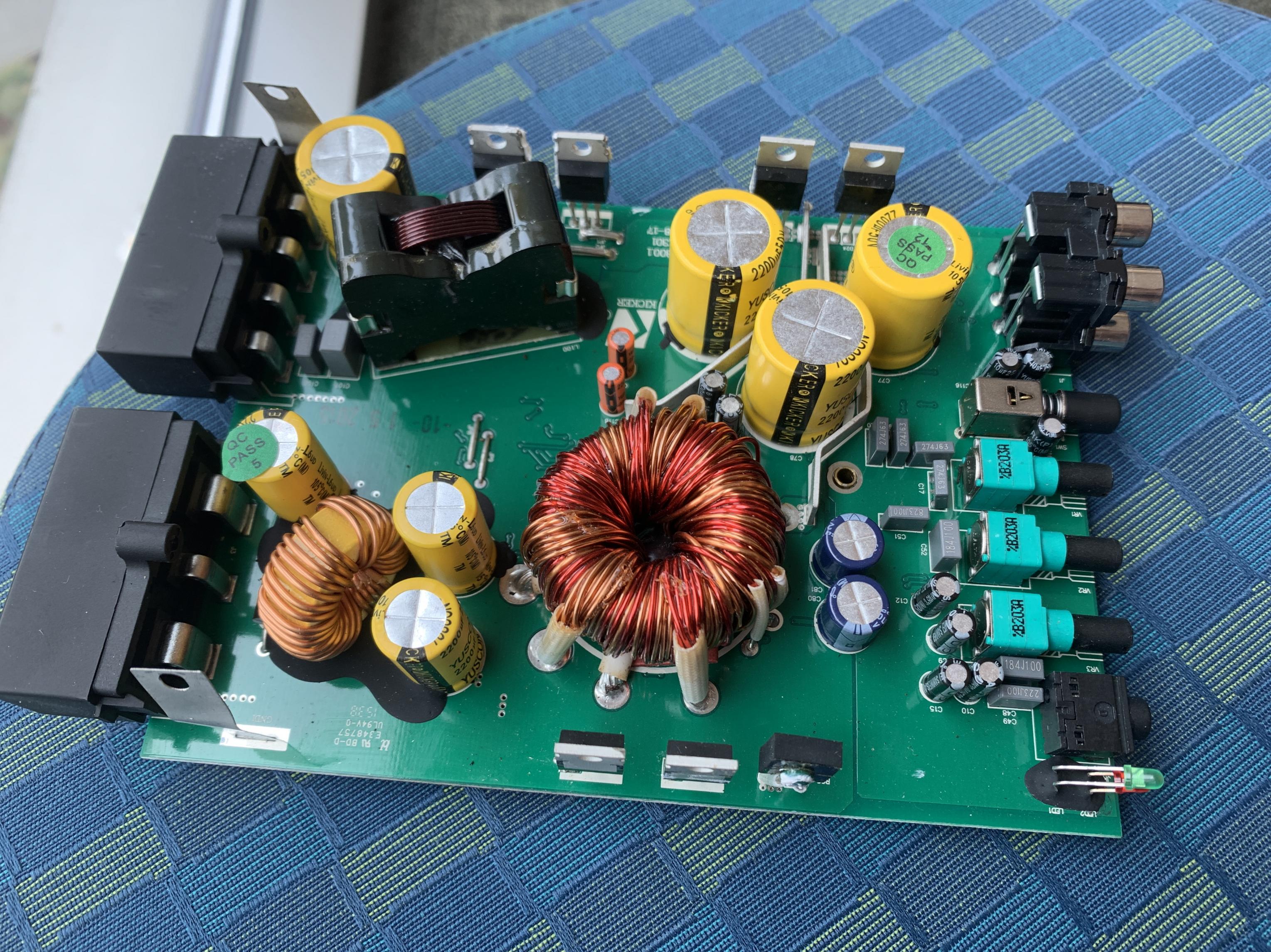

Dead CXA300.1
I was dumb and swapped the 12V+ and GND in a hurry to go out to eat on Mothers Day. I dont see anything instantly that jumps out maybe someone can see something. I get no lights or sound when connected properly now.
Thank you in advance.

While you have the mosfets pulled you will want to check the driver IC3-18021. If the mosfets are blown most likely the driver is also. Post the Ohmmeter measurements, Black probe to power ground. Check both the IC3 and IC2-TL494 on all pins and list as follows:

Based on the readings the IC's appear to be good. I was mainly concerned with IC3 and Pins 3 & 8. I'm assuming that pin 8 is 19kohm(Pin 3-19.3Kohm) and not 19ohms. If it is that low then the 18021 is shorted internally.
If Pin 8 is 19Kohm then check R105-4.7ohms. This resistor may have burned and the value has increased, if so you will need to replace the 18021 and mosfets as well,
If R105 is in value the next step will to be measure the DC voltages around the IC3 and IC2, again using power ground for the black probe.You will won't to leave the AOT460's out, and remove R68-4.7Kohm. This is the sense resistor for the shutdown circuit. Use Perry's instructions I've quoted below. With no power supply mosfets you shouldn't have an issue.Use common sense and be prepared to shut down the power if necessary. Post your readings as you did before.
