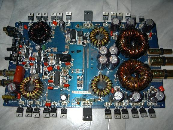

hello i have a earthquake powerhouse d2, its a 2kw @ 2ohm sub amp class d
and it smoked up, cooking one of the output filter inductors, no speakers were hooked up to it at the time and it did not short circuit. i tryed replacing the inductor with a simular homemade one (same size wire, same amount of turns, same core)
no go still, draws large amounts of current. overloads my 12v 40A switchmode test supply with nothing hooked up to it
any ideas? some of the chip descriptions have been scrubbed, think it uses a hip4080 .....
any ideas?
also any basic simple schematics around for class d amps?

You can nearly be sure that at least one leg of the SMPS is blown. This would explain the massive supply current with no load hooked up. Just measure the power FETs - they will show nearly 0 ohms (drain to source) if broken. If so, replace the whole leg, even if there is only one of them blown, with transistors out of one production lot.
HIP 4080/81 tend to burn too, I would not switch the unit on without replacing the driver chip.
thanks for your help in all this, but i asked a teacher that teaches electronics and he said to just try som,e simple stuff like you said, i did and it seemed ok, so i thought id power it back up again, and well it works!!!!!!
i dunno how, i didnt do anything! but running off my 40A switchmode it polled my 2 250wrms 12 subs like it was NOTHING and overloaded my switchmode! (lucky i have 4 of them so i can parallel them up)

just not sure about the inductor id put in, cus it gets warmer than the other one next to it, its suppost to be the same.... i tryed!
but it works now and i sure am happy!
thanks for your help!
