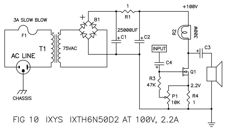

Improved De-Lite schematic
R4 is the 3W resistor I mentioned above.

If you are literally building the circuit posted at the beginning of this thread,
then you are missing some elements. This was a simplified intermediate
schematic for tutorial purposes. You want to be sure that your circuit
corresponds to the more finished version.
I have used this schematic.
small difference ;
so - either this (Fig.10) or Fig.7

In the light of Nelson's comments I would like to know if the schematic in FIG 5 (The Improved Circuit) makes a proper working amplifier :-
Please Mr Pass, don't leave me in the lurch😉
