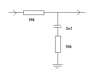

You need a pole/zero at 75 and 50us
10k in series with tuner to preamp (includes output impedance)

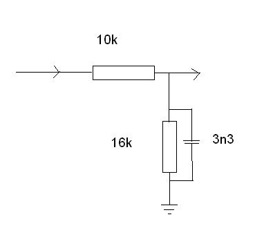

16k in series with 3n3 from amp input to ground assuming 47k I/P
Is this any use ?

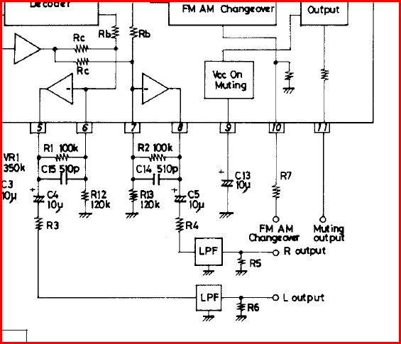

the stereo decoder inside is Sanyo LA3401, which is pretty common and the datasheet is available

For the LA3401 it's the caps marked C14 and 15 here.
Adding a 220pf across each would give 73us... pretty close, or you could take them out and replace with 750 pf.
You could always alter the resistors R1 and R2 as well, at the expense of greater output. 150k would give 76us.
You would have to try that one to make sure there was sufficient headroom for the higher output level.

done!
it was easy to locate the parts
I ended up soldering it to the caps directly since turning the pcb would be hard
thanks for the help

The 3n3 should be in series with 16k, not in parallel as Adason drew
But I think that changing the internal time constant is a much better solution as there are no dependancies on input and output impedances
