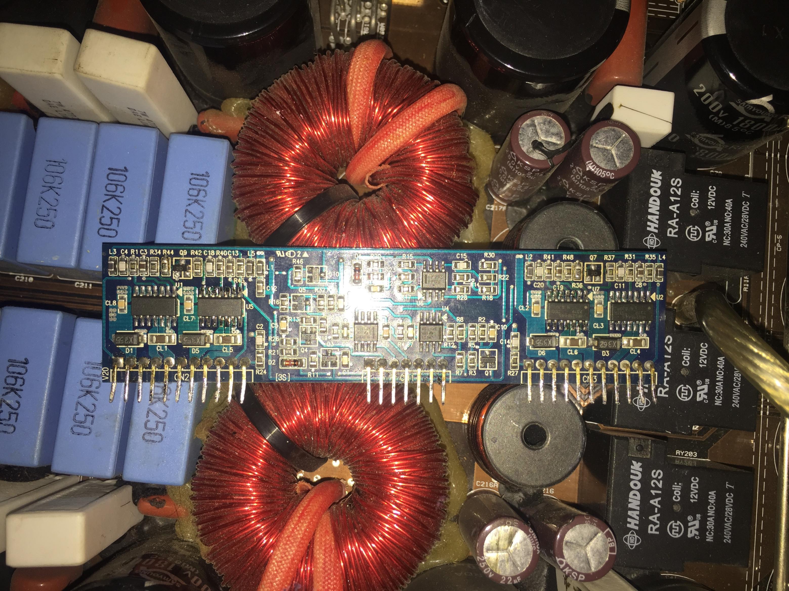

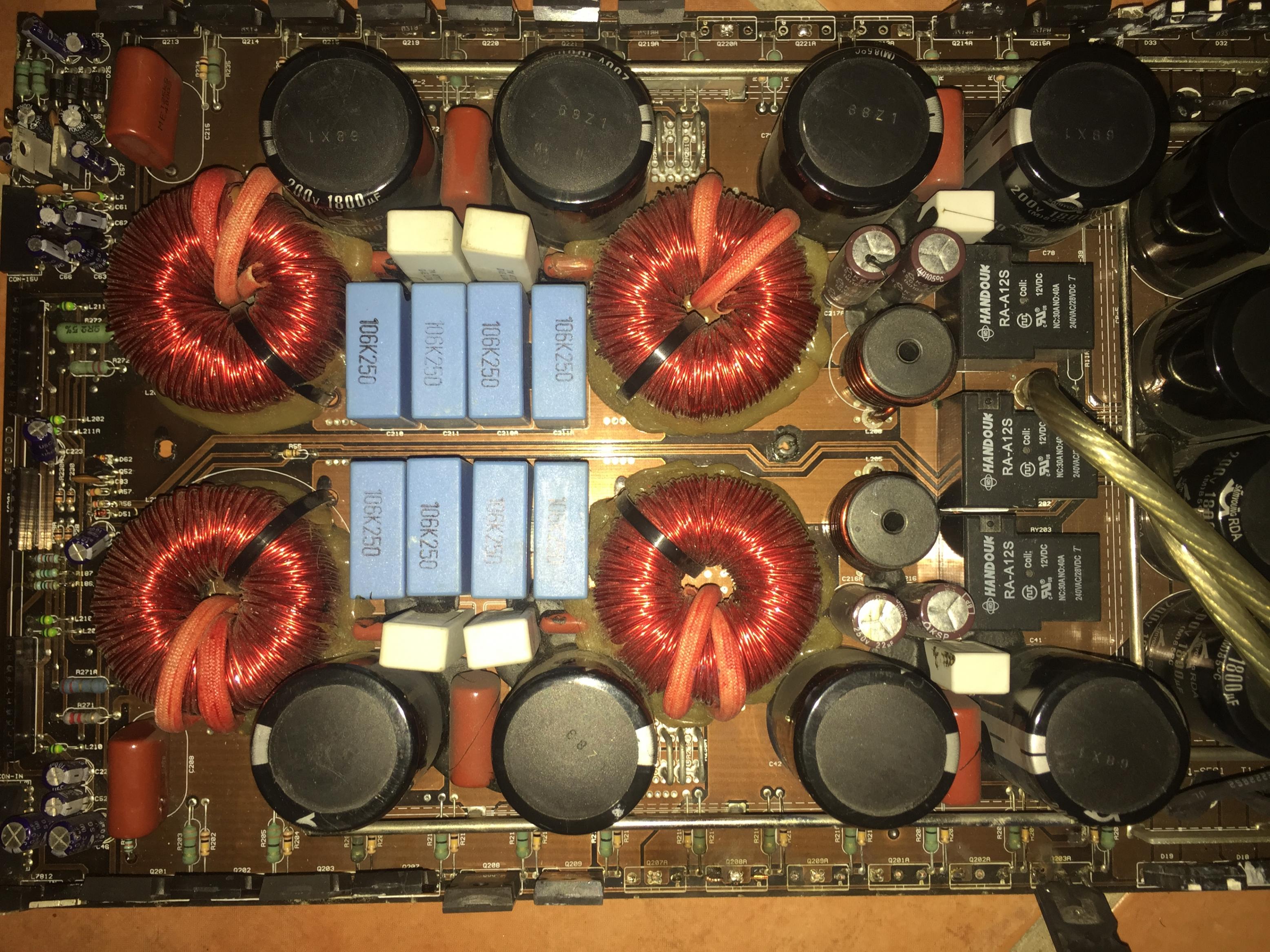

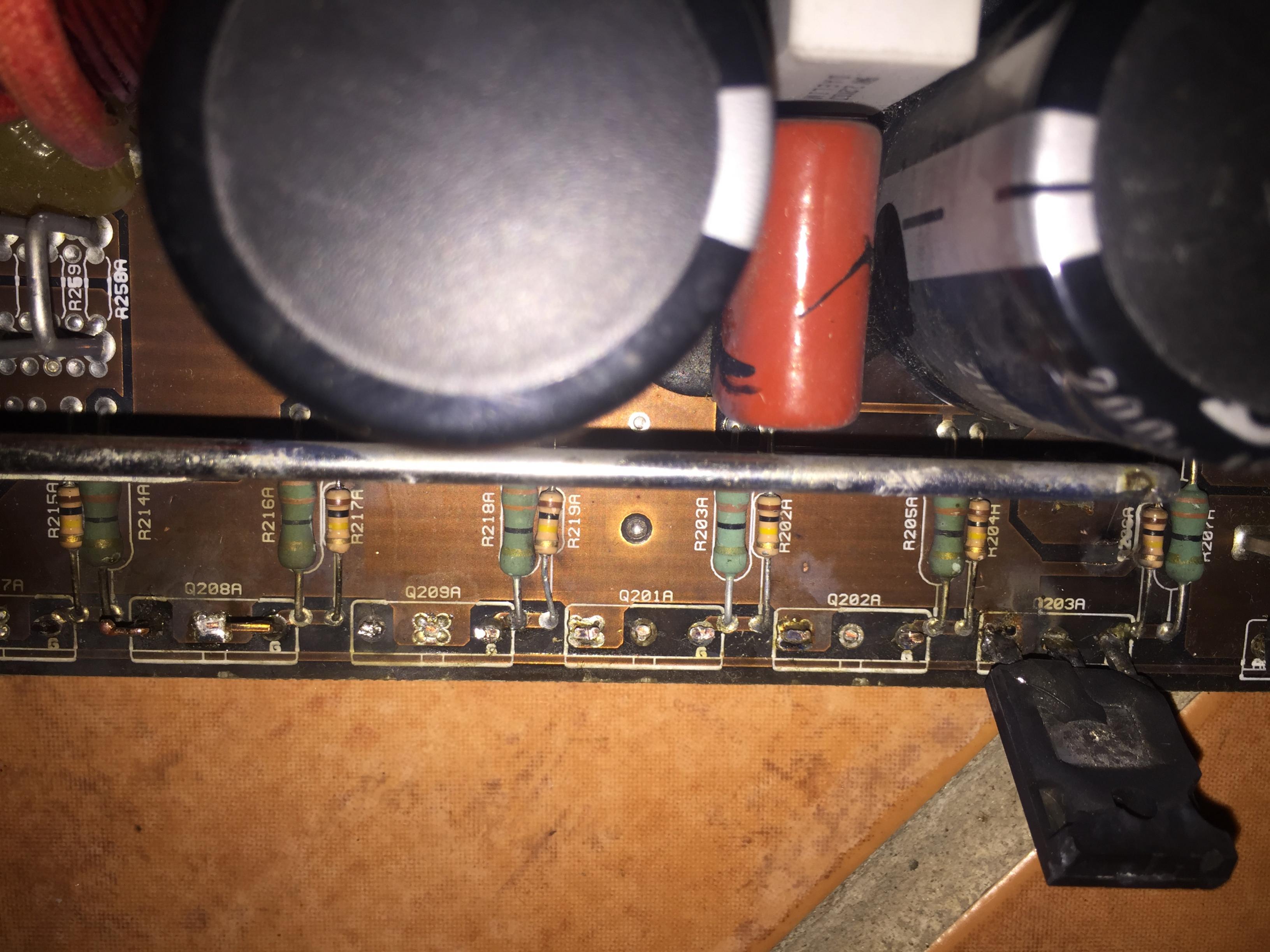

Hi. I am repairing a DD Z2, which exploits the output transistors. only the 6 transistors left part near rectifier diode.
I have checked the output drive board and all good, replaced IR21844S as a precaution, but when connecting a speaker to the output, it explodes again the 6 transistors that I said previously.
What can happen?

Does this one use the two-21844 driver board?
If you did not connect a speaker, did the amp produce an audio signal at the speaker terminals?
the drive board, has 4 units of 21844s. it did not emit any sound, only the transistors exploded.

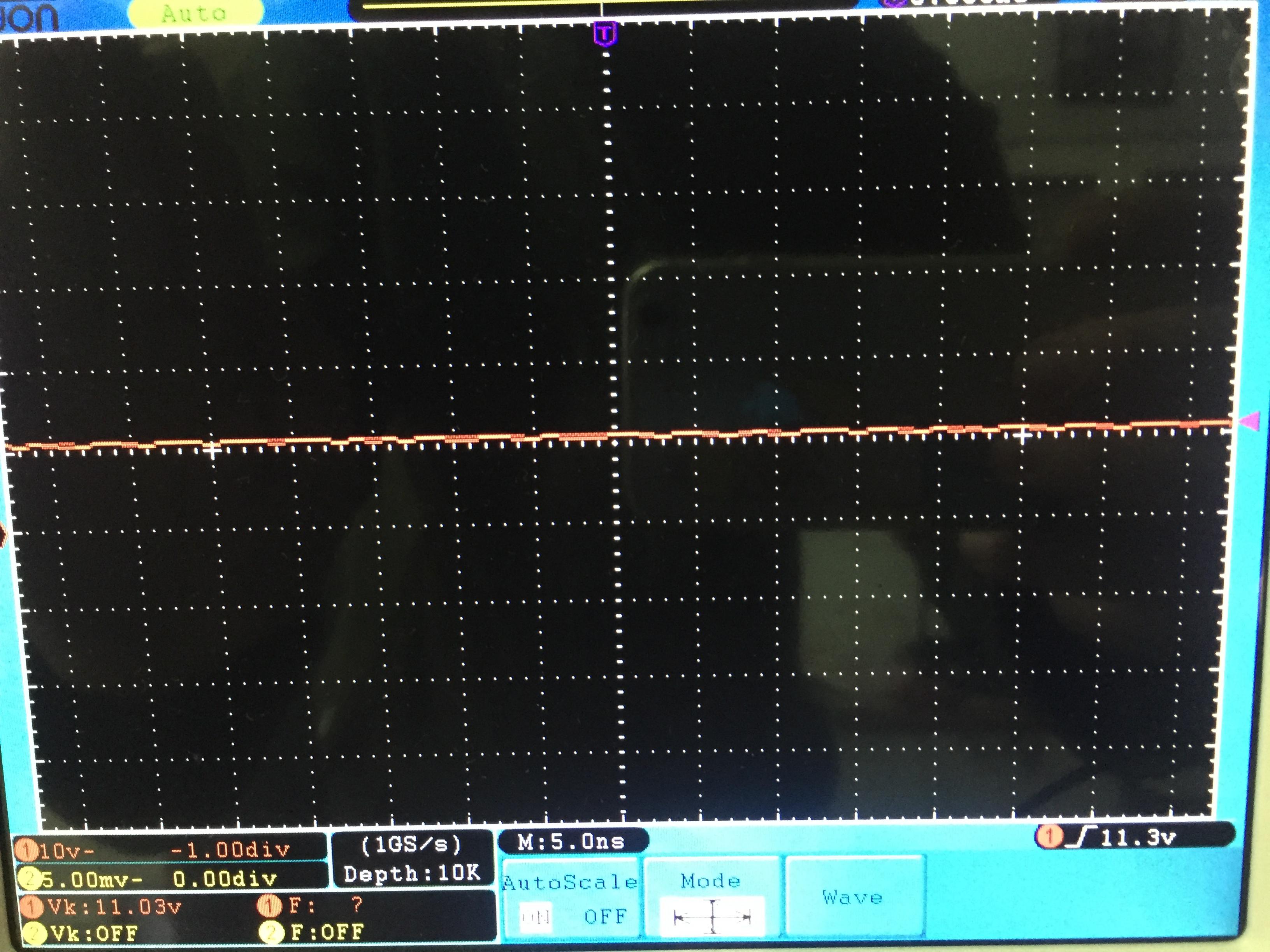

After replacing the 21844 driver ICs, did you check the drive signals up to the gates of the FETs?
I could not measure the drive signal to the gates. How can I check the drive signal without having the output transistors installed on the board?.

Are all of the 2.2 ohm resistors within tolerance? R272A(?) looks like it got really hot.

You can pull the rectifiers and drive a strong signal into the amp (50-100Hz) and see if you get a good clean square wave at every FET gate leg.

I have solved the problem.
The problem was a resistance of 2.2 ohm 1W out of value.

Remove the rectifiers and install the output transistors. Without rail voltage, they can't be easily damaged. Replace all known defective components (including any failed 21844s) and drive a sine wave of 50-100Hz into the amp. Check the signals on the gates of the output FETs. Having the FETs in the circuit loads the drive circuit and helps show any deficiencies.
You'll have to provide the high-side of the IC with a supply (9v battery works).
When you post a waveform, you want the vertical amp set to show the waveform to span 3/4 of the display (from the reference line). You want the timebase set so you have 3-4 complete cycles.
