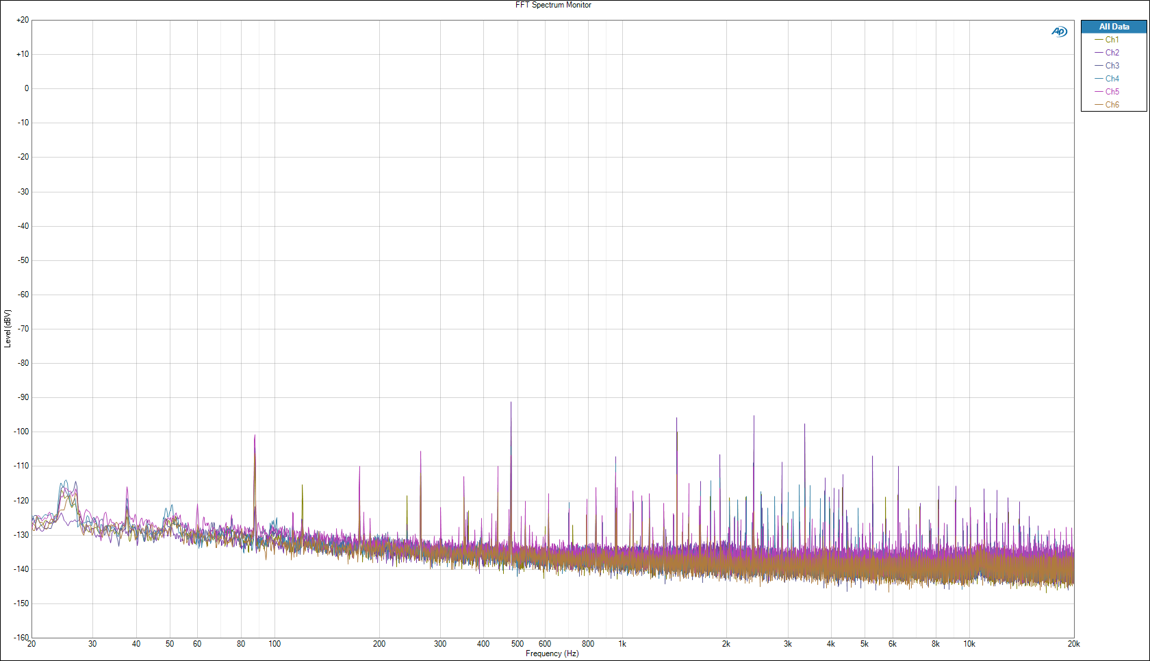

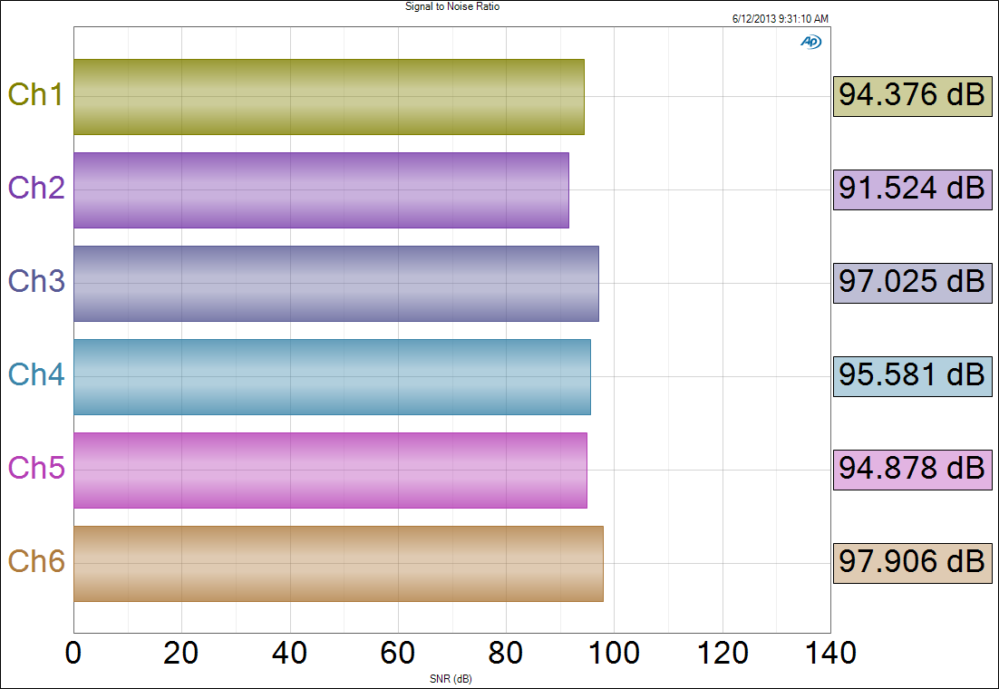

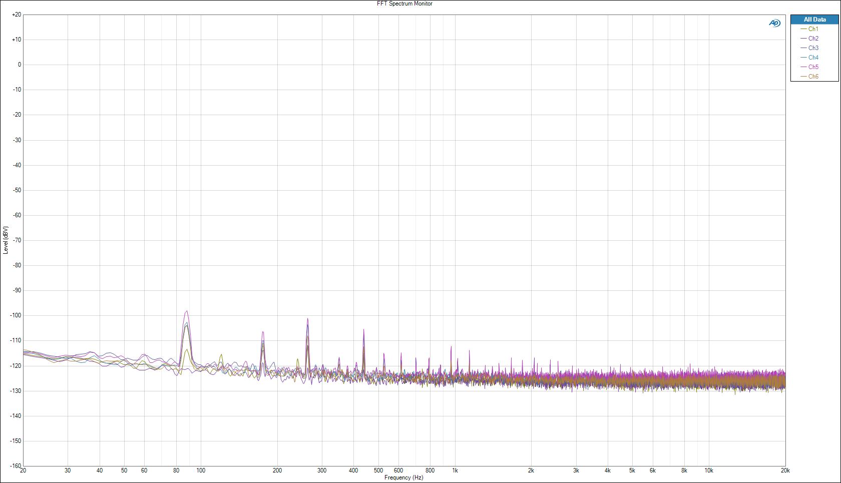

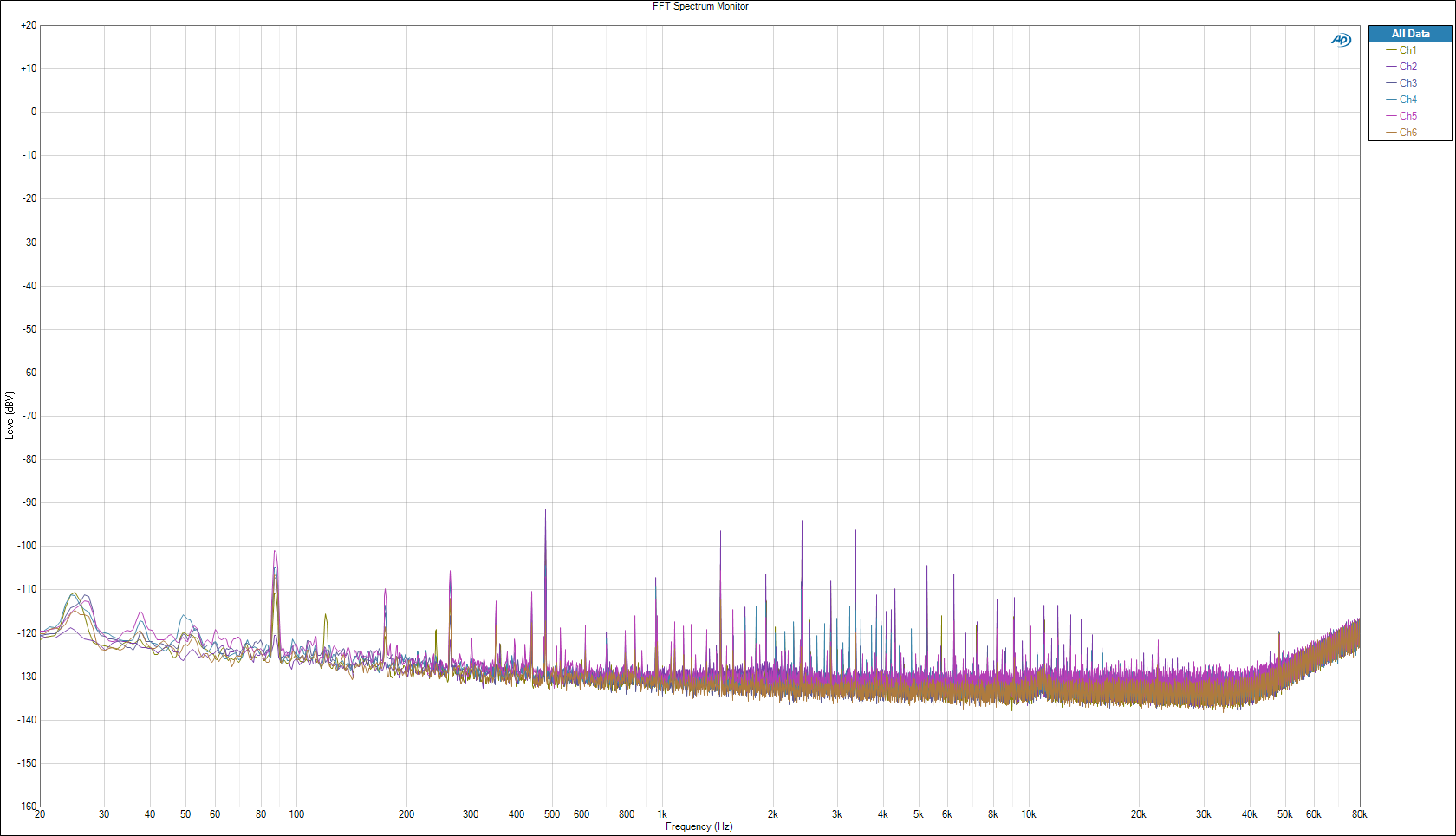

Alright... on to the measurements!

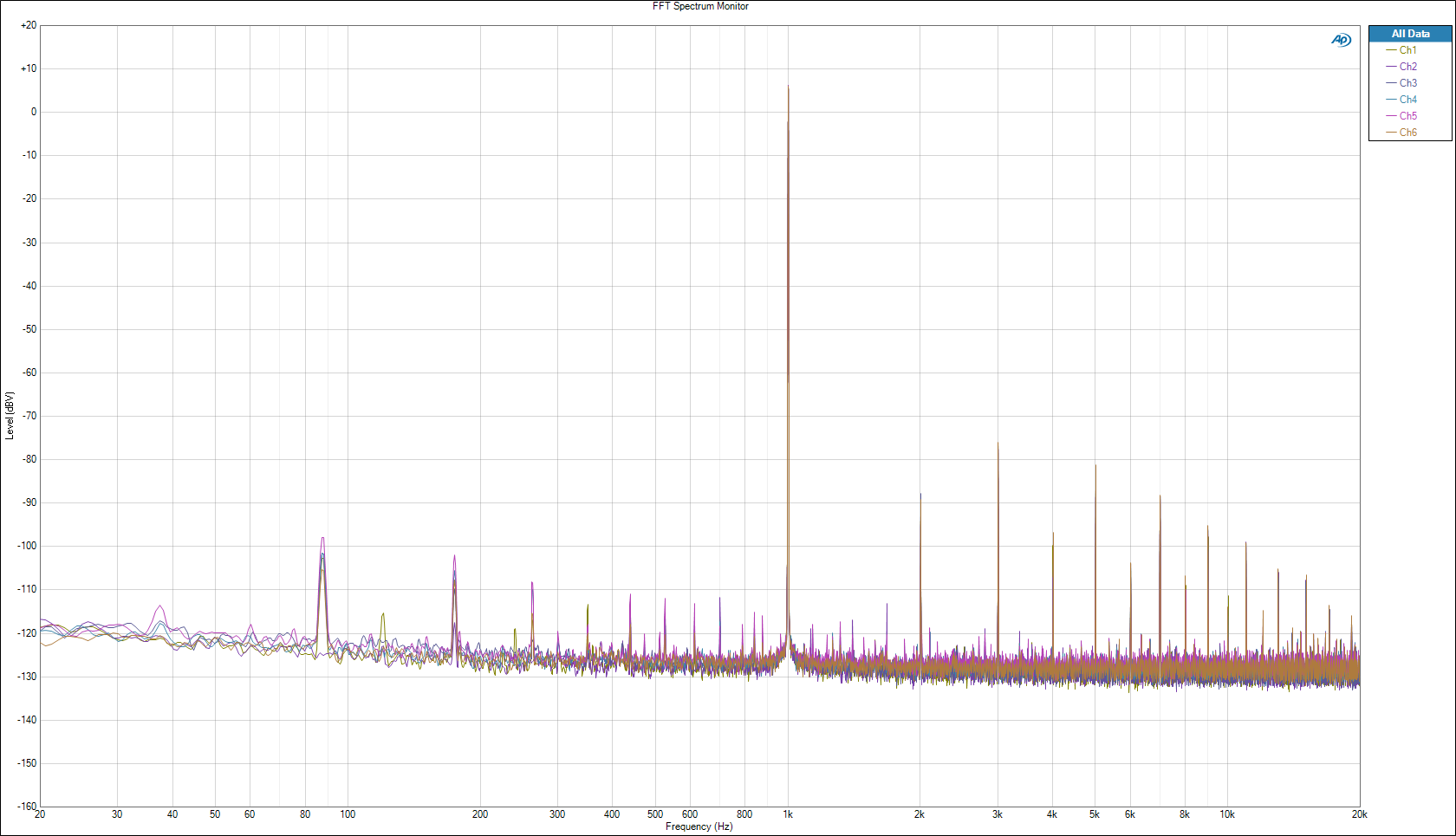

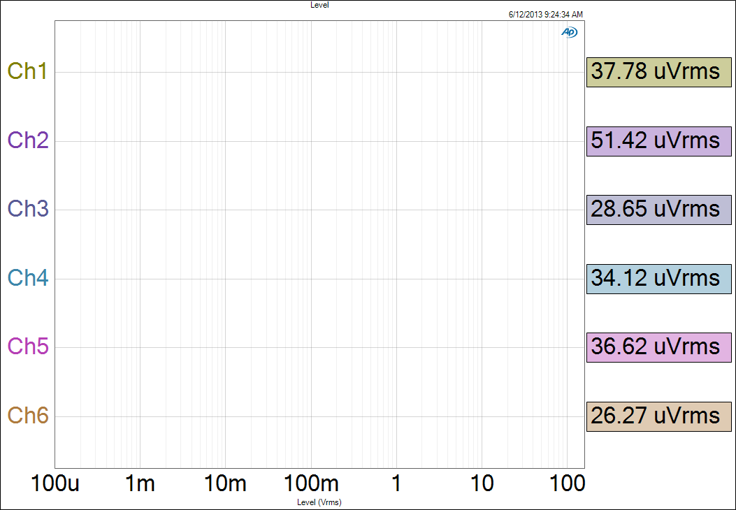

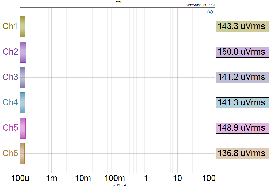

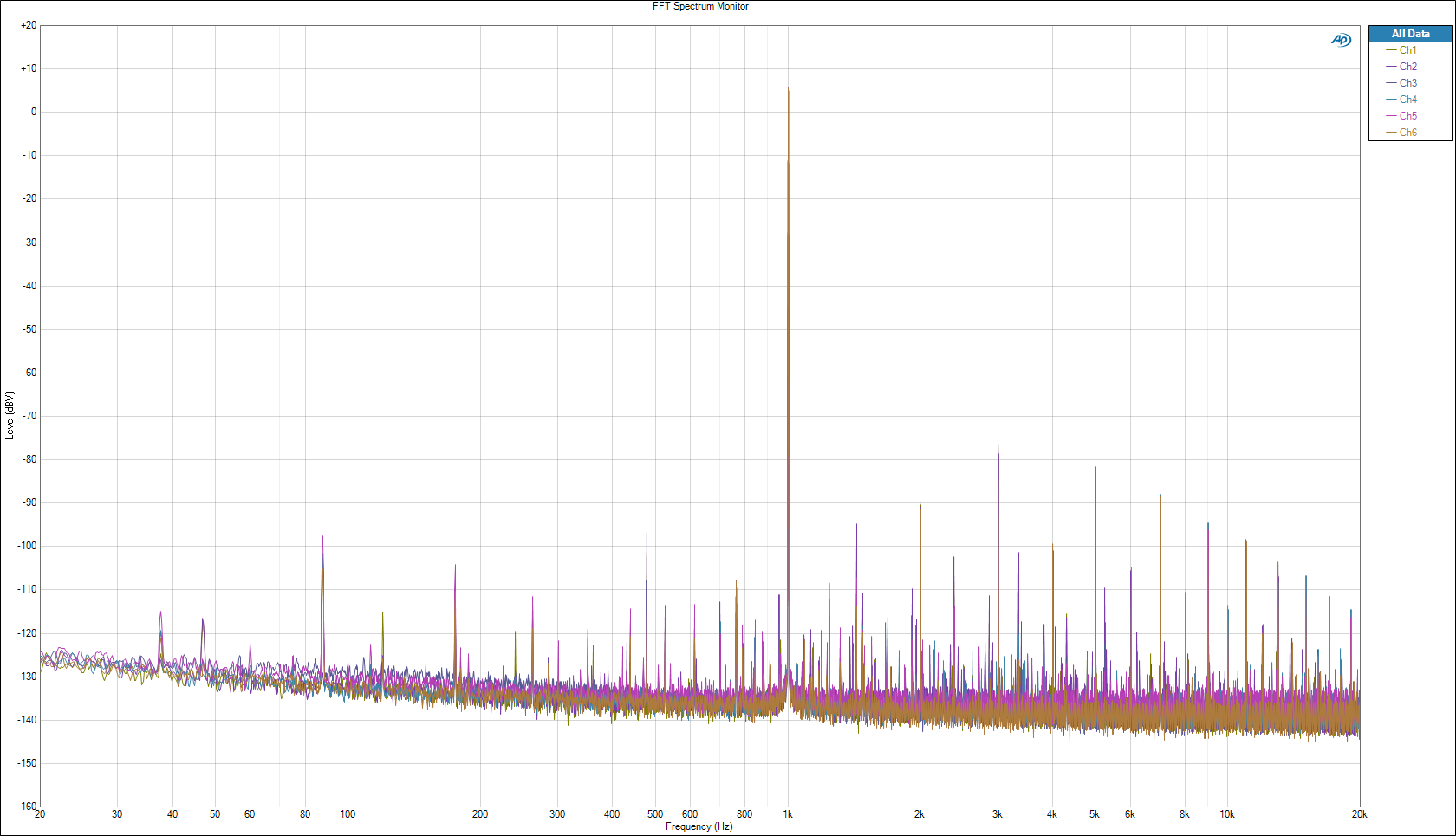

Let's start with the noise floor of the outputs. I set all 6 channels to bypass the crossovers, set the gain in each channel and the inputs to be 0dB, and measured with both analog inputs and AES/EBU.
Measurements 1 and 2 show the noise floor with analog input, and with AES/EBU respectively. As I had thought, the noise floor is significantly worse using digital input than it is using the analog inputs. My best guess is that the AES/EBU signal is polluting the analog outputs since they all run together on the same un-shielded ribbon cable. The only other possible culprit is the CS8420 which is present on the digital input but not on the ADCs. I doubt this is the source of the noise, however, since that level of noise is significantly worse than what's specified in the datasheet for the CS8420.
The remaining noise present in both the digital and analog input setups is almost certainly lower harmonics from the SMPS switching frequency.
There are large spikes present at 88Hz, 180Hz, 270Hz, 440Hz etc... which are not related to normal linear line rectified supplies. This noise is clearly present right up into the 1-3kHz region.
Based on the above, it looks like a great deal of the noise could be reduced by doing the following:
1. Wire the AES/EBU input directly from a dedicated input connector to the isolation transformer on the digital board using a shielded TP cable.
2. Remove the questionable SMPS and replace it with a fully linear supply using toroidal transformers and ultra-low noise regulators for all rails.

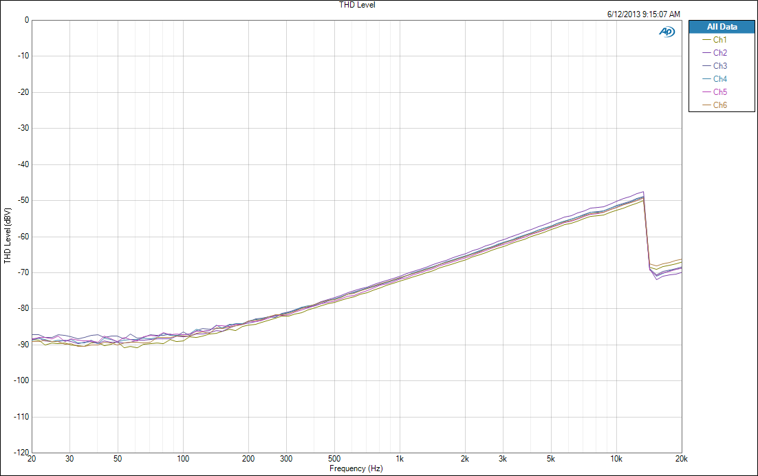

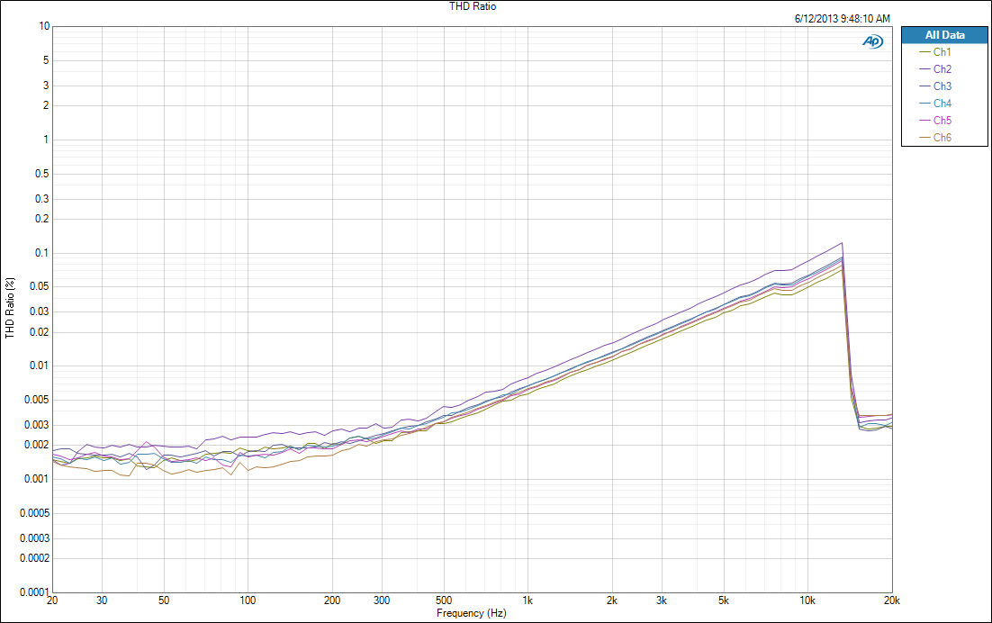

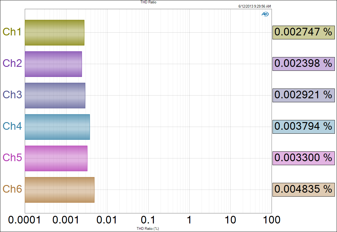

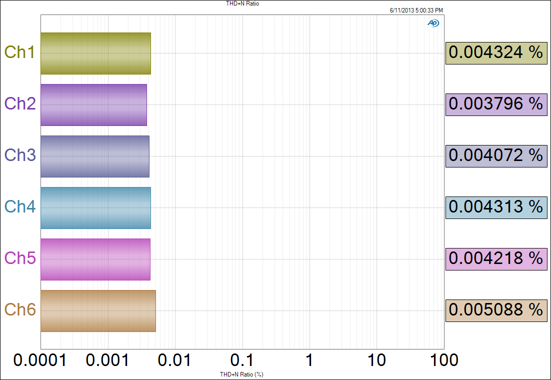

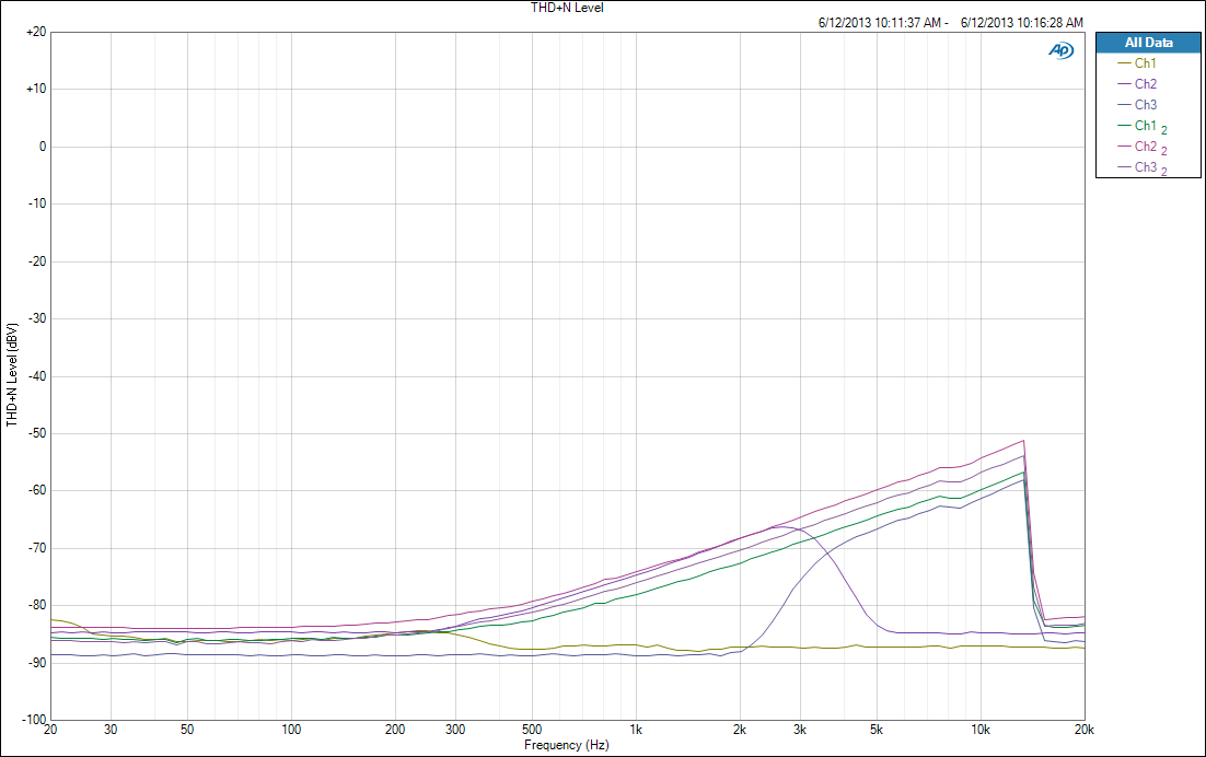

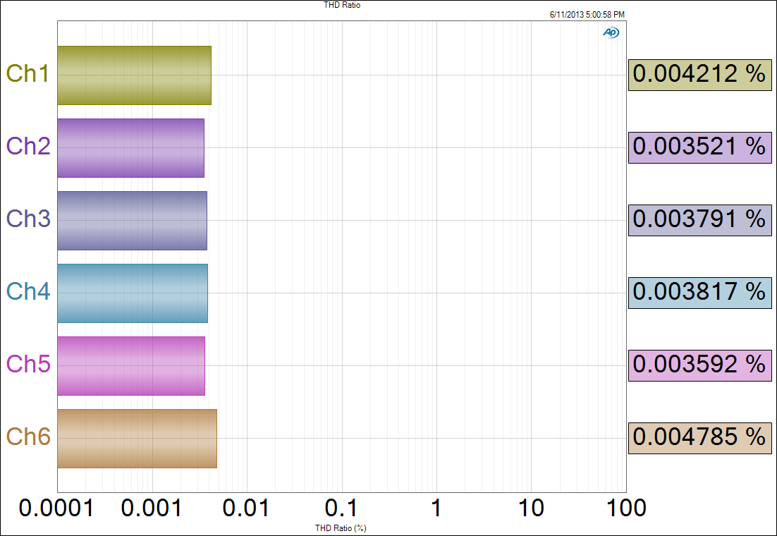

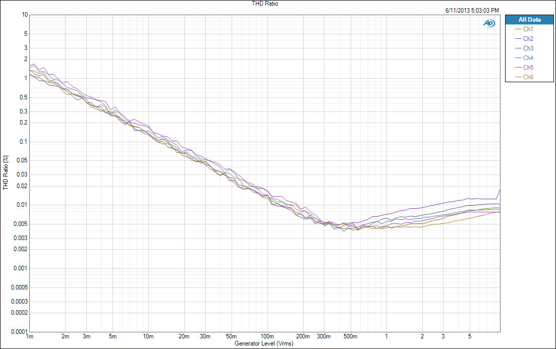

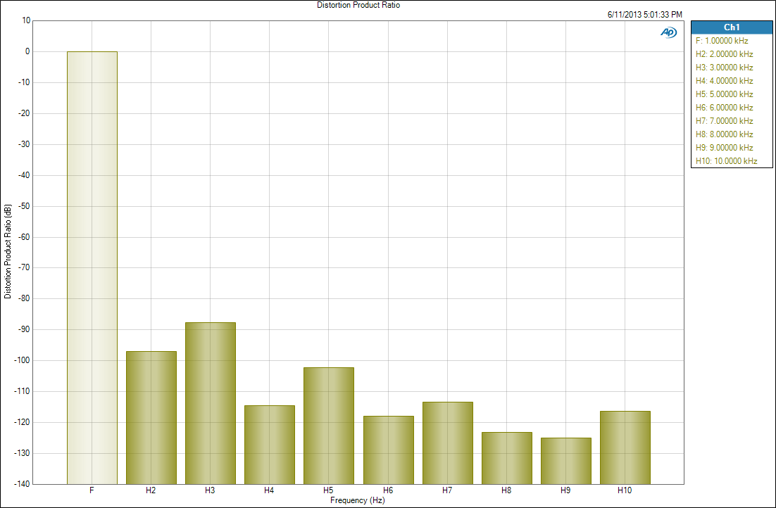

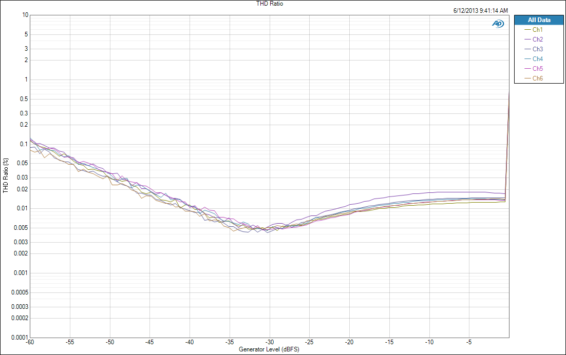

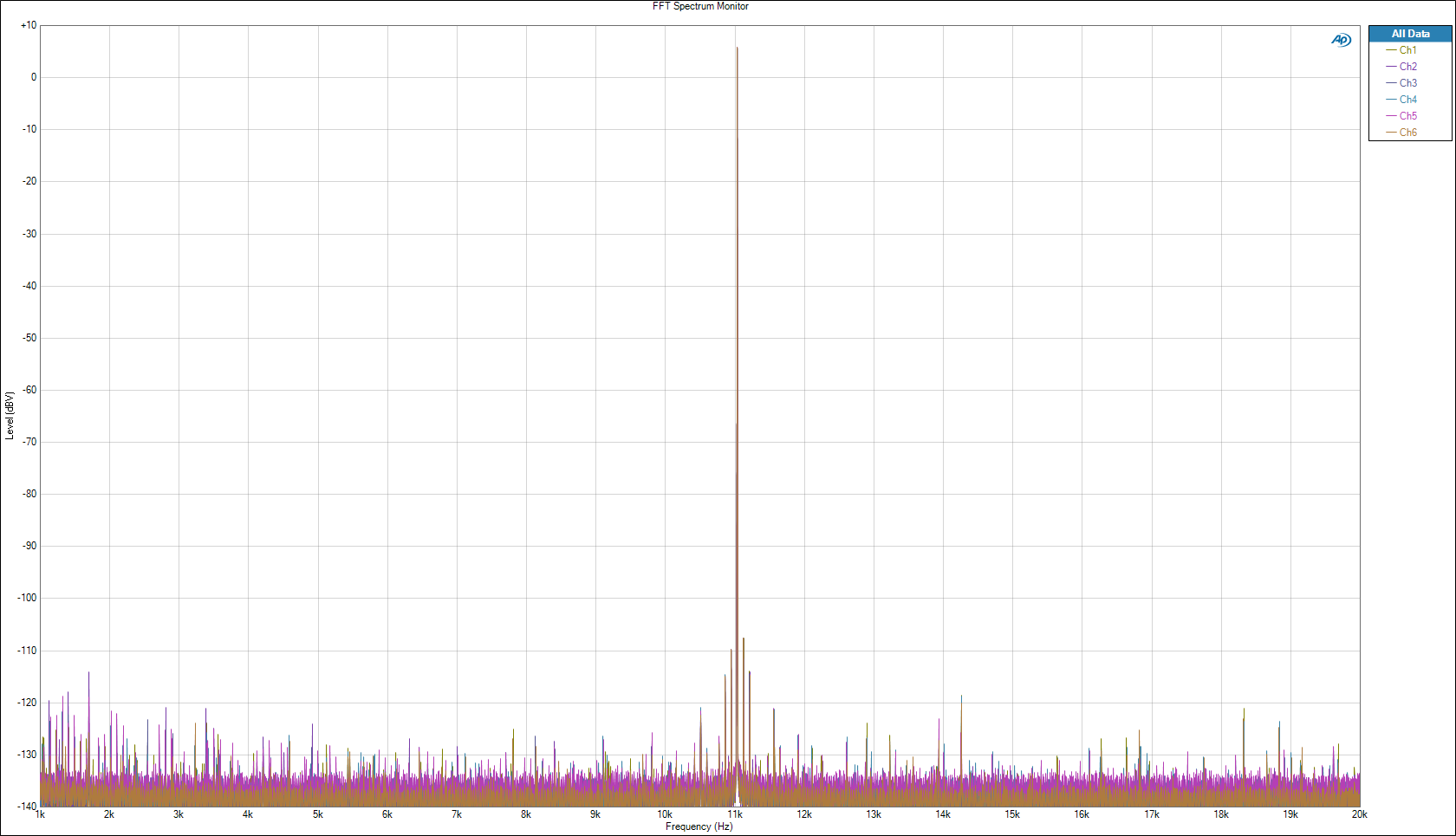

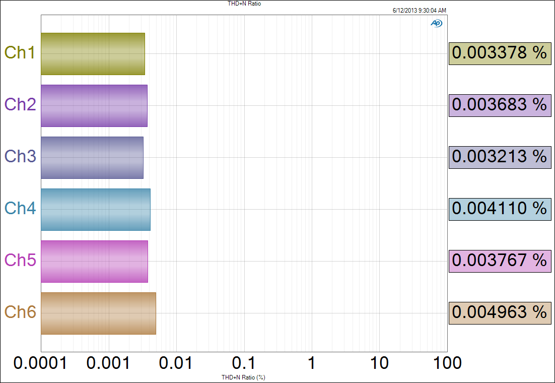

Next up is THD and THD+N. The last 8 measurements show THD and THD+N on the outputs using both analog and digital inputs.
Overall, distortion is reasonable at 1kHz, but it still falls short of the spec for the DAC which would imply that the limitation is the output stage design. Distortion also climbs to rather high levels at higher frequencies which, although probably not audible, points towards an output stage that isn't all that well designed.
These measurements are as follows:
3. Digital Input - THD @ 1kHz
4. Digital Input - THD+N @ 1kHz
5. Digital Input - FFT 1kHz, 2VRMS
6. Digital Input - THD VS FR 2VRMS
7. Analog Input - THD @ 1kHz
8. Analog Input - THD+N @ 1kHz
9. Analog Input - FFT 1kHz, 2VRMS
10. Analog Input - THD VS FR 2VRMS
Based on the above, it's probably best to redo the output stage to maximize the performance to at least the same level as what the DAC is capable of. It's a shame to have the analog output stage being the bottleneck when it doesn't cost much to do it right!

I went passive on the output (adaption of Jan's circuit)- ended any issues with noise or gain, and (talking out of my rear because I don't have solid ears-only data) I think it sounds better. Certainly a lot of measured distortion artifacts at treble frequencies went away. No remote, but I didn't spend what his remote-controlled board costs! 😀
I would imagine the significantly lower gain (almost 21dB less!) would certainly help reduce the output noise, but given the poor PSRR of the DAC itself (50dB), I think the 5VA rail for the DAC would also have to be looked at to address the noise from the PSU.
The DAC itself also has a rather low differential output of 0.85VRMS at 0dBFS, so I think I would opt for a single OPA1632 per channel with a gain of 2.4 to get the differential output up to 2VRMS and the SE output up to 1VRMS.
Are you using balanced or SE outputs? If you're using SE then you're giving up the CMRR needed to maximize the DAC performance and you're only getting 0.425VRMS at 0dBFS 😱
I think a well executed output stage would still be beneficial compared to just running straight out of the DAC, although running straight out of the DAC is almost certainly better than running it stock 🙂
Owen
Balanced. I'm a big advocate of that. See Jan's article on the passive RC mod. Noise floor on my unit is down below -100dBV. Some people are dropping in output transformers, which also work well, but (IMO) not any better and perhaps not as well as a dollar's worth of R and C.

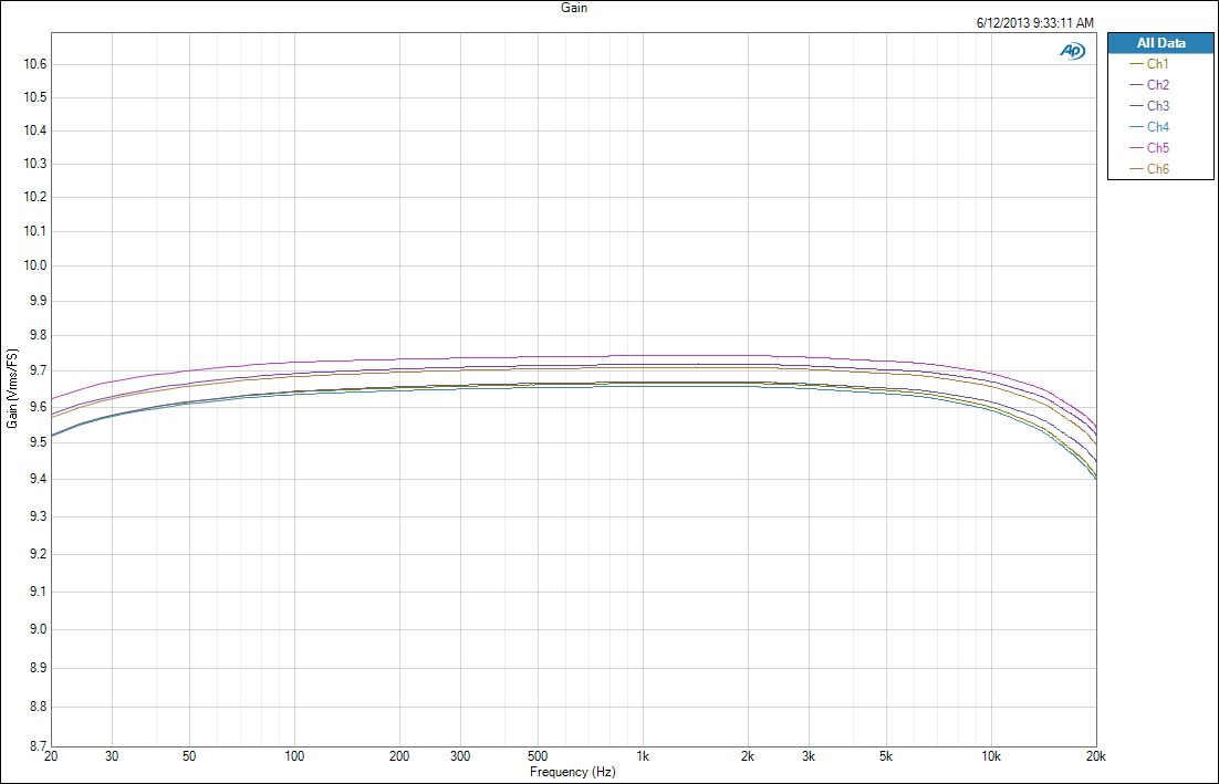

Next up is frequency response...

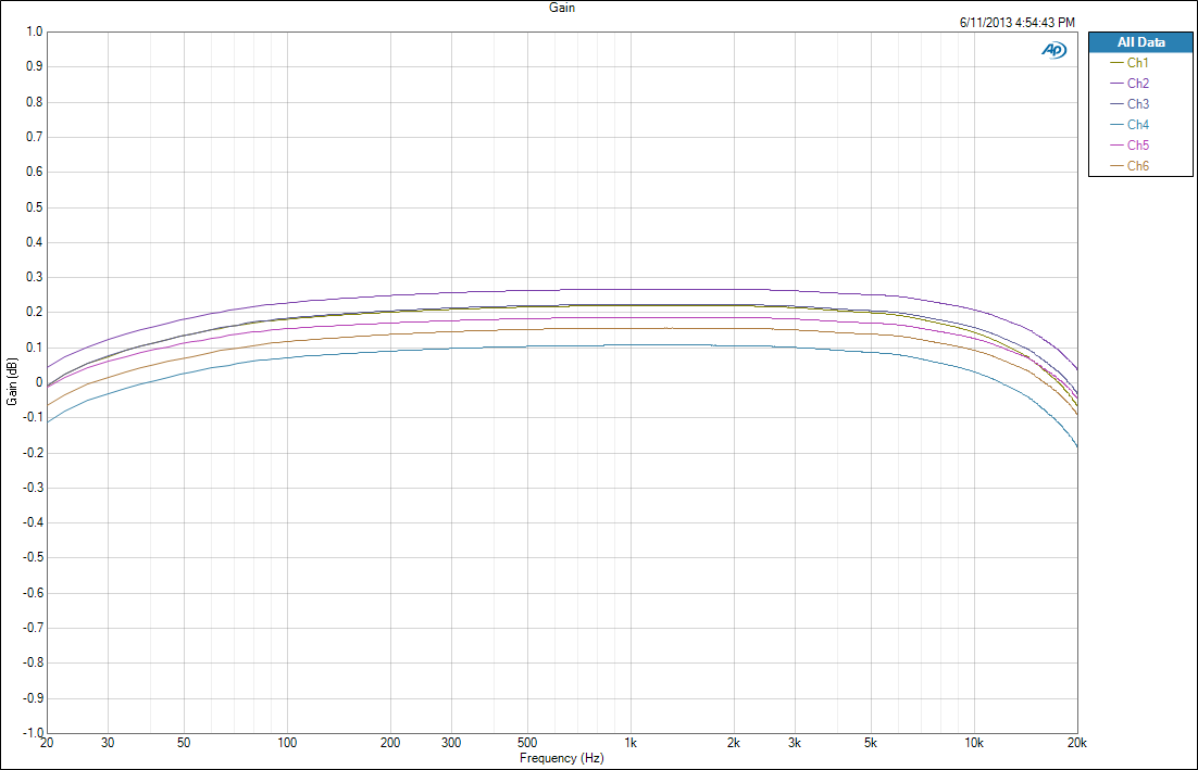

Everything here looks pretty good, and inter-channel gain matching is actually much better than I was expecting.
Using the digital input, all six channels are within 0.1dB of each other which is quite good. Each respective channel is down about 0.13dB at 20Hz and 0.2dB at 20kHz.
Using the analog inputs pushes the channel matching a little broader, but still within 0.2dB which is pretty good. Each respective channel in this case is down about 0.2dB at both 20Hz and 20kHz.
Overall, no problems with the FR. I still prefer DC coupled outputs, but there are no serious red flags here, and certainly nothing to explain the poor high frequency performance!
1. FR and Inter-channel matching with Digital input
2. FR and Inter-channel matching with Analog input

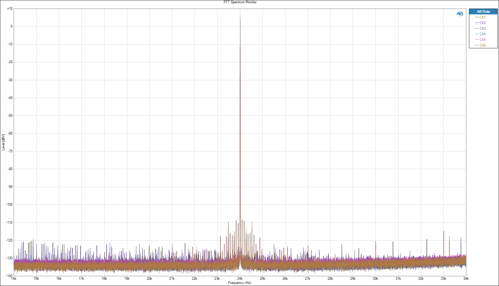

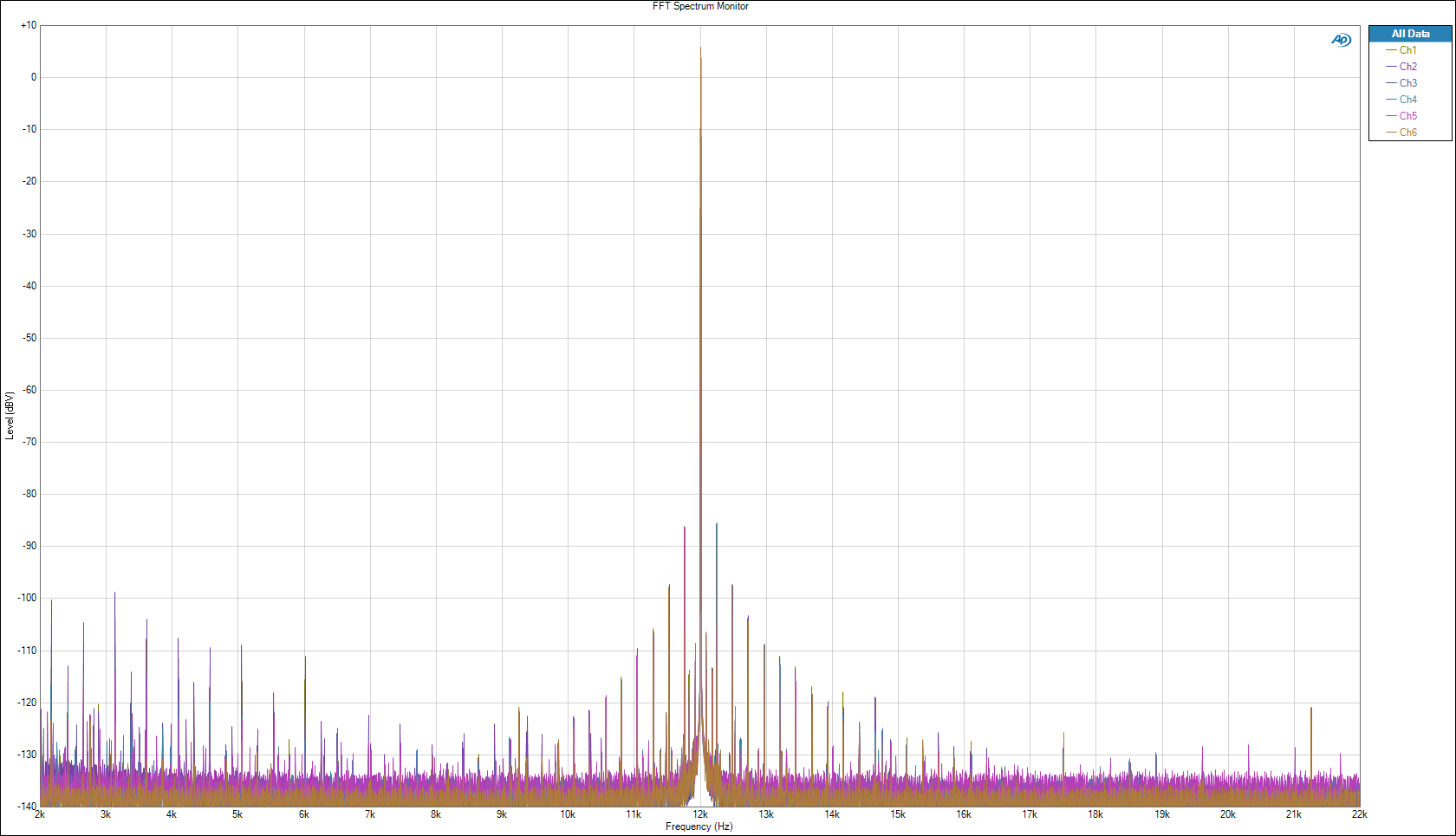

So we've covered most of the basics... noise, distortion, frequency response, and we still don't have an explanation for the dull sound and the poor high frequency performance. After performing all the above measurements, I figured it would be best to see if I could get some meaningful jitter measurements from a system level to see if maybe that was the culprit.
It turns out this thing happens to have by far the worst jitter artifacts I have ever seen in anything I've ever measured. I can't be sure until I fix it, but I think this might have to something to do with the less than desirable sound.
3. Jitter Artifacts - Digital input at 44.1kHz
4. Jitter Artifacts - Digital input at 48kHz
5. Jitter Artifacts - Digital input at 96kHz
6. Jitter Artifacts - Analog input at 96kHz
Unfortunately I can only measure for artifacts at 96kHz using the analog input because that's the only frequency it operates at. I was able to measure at each of the common frequencies for the digital input.
Overall, this is very poor performance. As a reference, the NTD1 and the ESS9018 in the same measurement setup only have two tiny artifacts at -155dBr. The DCX produces a plethora of artifacts, some at a whopping -86dBr which is higher than most of the distortion harmonics!
Interestingly, the issue is mostly confined to the digital input, which tells me it probably has something to do with the CS8420. The fact that it gets worse as we approach a 1:1 ration also hints at this.
This issue definitely needs to be addressed, either through the use of a better ASRC, or possibly a better clock, although the more reasonable jitter levels on the analog input side would imply that the existing clock isn't really to blame.
I was really hoping not to have to alter the digital board, but it looks like that might not be an option.
More to come!

Alright... this is the last of the measurements for the stock unit that I wanted to get posted. These are mostly a mishmash of things I measured while I had everything set up.
1. SNR @ 2VRMS output, 20kHz BW
- I wanted to measure this to get an idea of what the baseline SNR is with a 2VRMS output. This is more in-line with what most hifi users will actually be getting from the unit since most people can't make use of the 10VRMS output. As expected, it's not great and ranges anywhere from 91dB to 98dB.
2. Distortion Product Ratio - 1kHz 2VRMS
- This just makes it easy to see the distortion signature of the stock output stage. It has a dominant 3rd harmonic that is about 88dB down, and a second harmonic that is about 97dB down.
3. FFT of Noise Floor - Full Band 20Hz to 80kHz
- I wanted to see if there was anything particularly nasty a little farther out, but everything looks alright here. The noise floor starts to climb after 40kHz, but nothing too scary.
4. Output noise level - 20kHz BW
- Self explanatory
5. Output noise level - 90kHz BW
- Self explanatory
6. THD VS FR with XO on and off.
- I wanted to make sure that enabling the crossovers didn't impact distortion. Thankfully, there is no increase in distortion levels with the filters on or off. This is very good news, as it indicates that the DSP section itself is not contributing to distortion.
7. THD VS Level - Analog Input
- Self explanatory
8. THD VS Level - Digital Input
- Self explanatory
Next up - a plan on how I'd like to address some of the issues found in the measurements, and hopefully a discussion of what people would like to keep in the DCX, and what they can live without.
Owen
- Self explanatory
- Self explanatory
- Self explanatory
- Self explanatory
Owen
