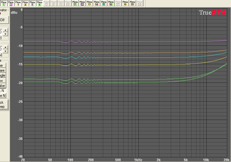

I don't see any problem with those readings. The worst case channel difference is between 2 (.642) and 6 (.587)....that's 20*LOG(.642/.587) equals 0.78db. That does seem a bit worse than expected, but still way less than what you noted previously. (I'll check mine and see if it's similar.)
It's still not clear to me where your problem is.
Why don't you PM me and we can talk further and try to figure it out? Or if you're in the Bremerton area sometime stop by and I can check it for you.
Davey.

So I regrouped this morning and used TrueRTA and the frequency sweep function.
Sound card out to Preamp
Preamp set to 0dB to inputs A or B
DCX zeroed out with on input feeding all outputs
Same output cable used on each output, tested one at at time.
I calibrated with my preamp in the loop as I found that my preamp is -3db @ 20kHz. I'll have to figure out why later.
With the preamp in the loop but calibration only involving the sound card, the sweeps of outputs 5 and 6 match what I saw when I did the same test with pink noise and a mic.
THe attached screenshot is with the preamp response calibrated so this should be a better representation of the DCX's true performance.
Here you can see the vast difference between output levels that I've been fighting.
Again, the same cables were used. I ran the sweep, saved the results and then moved the cable to the next output and repeated.
Yeah, you've got some kind of a problem with your testing setup because those curves don't agree with the numbers you were getting from your DMM.
The frequency response should be ruler flat and there shouldn't be any of that "rippling" between 100-300Hz.
Davey.
Davey.
I ignored the ripple. I was concentrating on the relative difference between the levels and the high end response variations.
However, I wouldn't doubt my test is flawed. However the tests are all done using the same cables and are repeatable.
I just got an RMA number from Behringer so I'll take it the local service center next week and see what comes of it.
Thanks for thelp.
Thanks for thelp.
