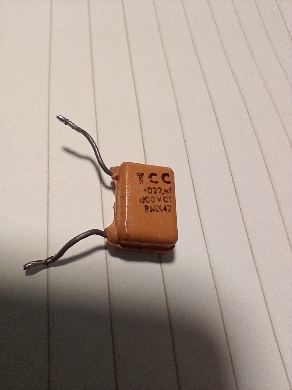

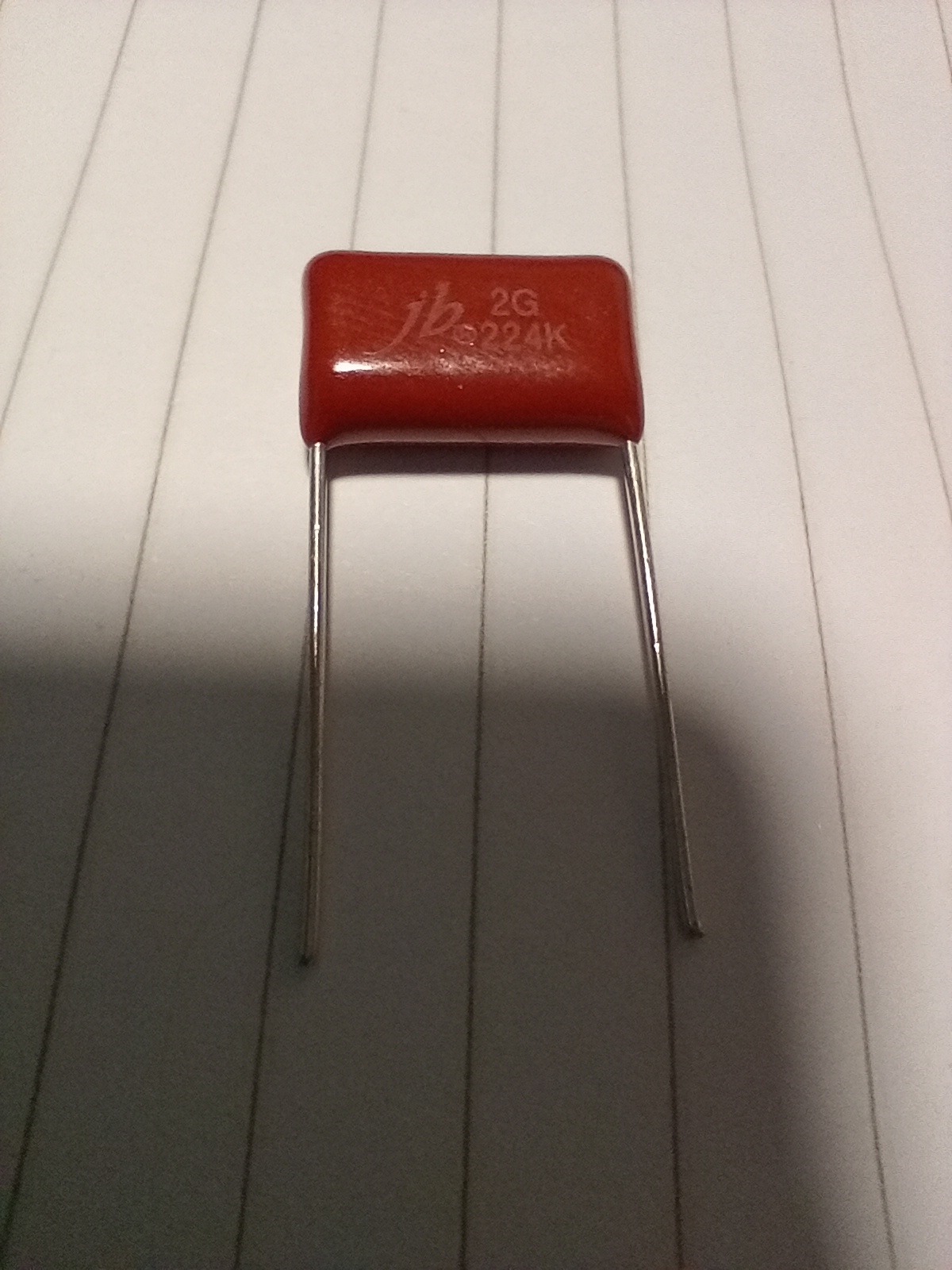

The cap you replaced was a polycarbonate metallized in a thermoset case, normally stable and good quality. Unlikely to cause the problem.

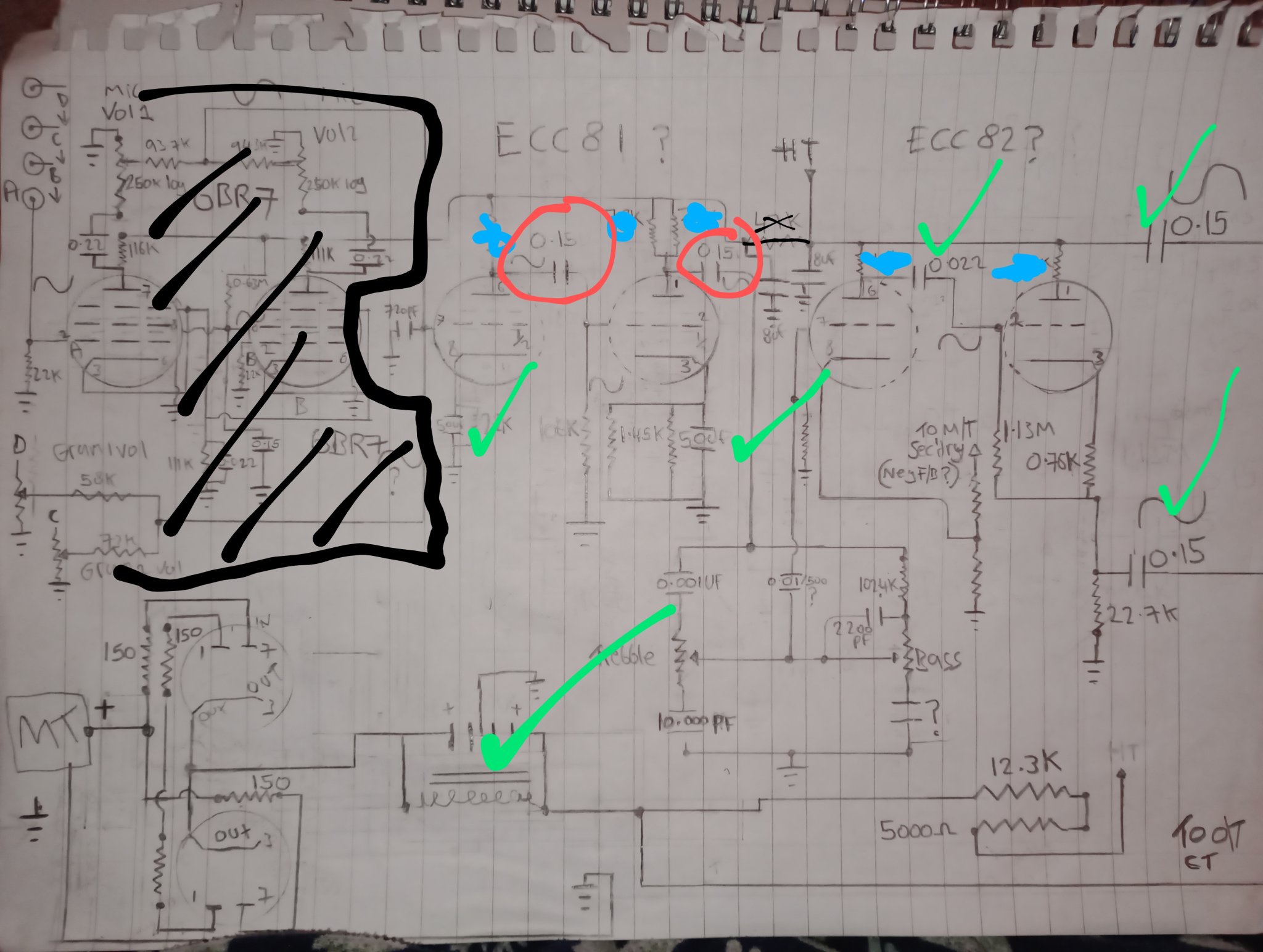

I have only the schematic/sketch I did myself. Go easy, it's my first attempt at drawing one, most of the resistor values are as measured, I can't guarantee everything is 100% accurate but hopefully it gives an idea on the circuit for those who asked. I appreciate your help, this is a steep learning curve but with the help of this forum and uncle Doug on YT, I am getting my head around it one step at a time!
I guessed that would be the case and expected to have to make some revisions to the circuit to accommodate. I obviously need to do some further reading on this, if you point me in the right direction I'd be grateful.ECC82 is very, very different from the 6N2P. Depending on your topology some voltages may go astray. Schematic please.
This is something I was going to mention. The readings I get here seem to fluctuate, a lot. I've taken a few readings and recorded the results and I've seen this as high as 33v .A positive voltage on the grid is perfectly normal for a cathodyne ... of course the cathode is more positive 🙂
This is the reason why we can use direct coupled cathodyne and first stage .
In this case 16V seems too low
Just looks like it as far as I can tell?

Edit: Missed 2 posts above. So it looks like a cathodyne but the pin 1 wiring is wrong. Coupling cap should go directly to plate.

Measure the voltage at the lower end of the 1.13M grid leak. That's your real grid voltage.

That circuit with the coupling cap to the cathodyne is a valid topology (there are 2 classical cathodyne circuits: DC coupled from the earlier stage; and cap coupled, as this amplifier uses).
The 1.13 / 1.16 Meg and the (0.76k?) self bias cathode resistor are in a loop from the grid to the cathode. That is OK.
Because there does not appear to be any global negative feedback that is applied before that coupling cap to the cathodyne,
there is no danger of too many coupling cap poles to worry about (like there would be in a Williamson circuit).
Yes, most meters have trouble measuring the grid voltage when the grid resistor is 1.13 / 1.16 Meg. So, instead . . .

Speaking of the output coupling cap (0.15µ). In the drawing it's connected the the HT node instead of the plate.That circuit with the coupling cap to the cathodyne is a valid topology (there are 2 classical cathodyne circuits: DC coupled from the earlier stage; and cap coupled, as this amplifier uses).

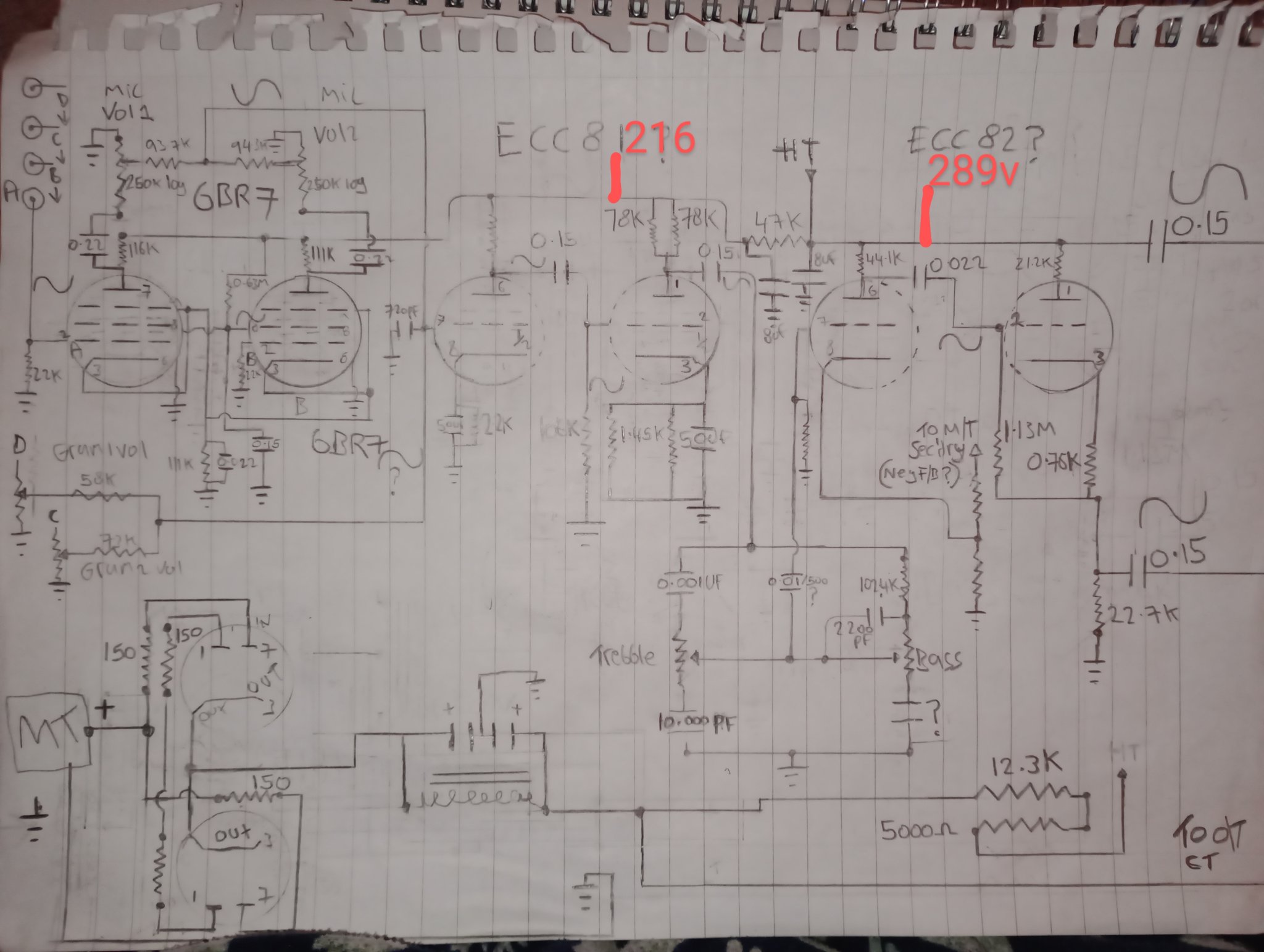

Ok, I've made a couple of changes, firstly I've taken the 6BR7's out, these won't be needed. They where for 2 mic inputs and are redundant.
These where the original HV resdings
I've removed the resistor you can see crossed out and changed the resistors marked blue. The reason for this, I only had 216v supplying the valve marked as ECC81 and the specs say 250v.
I assumed (wrongly?) that the resistor (marked 47k) had drifted causing the voltage drop....
I've changed the individual anode resistors to try and get closer to 250v.

It is completly wrong to change resistors like that ... all the blue plate resistors

Not the supply voltage is important but biasing the tubes right . The 47K resistor must be modified if the voltage is unacceptable low . 216V vs 250V is not such a big issue , not a reason for the amp not to work .
