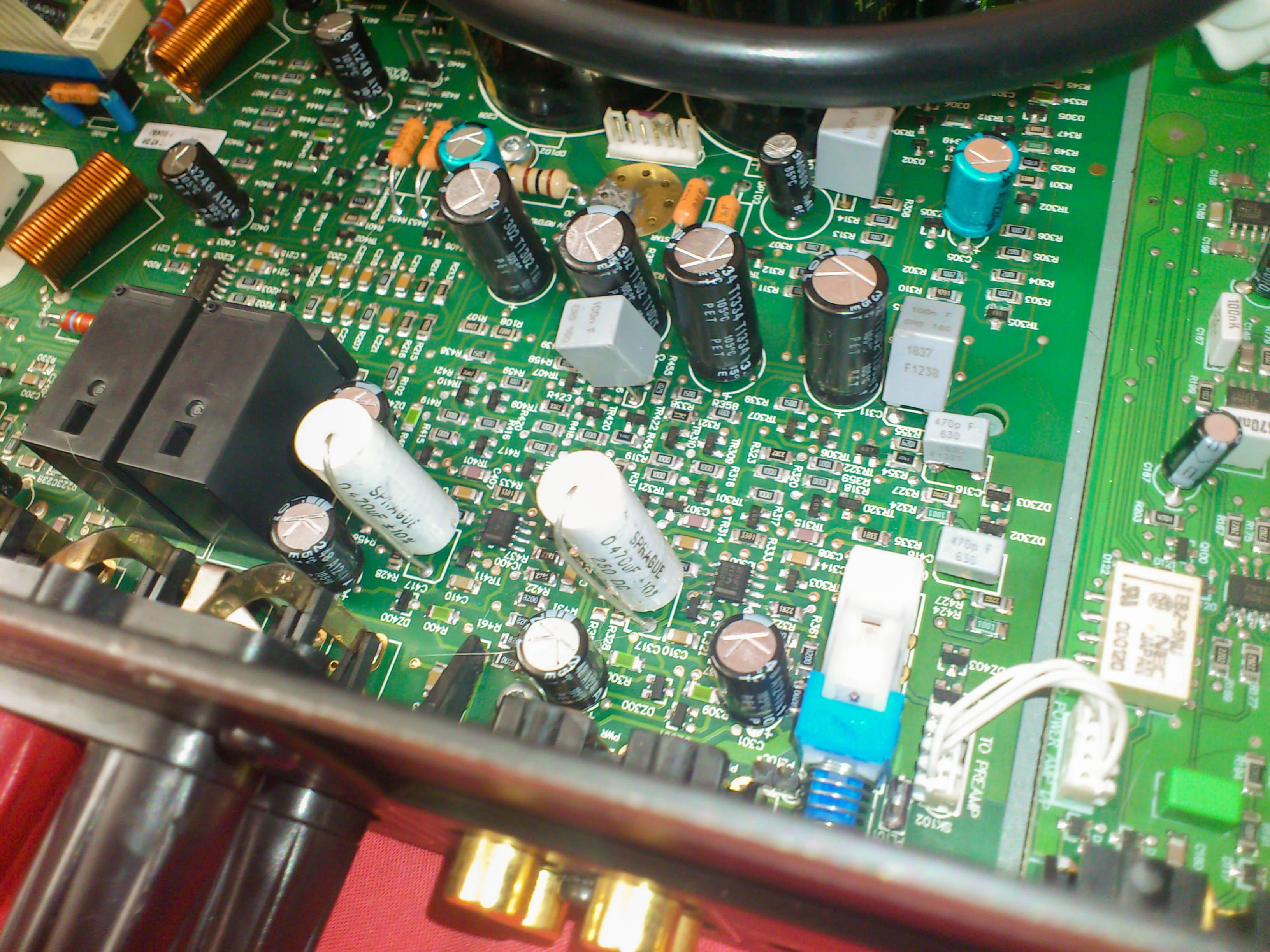

Right now I have a DC voltage
At the exit of the amplifier speakers ARCAM FMJ 32
100 millivolts
The tension starts from 5 millivolts and increases gradually up to about 100 millivolts
* Right channel as soon as I raise the volume
There is a jump in voltage that is balanced
* Left channel the voltage rise does not affect the DC voltage
What could be the reason?

100mV DC offset is within normal.
I thought well until yesterday I connected the amp it had the DC voltage
Speaker port
After half an hour I exploded two power transistors SAP15
I need to fix the amplifier
Replace transistors
Two diodes BAS16
Potentiometer 100 OHM
Three transistors FMMT497
diode Zener 15 V
And resistors
SMD 100 OHM
Rail voltage
And Resistors 33 OHM in pre drive to power transistor
And all this because I thought that 100 millivolts DC voltage is fine
Before the DC voltage amplifier was 2 to 4 millivolts
I've been racking my brain to find the problem in 😕

At the end I solved the problem of the DC OFFSET
Now the amp stable even after an hour of work without a signal
The DC OFFSET about 13 millivolts
Another thing that has improved Halafta film capacitors RIFA
470NF film makers of VISHAY V730P
They were very helpful stabilize the voltage
(Reducing the DC circuit consists of an amplifier Server LT072 .
The circuit DC SERVO running as a inverter .
The DC voltage rises . Output in the OP AMP becomes negative
it raises the Current Negative Supply foot .
circuit consists of resistor 1 MEGA OHM
And Film Capacitor 470NF )
the BIOS voltage is Stable 16 millivolts
During the calibration i passed back forward
Between Measuring Voltage DC OFFSET to measure voltages BIOS
A few more measurements and then I'll turn it to the speakers 😉
