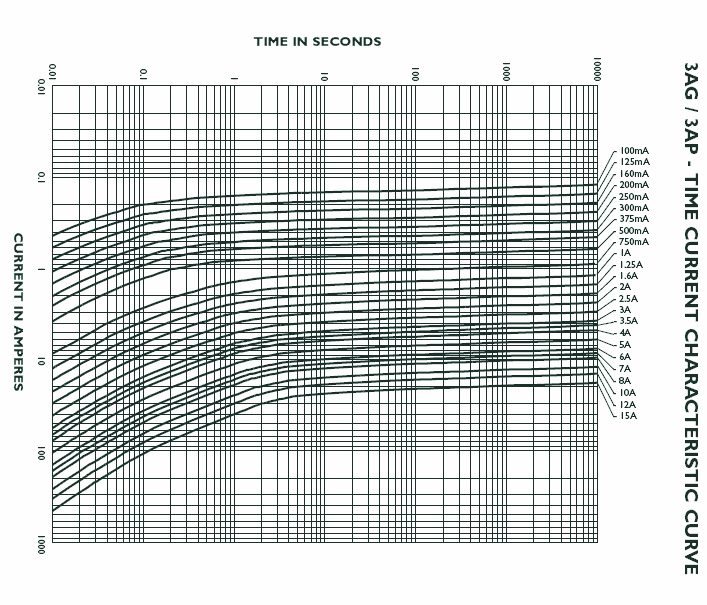

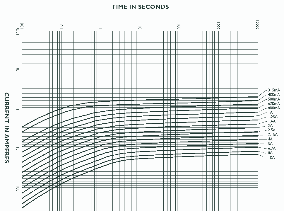

looking at rms current and that the two rail fuses are sharing the time, it would appear that I could have done the full power tests on even smaller fuses.Nordic said:Looking at the datasheet, for a common fuse, holds a few answers
12.5Apk=8.8Arms. F2A passes 4Arms for 1sec and F2.5A passes 5Arms for 2sec.
Similarly the 21.3Apk could be passed by F4A.
I shall need to try one size smaller and see if fatigue becomes a problem with prolonged use.
Nordic,
do you have tables/graphs for standard fuses and for T rated fuses?

Good information, Nordic!
I might add a PDF-catalog for further information:
http://www.qualtekhk.com/pdf/nonfuses_section.pdf
The main thing to be learned: The fuse's rated current is a current that will always flow, it's by no means the trip current (took me years to get that).
Regards, Klaus
