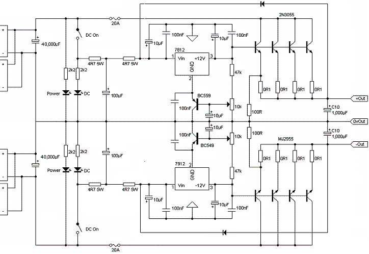

i though about building this, but never did. http://sound.westhost.com/project77.htm
i drew (spelling?) a dual version, (attached, i had to squash it 🙁 ), but i am not sure of its accuracy.
it is 12v, but i think by changing the zener, the volatge could be changed to 15v.
