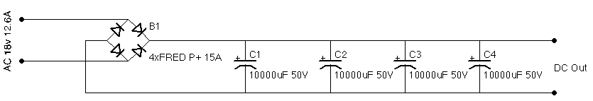

I am wanting to build a new psu for 2 class d amps that I have to get rid of the bricks that I am currently using.
I have seen on eBay and other sites a number of circuits for this purpose that would allow me to mask use of some toroidal transformers I have from older projects.
My questions are as follows...
Can I plug one amp into the +dc and the other into the - dc?
How can I get only + dc out of one of these boards?
Is there a better option?
Look forward to hearing from you.
Neil
Like This?
