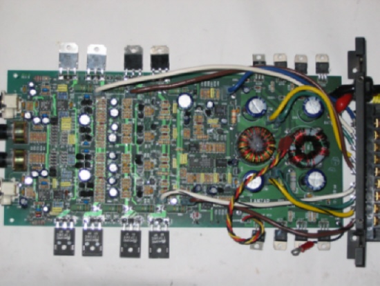

Can you post a good quality photo of the amp?

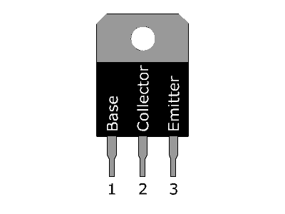

The pin numbering is left to right with the tab above the leads and the transistor facing you (able to read the part number). Use the center tap of the secondary as the reference for all of the readings. Be particularly accurate with pins 1 and 3. The difference between them may only be 1/2 volt. The amp should be on with no signal.

I am getting + and - 16.5 to 17 volts on all four of the op amps. I attached a picture, but I had to decrease the resolution quite a bit to get it to upload.

Did you use the pin numbering as shown in the attached image.
Pin 3 of each channels transistors should be virtually identical. For example, the left channel has 1 full volt across the emitter resistors. If this is the case, the amp should be drawing significant current (10+ amps) and the output transistors should be getting hot. Open or out-of-tolerance emitter resistors could explain why it would not be drawing current but if they were defective I'd expect to see the third terminal of the TIP35 above ground potential.
