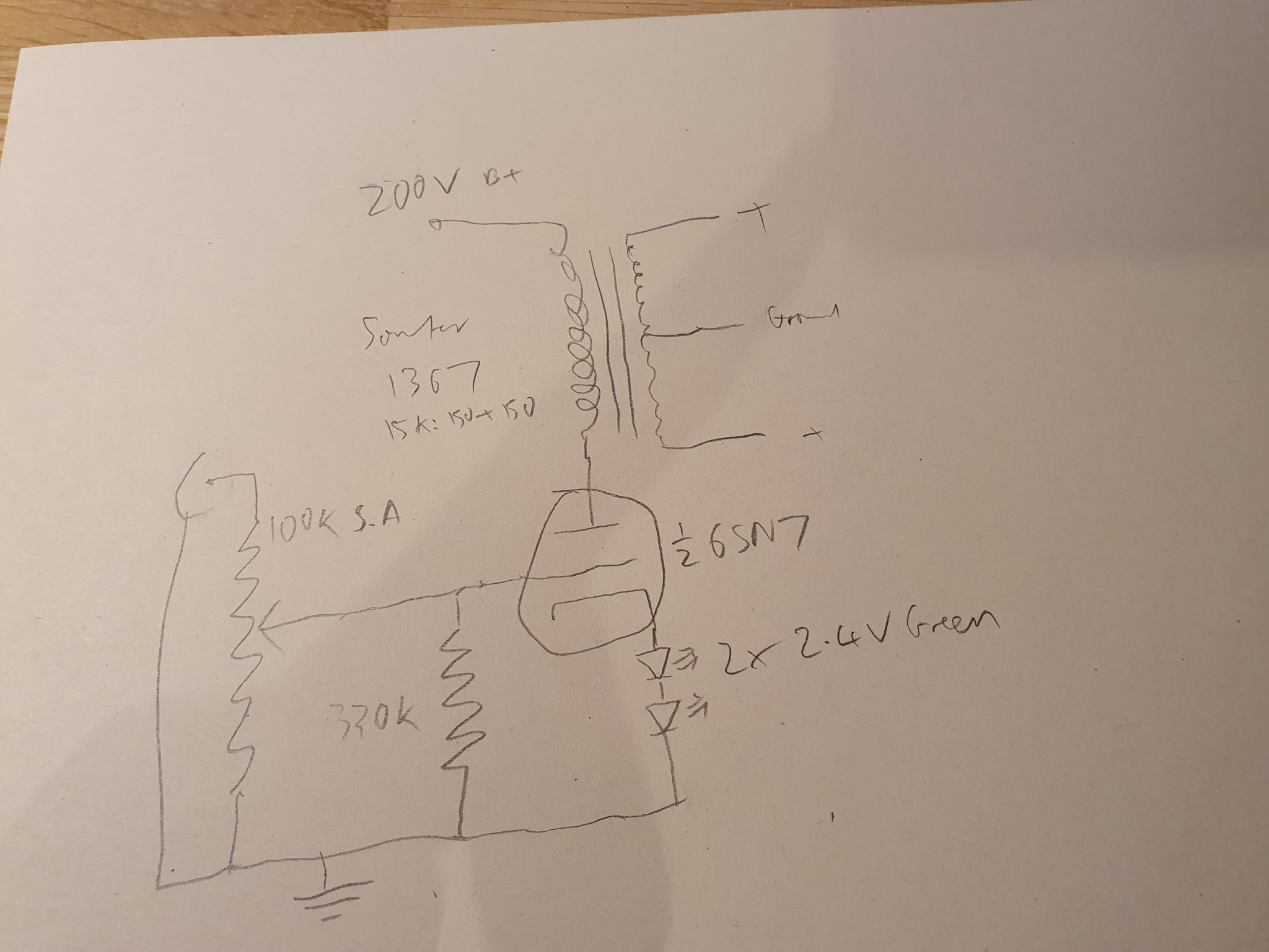

I am getting confused about an issue my line stage is having.
The stage, easier to describe than picture probably: Elma input selector - Elma 100k stepped attenuator with 470k resistors parallel to the output - transformer coupled 6SN7 using Sowter 1367 transformers running at 200V, LED bias at 4.8V. Heaters are DC.
Recently, as the stage heats up it appears that a few volts DC is appearing on the input connectors and I am struggling to even think of a mechanism by which this would happen given that the attenuator and the parallel resistors should by definition reference pins 1 and 4 to ground.
I have replaced the valve socket, it is happening with either of the valves I have to hand.
Before I go completely bonkers, am I missing something obvious?

This is it, pretty much on the back of an envelope. No feedback included as the step down ratio of the transformer means a low gain and a high reflected load, no input caps here as there aren't any sources I have that should need them.
Does the DC voltage present on the grid go away when the volume control is set at minimum? It should.
If there are "a few volts" on the grid when the control is at maximum, the current must be on the order of 30-50 uA.
The 6SN7 either has excessive grid current, or else there is a leakage path from the cathode or plate to the grid.

Even with nothing connected to the input connector, and the volume control full, the grid "sees" 77k Ohms to ground.
There better not be any significant grid voltage under that condition.

The voltage on the input on the right channel (triode 1 as I have wired it) was varying with volume setting up to about the planned bias voltage. Everything else would need to depend on having time without small children to measure with the lid off.
The right channel was what I measured to start with as the symptom was the signal fading out from my DAC on that side unless the volume setting was at full. The left channel (triode 2) did not react in the same way.

If you short out the grid leak resistor Rg, there better be Zero, 0.000 Volts, on the grid (Rg is from the grid to ground).
For a properly working 6SN7, if the grid is at zero volts,and the plate load resistor has B+ at the top and the plate at the bottom; and the cathode is tied to two 2.4 Volt LEDs in series, there better be 4.8 Volts on the cathode. With 2.4 Volts across each LED, they will be lighted (if they are broken, the voltage across each LED will be something other than 2.4V).

Put a coupling cap between pot wiper and grid+330K and then measure the grid voltage and input voltage.
@6A3sUMMERThe voltage on the input on the right channel (triode 1 as I have wired it) was varying with volume setting up to about the planned bias voltage.
I think that this /half/ of tube is defected, may occur relatively low resistance between grid and cathode (if the tube is warmed up).
If the light of LEDs is altering (shorting grid to ground), even extinguished, this is the reason.
Update on this: I first split the volume/input selector off into a separate box as effectively a passive pre into a valve gain stage/buffer, which gave a bit more space to arrange so that the LEDs and ground reference resistors were on separate tagboards. This also swapped over which halves of the valve did which channel to keep the wiring vaguely sensible. Result: slightly more time before DC kicks in but it does, only this time on the left channel rather than the right.
At this point I checked the heater voltage just to be sure. The power supply as originally built had an LT1085 set to deliver pretty much 6.3V DC. In theory...
Following some very odd readings, I then dug out a 6V traffic and set up a CRC smoothing circuit to actually give 6.3V and it appears to be problem solved. Am starting to be distinctly suspicious of how some 3 pin regulators behave in practice...
