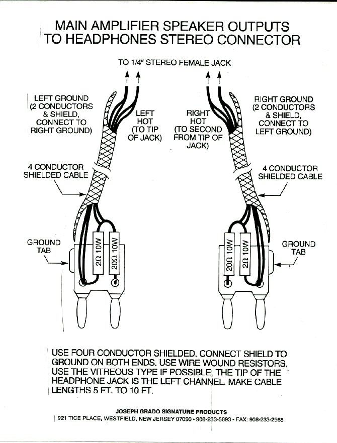

Here's a scan regarding amplifier to headphone connection:
I don't know why there is such a rush to use the T-amps with headphones. Because it's cheap? Really, there are better amps out their for headphone use.
As for ultrasonics, there is quite a bit left over in the signal. I have only measured one set of tweeters at 700kHz, but they were about 16 ohms. 4 ohms at normal frequencies. No idea what the K1000 do.
The T-amps NEED a resistor on the output if you're going to drive headphones. 8 or 6 ohms would be ideal. This load helps the output filter. See this graph. The line that heads for the sky at the top end is the unloaded response. That's what you'll get on headphones without that resistor.
The image lucpes posted above is close to what I use for my amp testing headphone rig. An L-Pad. But use 8 ohms, not 20, as seen on the drawing.
