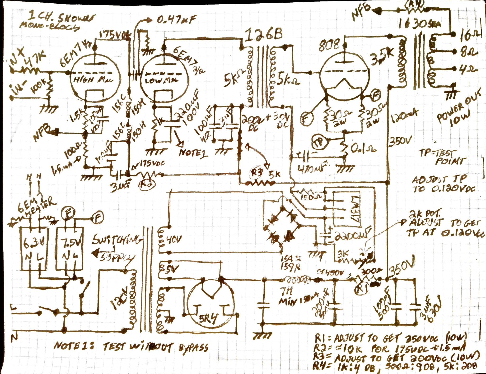

I only use mean well smps from the EPS serie for filament or heater now. I use the version ending with a -c to get the shield cage and you can even position them close to a IT transformer without problems. They offer little bit of adjustment and I use two resistors in serie to drop a little bit voltage. On some tube like my 808 they do the powering up in two steps because of current limiting security inside, so I use a separate switch to turn on the heater first and then the hv ps. I’ve been using that on tubes from the 30s and 40s without any degradation and it’s amazing if you need to get the lowest noise floor possible in an amplifier.
i tried different things including expensive dedicated heater boards for 808 45 845 2a3 and this is the best solution I could find and it’s really cheap, even if you need one per tube in case of DHT.
Don‘t use any additional filter with those at the output or input. Those smps are really well build.

This is how I use those smps to give you an idea. There is a mistake in the 120v wiring of my switches on the schematic. The first switch should be feeding the smps and from the exit of that switch it goes to my HV switch so you can’t power up the HV without the heaters and filaments.
To overcome the extra current demand with cold heaters, would it be enough to use 2x the nominal power ?
I am mainly using small signal tubes and no DHT, would it be safe to use just a single switch to turn on both supplies at the same time ?
I am aware of the supposed benefits by switching on the hv only after the heaters have warmed up, but to be honest with linear supplies and small signal tubes I never did and did not get the impression this shortened tubes life in a noticeable way.
I see they have an EMI filter built in. No need to use a filtered IEC socket to avoid noise injected back into mains ?
What about protection against spikes or surges, do they need additional components on the input for example MOV ?
They have mov inside and and well protected.
I use 45w smps for 25- 30w heater so yes around 1.5 to 2 time the nominal power.
You can use single switch but they take a second or two to power up. Using Twi switches is really cheap and easy to do. All my amplifiers have the 1 -2 switch powering scheme so I'm use to it.

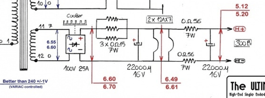

Note that in my full linear à l'ancienne circuit, I mention 17mVRMS accross the 300B tube heater, and NOT the speaker terminals, where I have zero mV ripple checked with bench-lab TRMS DMM and scope.
That said, my most efficient speakers are also rated at 95dB/W/m, and not 118dB/W/m... Just a mere 23dB below 🙄 ! Then I imagine your embarrassment, yes... 😕
