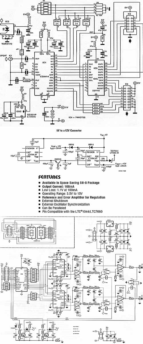

DC-DC converter to get +-12V to feed the ouput opamps in DAC2000

in the cd(Pioneer pds 904)I have removed the trafo for +-12v,as
I have been using a tubeoutput stage,now I am building a Ext. DAC2000.I thought of powering the output IC´s in the DAC with
the 7,2v, but the opamps will not run on single + power(or will
they?)I thougt if I used a +- converter I got +- 12volts,and even
+- 5volts for the Dac´s.So the 7,2volts is in the cd player,what if I
put the converter in a shielded box?

The Linear Technology LT1054 looks like a posibility. The datasheet includes a circuit for a 5V to +/-12V converter - the current is limited to 25mA, but that may be enough. I guess there aren't any higher power versions available?
With the 7.2V supply the original poster has available, I guess a regulated +/-12V supply using one LT1054 should be possible...

The LT1054 would work, but maybe difficult to obtain and limited in the Iout possible.
Charge pumps are very easy to build and I would advocate building one from discretes and a 555 timer. Regulation can be done with a linear regulator after the event - unlike switched DC/DC you do not need active control on the charge pump. Anyone using a DAC could generate the charge pump drive signal from the LRCK (44.1KHz), no async. noise.

How is this done?The power konsumption of 4 OPA627 is 28mA
Max,maybee if i built 2 of these.One for 2 OPA627,or AD8610.And I wonder if the relays for switching between the 2 filter sections is realy nessesery?And it says on the schema for the LT 1054 that
max voltage is 15volts can I use 7,2Volts for the +- 12v schema
instead of 5v as it says on the schema?Meny questions.😕
