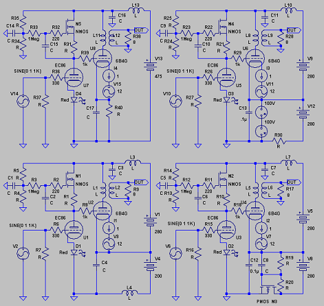

DC-coupling of tube stages
Below are four of many possible solutions of DC-coupling a driver to an output tube in a SE-poweramp.
The anode is DC-connected to the grid of the presceding stage.
To keep bias potential OK (no need to bother about tube-aging) a CVS(gyrator) is used instead of a CCS.
But are they really DC-connected😉 ? One must take a close look at the PSU´s to determine.
What do you think?

Hey Shoog,
Check again, there is only waste in ONE of the circuits 😉 .
The others are a smart way to get rid of the input transformer you use, by just moving the ground connection.
But the question isn´t about waste, it is about if DC-connections really are DC, as the other pole through the PSU must be taken in account.
I see what you mean - clever work. Still needs two power supplies which is a bit of a pain.
I am not really qualified to answer your question, but I think they are DC coupled because the two +B in your circuit are effectively at AC ground.

OK, get your point. Still it is not about what I want to discuss here😉.
My question and idea is that there seldom are such things as DC-coupling as the pole through the PSU in fact mostly is cap-coupled. In other words we are fooling ourselves😀!
One have to use a cap-free, lowZ series- or shunt-regulated PSU to achieve this.

First I needed to realize that the current loop of your driver supply
goes through the B+ supply ;-) But that pole is isolated by MOSFET.
There is indeed at least a low frequency pole in almost everything that
isn't regulated. Two of your topologies use a regulated driver supply.
and would appear to be mostly DC stable.
Isn't there also a time constant involved in the gate coupling C and
the 1Meg DC reference? If the driver waveform is asymmetric there
will be a small DC shift + time constant with signal level. Keeping the
driver in the symmetric range and small R should mitigate this though.
I think there is a big difference in terms of which current loop the
time constant is in. I would expect more audible artifacts in the
cathode branch vs. the anode branch, the common regulated driver
but unregulated B+ in DC topologies may bear this out.
And what is the goal in direct coupling? For me first and foremost
is to eliminate blocking distortion, where even minute grid current
causes the coupling cap to charge and discharge on peaks. I find
this pretty annoying, and DC is one solution.
