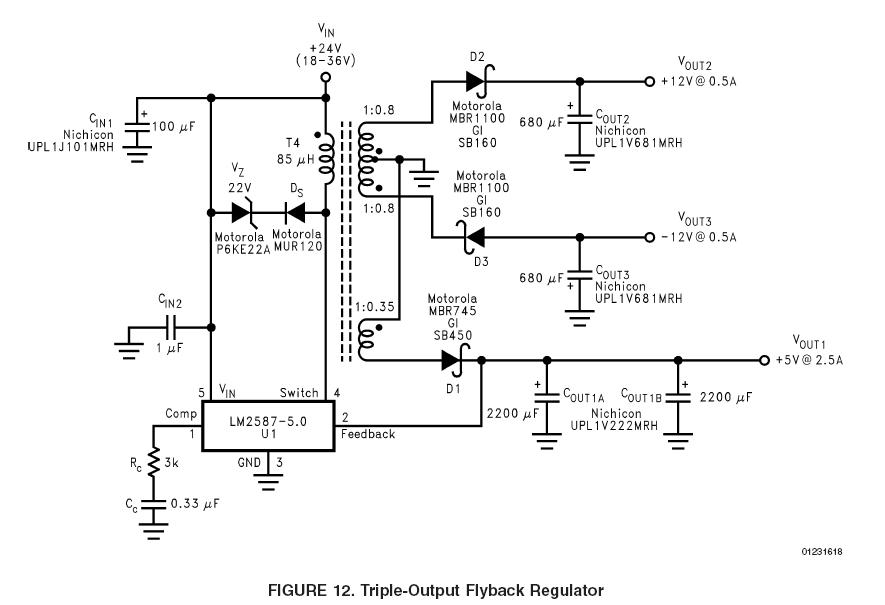

Here, Try this one out. Schematic shows it for a +24V (nominal) input, but, using the design procedure in the datasheet, you can adapt this for 12V....
