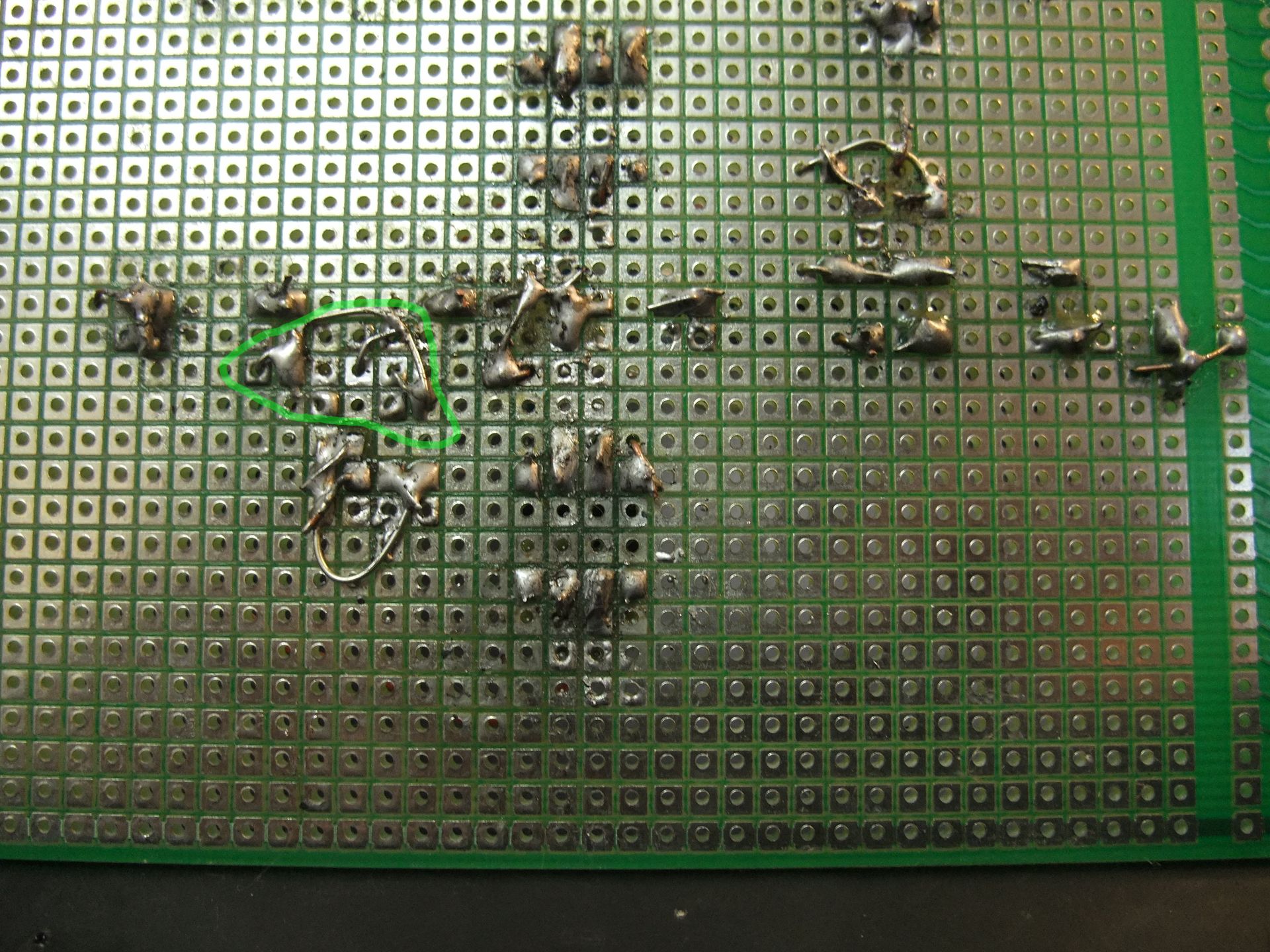

Hey, I never said I did nothing wrong. I'm smarter than that, and my soldering sucks. Furthermore, the circuit resets (tension buildup disappears) when I twist the circuit board, so I'm pretty sure it's my bad.

Yes, either a dry joint or a crack in a PCB trace. If you are using modern lead-free solder then I understand that dry joints and good joints can look identical (I always use the old 'poisonous' solder). If you showed us the circuit we could probably tell you where to look for the problem.
I'd look for an op amp input fed by a capacitor, that also has a resistor to ground, or to some other circuit node that direct current can flow out of.
If that resistor is not properly connected, the small bias current flowing out of the op-amp input charges up the capacitor and hey presto, the very fault you describe.
Probably, learn to solder properly, you've got a dry joint at the end of a resistor. Before you fix it, look at it, see how it looks different from good joints. As DF96 says (and I paraphrase a little) "use proper solder".
As DF96 also says, possibly a crack in a pcb trace. They can be very fine indeed and still be an open circuit. But my money's on a dry joint.

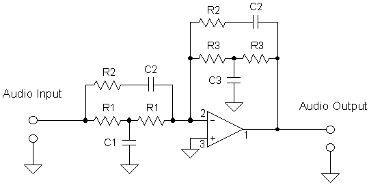

I couldn't find any obvious bad joints, but I "untangled" some blobs where lots of leads met. On the third one the buildup disappeared, and the output is DC-free! 😀
Thanks a lot to everyone, and especially to Simon B. I went untangling the capacitor junctions first. The troubled capacitor was closer to the output, but was a part of the feedback loop. It's the rightmost C2 in the schematic attached.
There are 'before' and 'after' pictures, if anyone's interested.
DF96, sorry for misleading, but I didn't realize at the time. As you can see, the before picture doesn't have obvious 'bad' joints, just lots of evil blobby ones. Guess I underestimated their evilness.
