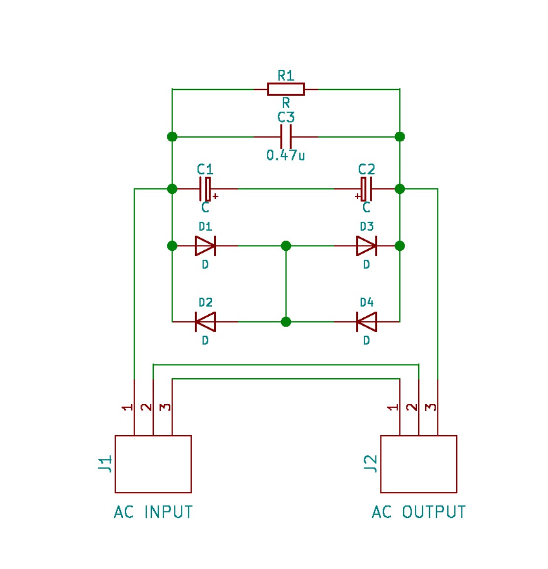

Since building, the transformer on my F6 has made slight mechanical noise. This is not audible on the speakers.
It made a low level hum, but when other items like the network server were switched on there was a "boing" sound for a few seconds.
I fitted a DC blocker recently (simple cap and rectifier design.)
Just isolating the amp.
This has removed the mechanical noise, and the boing.
It may be psychological but the amp now sounds cleaner and even better.
Anyway may help someone else. 🙂

I'm pretty sure the "boing" is mechanical noise due to current change either incoming on the amp at turn on or something else on the ac line draining current. Injection of dc current to the AC line will cause hum in toroids. I read this starts to happen on toroid 600va and larger.
I have a 2k VA balanced power unit that needed such a dc filter. Still have some noise when things connected to it are powered on.
Any reduction of the noise floor will give an improvement.

Have you tried to mesure accurately the dc online , instead of blocking some hypothetycal dc 🙄

The link was just to show that DC on AC lines is a real problem and not imaginary or due to "bad design". I don't know if the product even exists today. PS Audio had something similar.

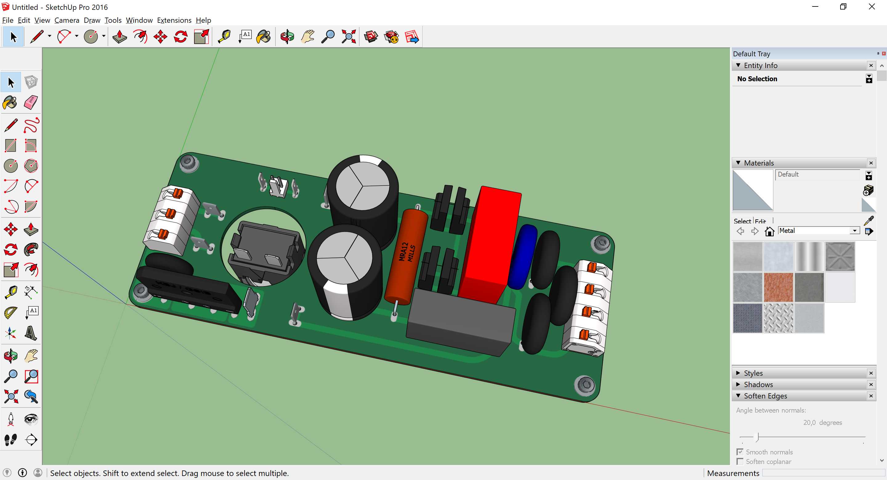

If you want a ready built option there is this.
DC Blocker Trap Filter – Populated PCB | ATL Hi-Fi Audio Company
Or you can just build it.
I wonder if the dc blocker has also limited the current surgeI fitted a DC blocker recently (simple cap and rectifier design.)

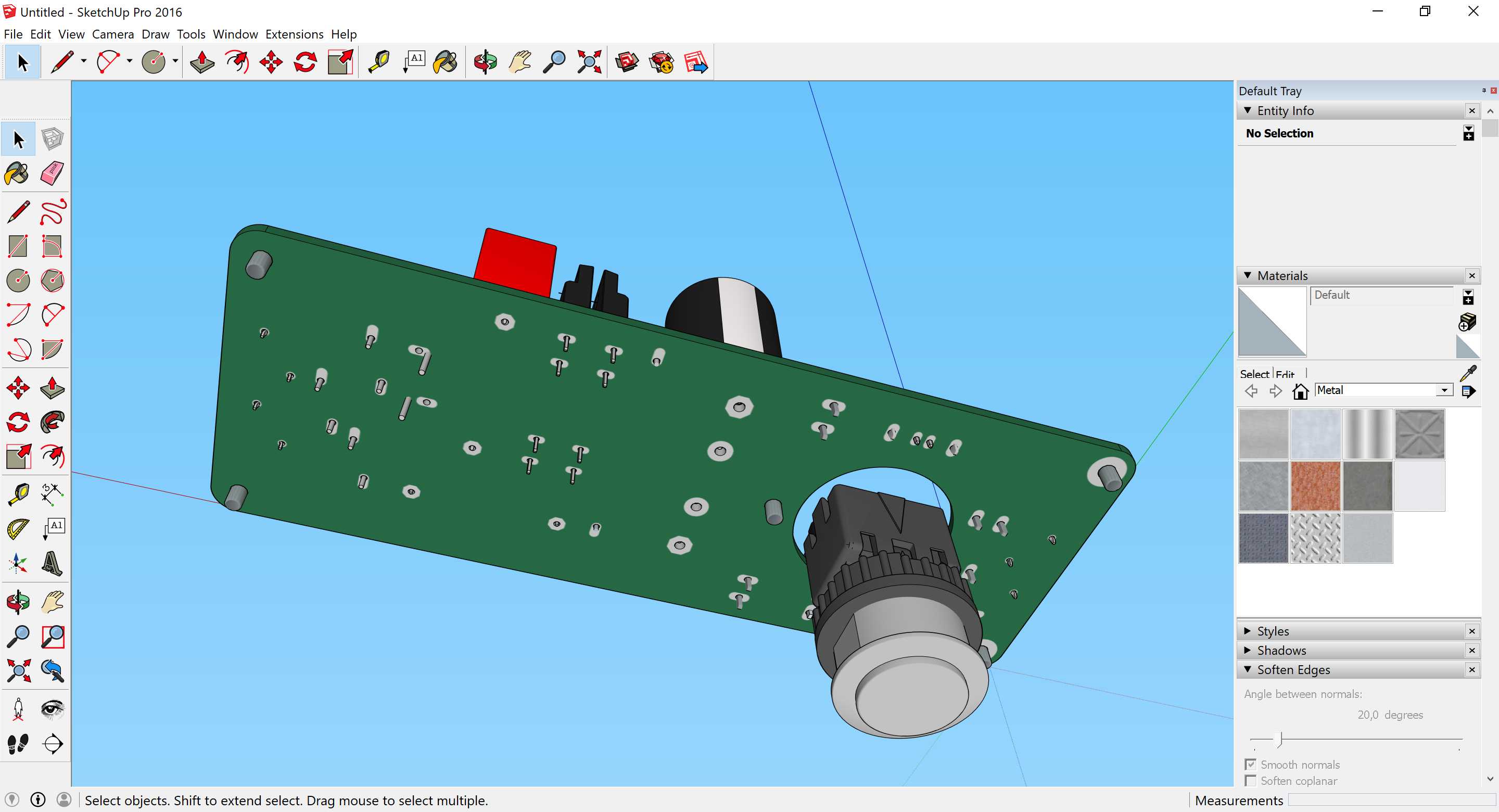

Both commercial from type line filter + DC blocker with nice money back garantee.
My idea was to offer an electronic build mounted directly on the frontplate of a chassis (2U, 3U, 4U and so on, from HIFI2000 for example), located near to the transformer in the power amplifier.
Wired from a fused COTS line filter on the rear plate of the chassis to the helper; wiring main switch or not; selecting main voltage bei correct soldering of the thermistor and finishing the wiring to the big toroidal main transformer.
I had never problems with DC with my electronic but love to reduce wiring to a minimum and therefore I planned a small interconnect board for main switch and inrush current limiter respecting safety european standards (IEC60950).
No matter, I´ll order soon some prototypes for personal use.
JP
JP
