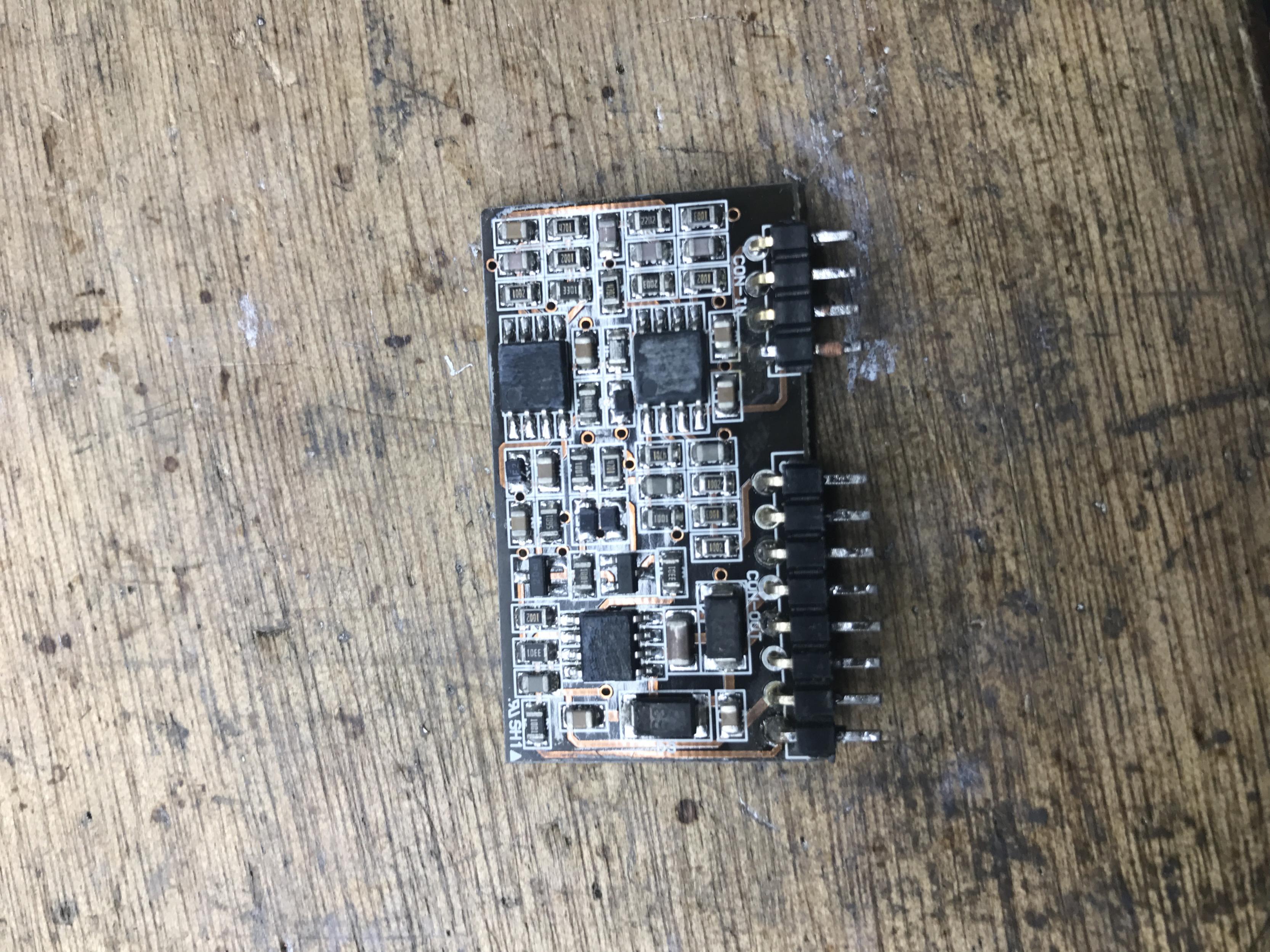

M megael9 Member Joined 2009 Paid Member 2017-06-27 7:12 pm #1 2017-06-27 7:12 pm #1 IM WORKING WITH A DC AUDIO 12K. THIS AMP IS ON PROTECTION MODE, BUT AFTER PULLING OUT THE AUDIO DRIVER BOARDS, THE PROTECTION STOPPED. CAN SOMEONE GET THE PART NUMBER FOR THE 3 8 PIN CHIPS ON THIS BOARD? Attachments unnamed.jpg1.jpg 127.7 KB · Views: 169 image1(3).jpg 1 MB · Views: 160 M megael9 Member Joined 2009 Paid Member 2017-06-28 8:50 pm #2 2017-06-28 8:50 pm #2 One of the 2,boards is the problem. Where can I buy this board? P Perry Babin Member Joined 2003 bcae1.com 2017-06-28 8:55 pm #3 2017-06-28 8:55 pm #3 2x TL072 and 1x IRS2184S Note the pulled via. M megael9 Member Joined 2009 Paid Member 2017-07-07 12:45 am #4 2017-07-07 12:45 am #4 in which order they go? P Perry Babin Member Joined 2003 bcae1.com 2017-07-07 2:02 am #5 2017-07-07 2:02 am #5 the TL072s are together. The 21824 is off on its own. Status Not open for further replies. Share: Facebook X (Twitter) LinkedIn Reddit Pinterest Tumblr WhatsApp Email Link
