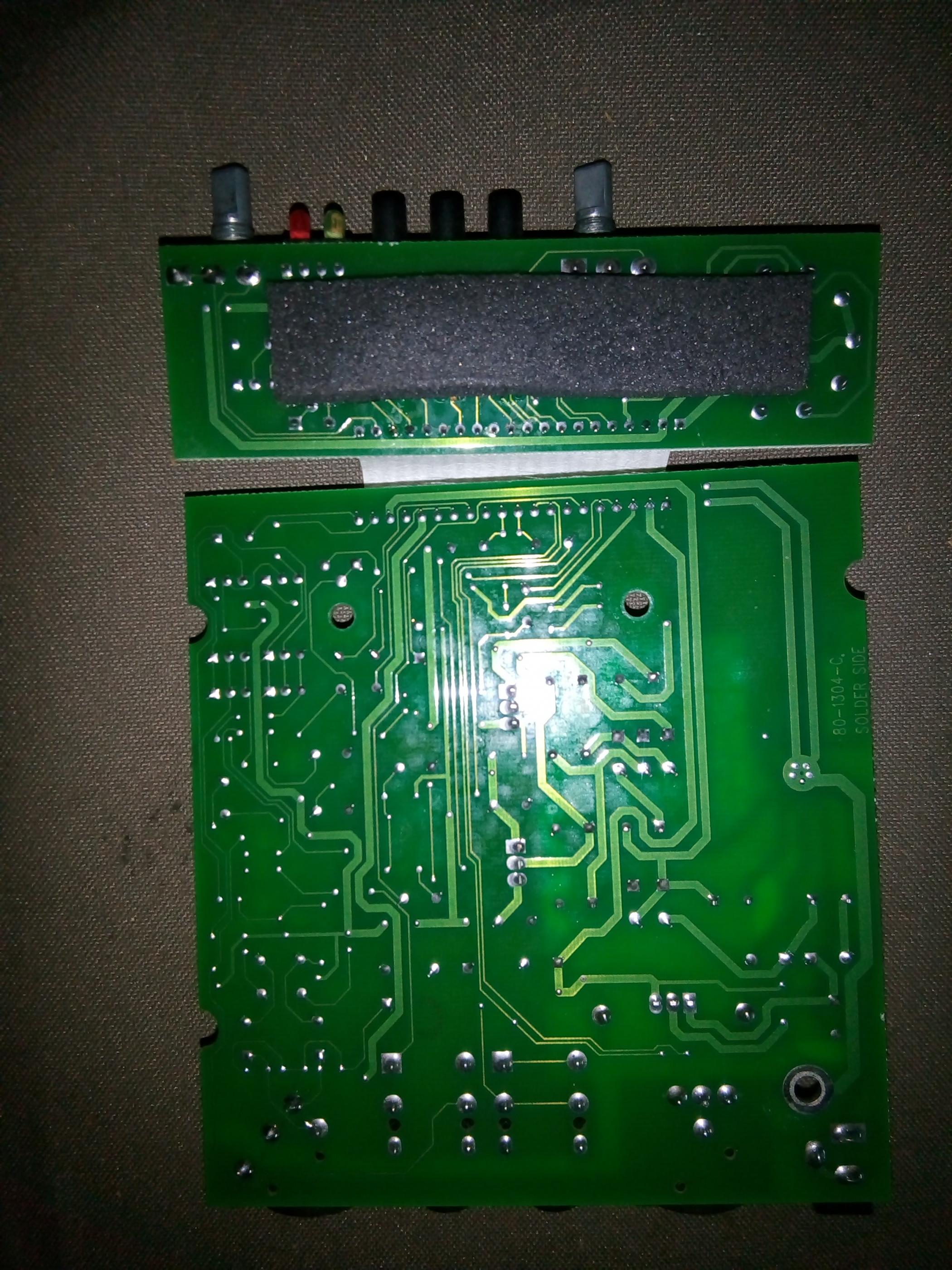

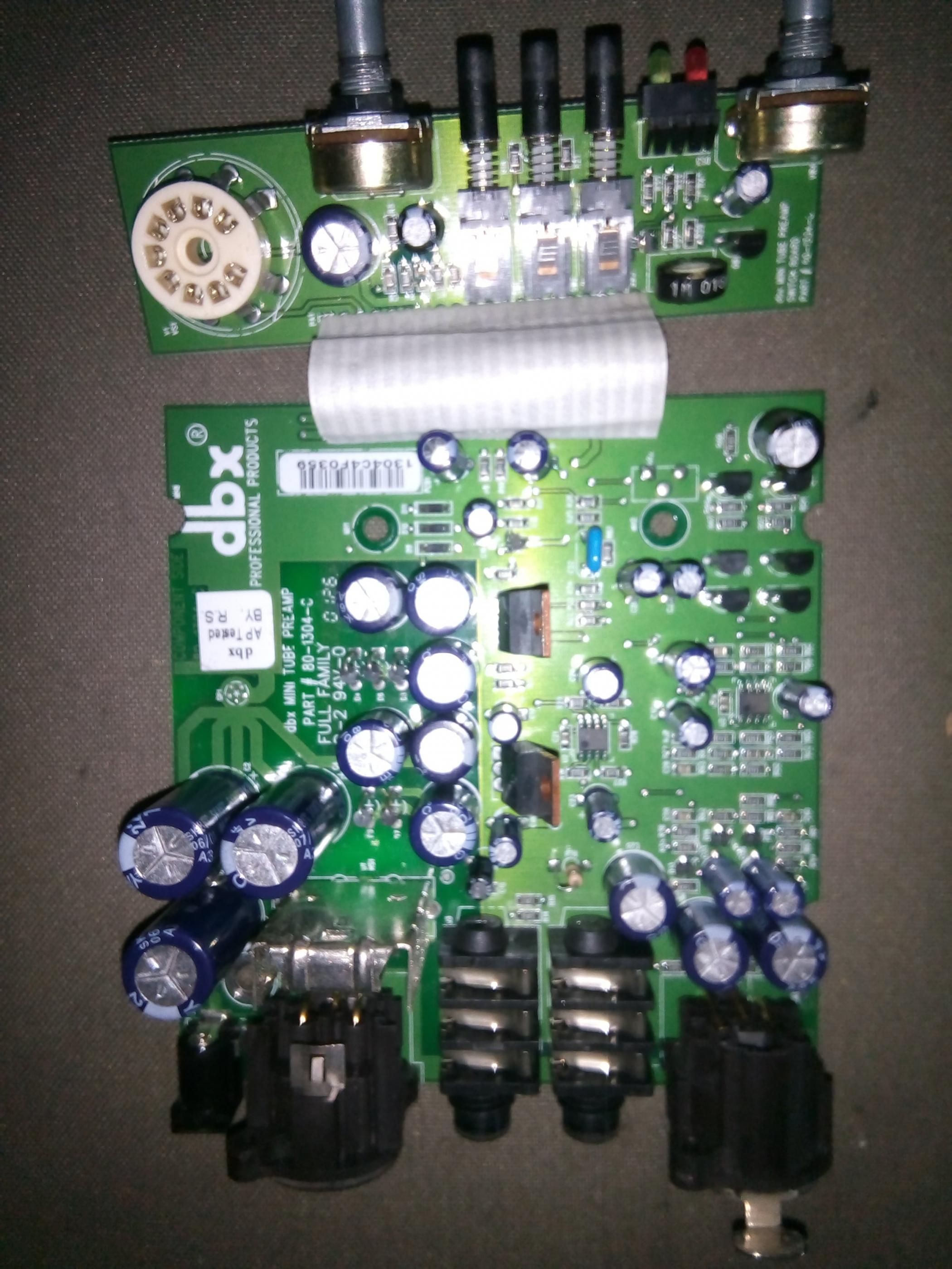

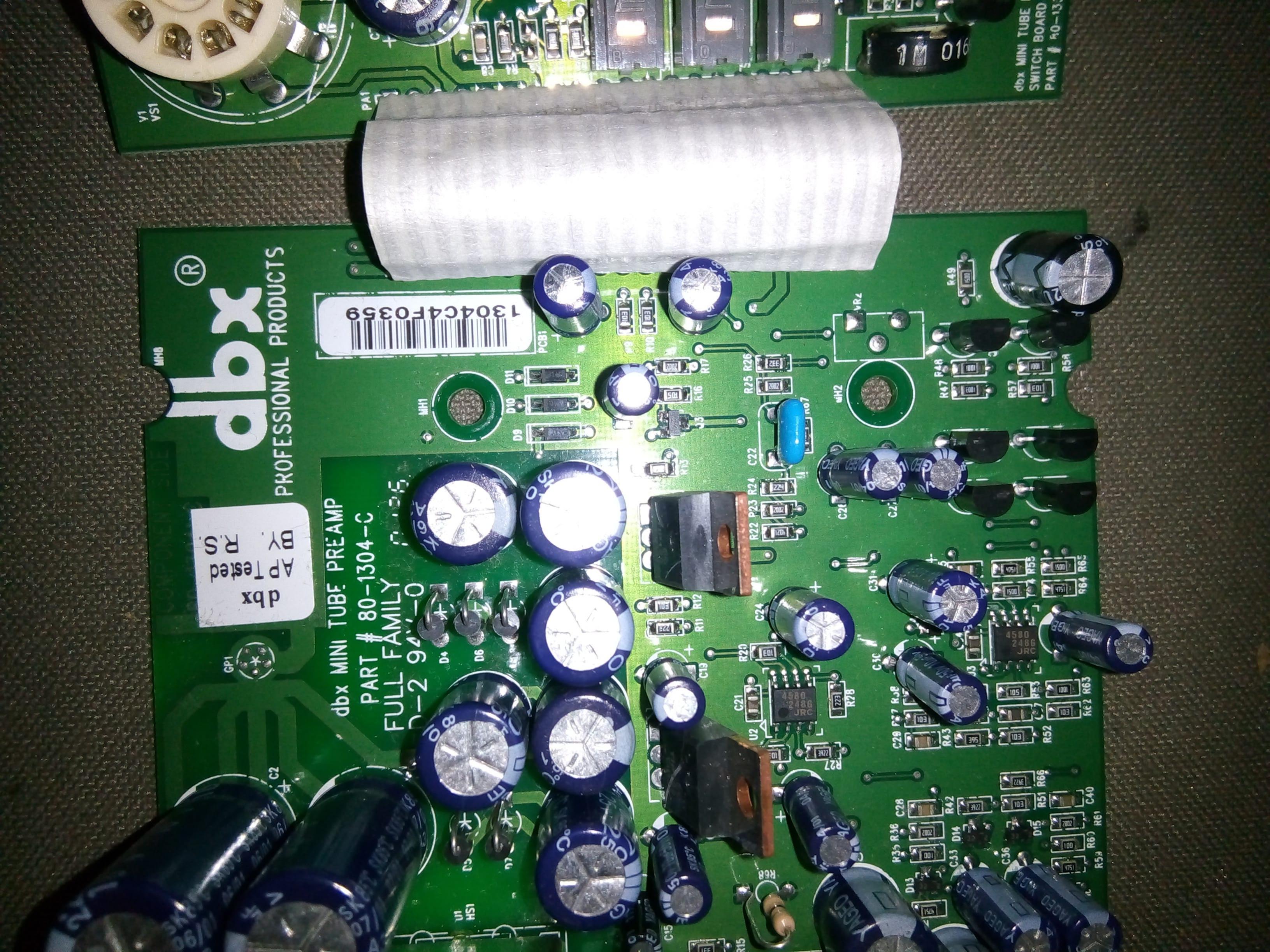

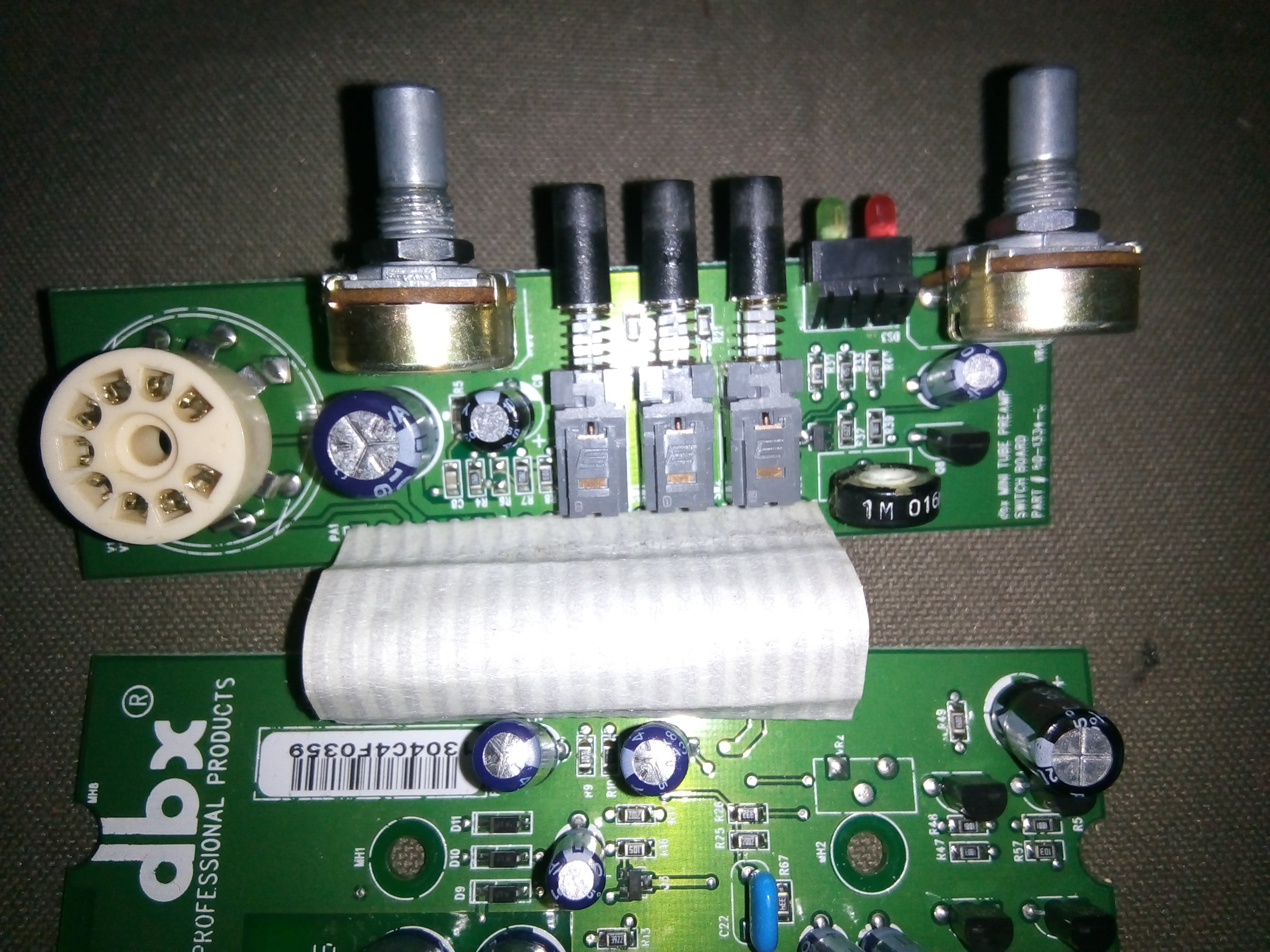

Just to do something in the right direction you can take a couple detailed readable closeups, one from component side, one from copper side, so at least we have an idea of what are you dealing with.
At least whether it´s a pure Tube circuit, a Hybrid, if so what transistors or Op Amps does it have, etc.

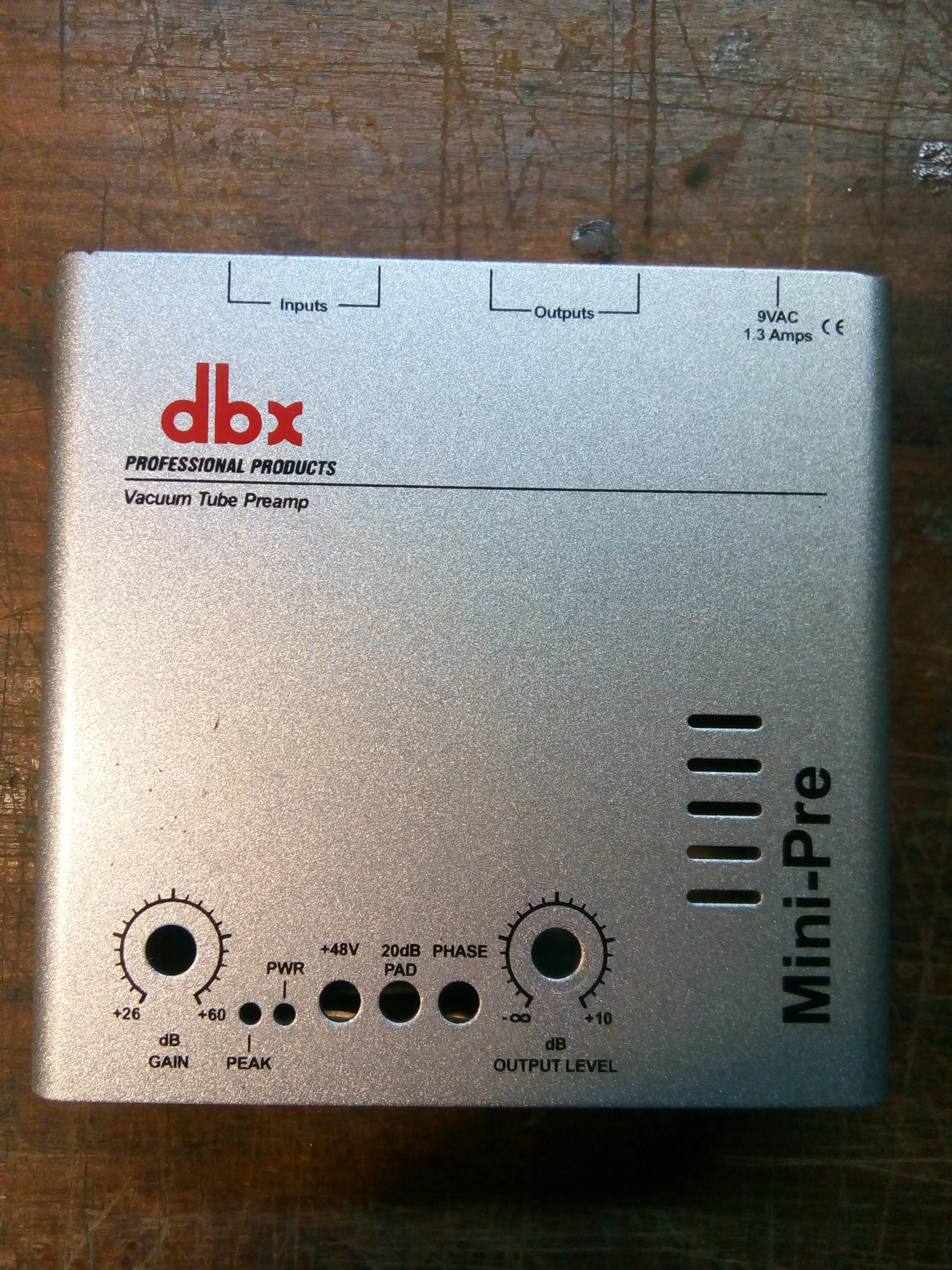

Here are some pics attached.
The Philips NOS ECC83 that I tried was in really good shape when I tested it. And as to johnsurnamerobinson, I know these high gain tube distortion boxes, they all make a hell of noise, and that is basically their purpose.
Back to my problem...
I replaced the 2 caps (47uF/50V) on all 3 preamps, the caps that are just below the ribbon that connects both pcbs. They all were leaking electrolyte so they had to be replaced anyway. There are 4 caps (2x 100uF/63V + 2x 47uF/50V), just behind the XLR input connector. When I touch their metal top, there is a huge noise increase, but this noise is also present with new caps installed, so I think this is supposed to be. When I remove the tubes from the preamps, the noise disappears. I don't no if this is expected or if this could be a clue...
