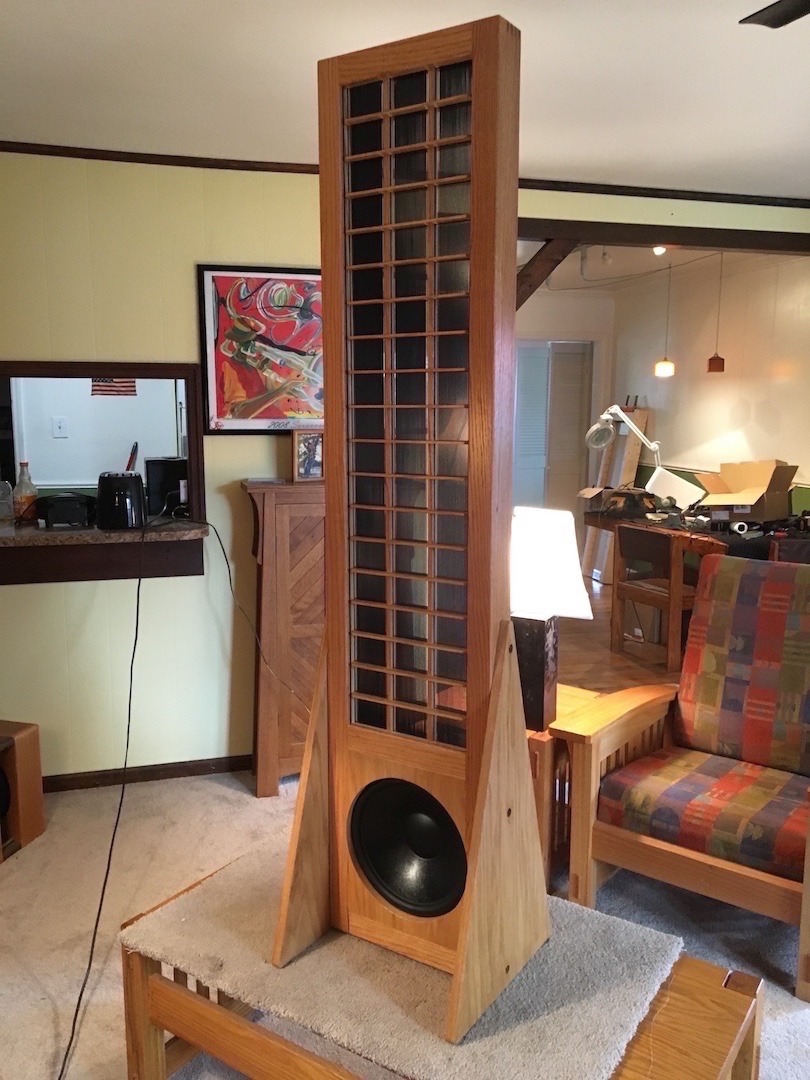

I'm using a DBX Driverack Venu 360 on my homebuilt hybrid ESLs and couldn't be happier.
I experiment with crossover points and slopes occasionally but I find that a mirror image crossover at 250Hz using the 24db/octave Linkwitz-Riley filter works pretty well. This allows driving the volume quite high without risk of saturating the transformers or driving the diaphragm into a stator.
I especially like the DBX's user interface and I-pad control app. I'm gonna say the Venu 360 is the coolest audio gadget I've ever owned. It's functionally identical to the PA2 except that it has both analog and digital inputs (which I use) and a bunch of other features you would only use for PA applications.

BTW; I'm driving the DIY wire-stator ESL below with the DBX Venu 360:
