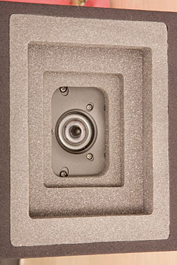

if on the front of the baffle proceed with the same materials (above). I would use some of the Acoustic Sound Damping Foam 1-1/2" x 24" x 18" UL 94 type.

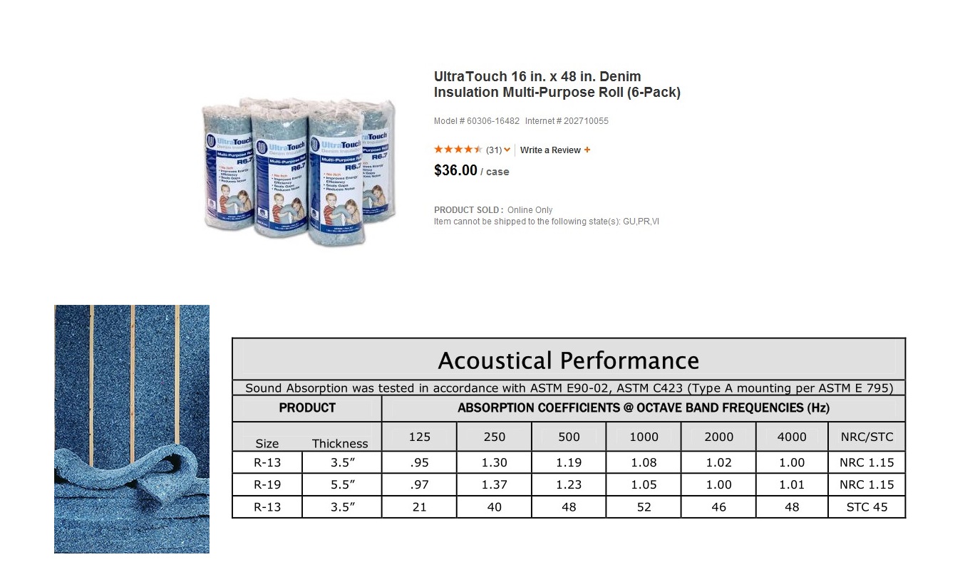

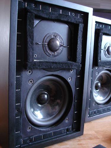

I actually have a bale of Ultra Touch Cotton insulation that I've used for some PA cabinets. On the LCM-1's I was thinking of just leaving the insulation off the Outside of the cabinets. Seems strange to design a cab with insulation on the outside held in place by the grill cloth. Does anyone know if it actually serves a purpose, maybe to dampen some high's? ?
The Ultra Touch does seem to tighten up the bass on PA speakers a bit and you have the added safety of not breathing in fiberglass when they thump.
I'm still interested if anyone has compared the LCM-1 to any more modern cabinets?

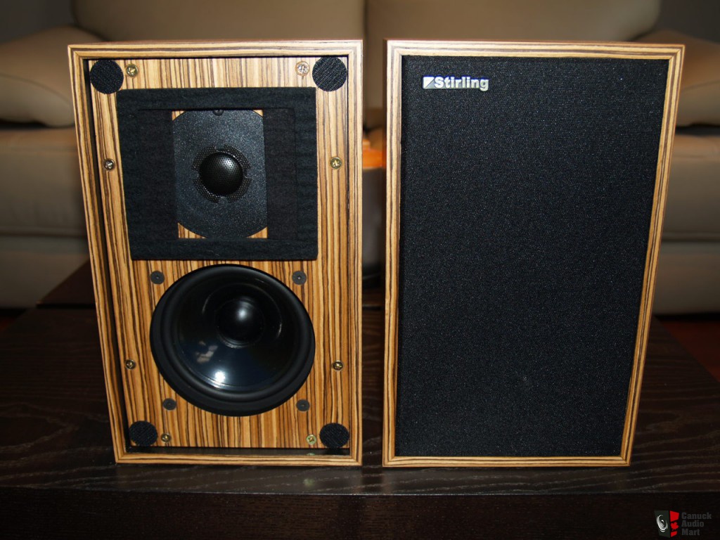

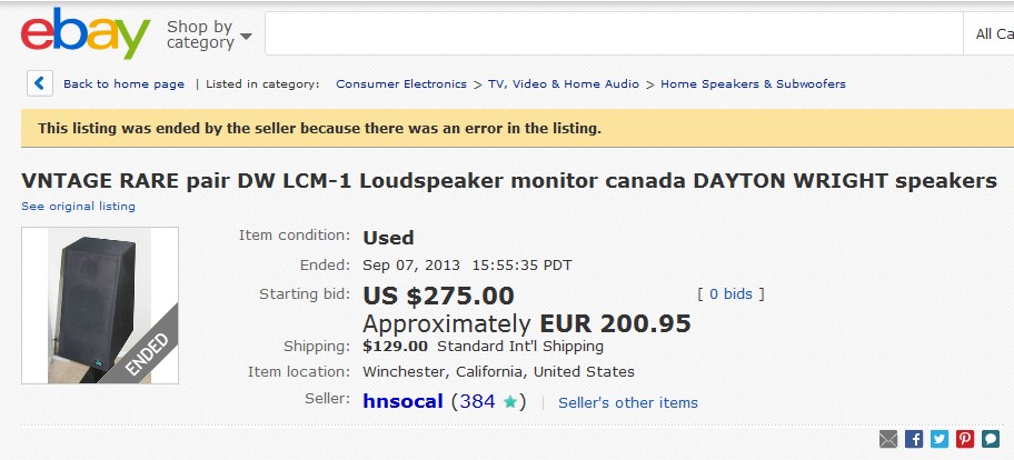

It's obvious you are not talking about the price, but about it's use. A lot of people are using BBC LS3/5A's also, nowadays and out of the studio environment, or just adding a subwoofer, for retro sound and retro quality drivers there's nothing better, including smooth Bextrene or paper cones, silk dome tweeters, anyway (ebay price)...

I was considering the hypothesis of the front baffle treatment being the result of one particular problem but it's obvious that, and after reading the (author of the) Dayton Wright papers and studio/main speaker placement articles, you don't want a speaker front baffle to be very reflective, in any way, and some are also spheres like Elipson, B&W and others (DIY), in the case of this small monitor with a complex pattern of reflective waves from the room ceiling that some say are very warm/cozy, I could notice this effect previously with other speakers, the mechanics of the room acoustics will be adding reflections from the walls and ceiling (and floor) and reflecting them by the more or less reflective surface of the speaker.

I sent an email to Dayton Wright asking if I could remove the insulation altogether without drastically changing the characteristics of the speakers or replace the insulation with Ultratouch cotton insulation since I don't want to breath in fiberglass. So far I have not received an answer but it's only been one day.
If it's this one Ultra Touch, Cotton Insulation - Recycled, High Performance - Green Building Supply it's very nice.
It's only a little bit thick (R13) 3.5"/89mm, what about half that thickness, can you do it by hand?!
http://www.greenbuildingsupply.com/...2953&c=772072&h=8158097f2c96daf3f105&_xt=.pdf
note: if you place your ears against the surface you can feel very quiet (no noise/absorption).
This is the R-6.7 batts, 2" thick material. Most users report it does not fluff up more than 1.25".
Mike Wright is well into his 80's , not sure if you'll get an answer. The insulation was to control dispersion, better if you try an alternate foam or felt pads if the current insulation material bothers you.
I purchased mine from a distributor near Dallas,TX. It's 16" wide >3" thick with serrated edges on two sides and if memory serves me (the rest is in the attic now still bundled) it was around $45 for the bundle and would cover somewhere between 30-40sq.ft.
From what I've read, when used inside a cabinet, it's supposed to tighten up the bass and extend the lower frequencies slightly because of the added "air pockets". This, allegedly, makes the cabinet appear to be larger than it is, hence more bass. I've used it in some PV12M's and A/B'd one with and without. The one with the Ultra Foam did sound better but it wasn't night and day. My main reason for using it was to avoid Fiberglass every time a speaker thumps! I also used it in a very old pair of EV S12-2's with upgraded speakers and it seemed to fair well. Much better than just removing the fiberglass insulation and having nothing in there.
The fiber finess / density (1-3") of Ultratouch is a very good match for dampening TL/BR/Sealed enclosures and breaks up the standing waves. Nothing magic about the stuff, just works a bit better than ages old material, like rockwool, fiberglass, cotton and wool that's normally used.
