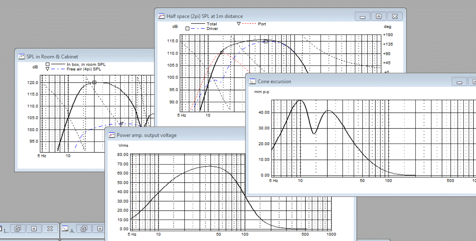

Attached is an Ultimax 18 in a 500 litres box, tuned to around 17Hz, with a 4th order high pass at 6Hz in place. This hardly impacts on the subs low frequency performance, but keeps it from smacking itself silly if some real infra bass comes along. It takes around 500 watts @ 8 ohms to get there, so we're pretty much at its 1000 watt limit into 4 ohms. Still, you're getting 120dB in room at 20Hz with very useful output down to around 14Hz.
Sealed isn't bad, but to hit the same raw SPL you'd need two drivers. I'd still want to high pass the sealed sub mind you.
Sure lots of people would say, I'd rather buy two drivers and not bother with the ported system, you could also go dual opposed push/pull with it, but for shear performance, you cannot beat the ported/PR sub.

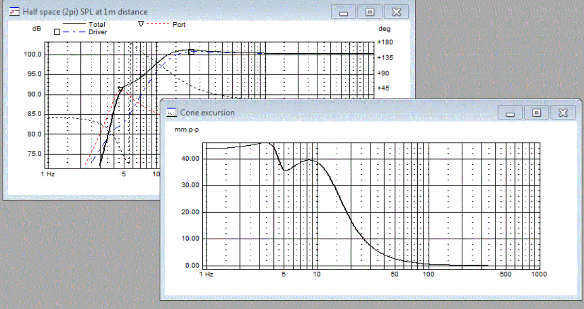

It's not that a ported box would need to be huge in order to do it. It would need to be huge in order to do it efficiently. You could drop the sensitivity of the driver down from say the 86 that the UM18 is, to say 75dB and probably end up with a driver that would tune down to around 6Hz in a similar sized box and with a decent amount of power give you decent output down low.
This isn't the problem. The trouble here is that it's largely pointless. Drivers don't typically exist to do this because there is extremely little demand for them.
Shaking the room with sound waves below 20Hz for HT is a very inefficient way of attempting to do this. A loudspeakers primary job is to create sound waves that we can *hear*, they are terribly poor energy conversion devices, with pathetic efficiencies, otherwise.
For things that you want to be able to feel, rather than hear, like T Rex stomps, you may as well go the sensible route and install some bass shakers to shake your seat directly instead of trying to do it through the air.

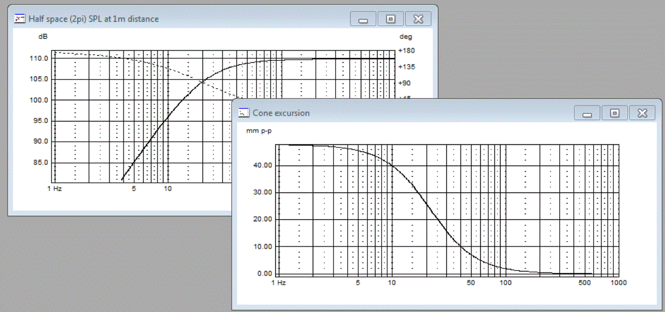

As an example though here is the Ultimax 18 driver with 1kg of added mass. A very crude way to do this but it does push the sensitivity down and allows you to tune it in a semi decent way to 5hz. Nothing incredible mine you. 2000 litre box and a little under 100 watts to hit xmax. Still we're getting some 92dB at 5Hz.
Putting the UM 18 into 2000 litres sealed however gives this.
A little over 85dB at 5Hz and it takes about 140 watts to get this far.
The ported box wins.
If companies wanted to produce drivers that would be optimised such that they could be tuned to 5Hz in a ported box then ported would beat sealed every time, it's just that these drivers don't typically exist.
