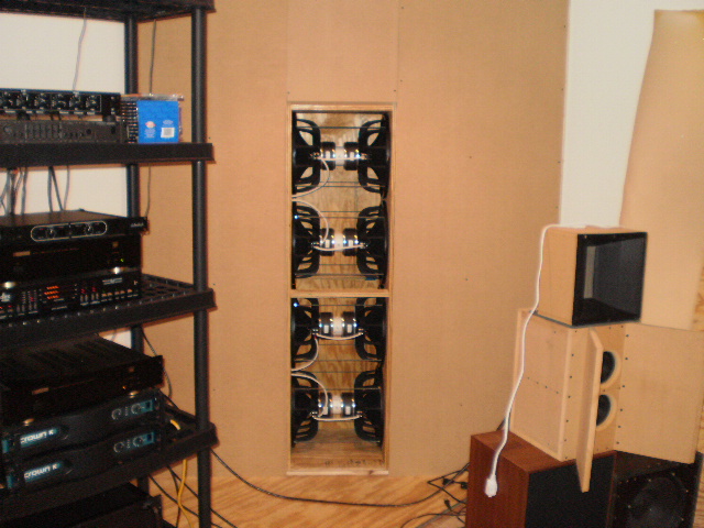

You can't have one 15inch woofer filling a room that's 25 feet by 30 feet with first octave bass. That's just too much air and not enough cone. I have a room that's 25 feet by 25 feet with 13 foot ceilings and I plan to use 8 of the same drivers as you. I'll be using an Infinite Baffle with 2000 cubic feet of enclosure space. The idea is to not overdrive the woofer and yet achieve bass at 17hz.
Something to think about.

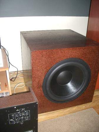

hi guys thanks for the responses.heres a pic.you see the adire ada 1200 separate. if i put everyting in the same box-way too heavy. i do realize my room is large for 1 15" woofer. 25'x30'x14' high ceilings.modeled in bbpro i get a f3 of 17hz.thats with a bass boost of 6db per octive at 45hz.i had the ada1200 set at 12db boost,2.5 octive bandwith set to about 40 hz.
i don't know how to calculate my f3 at those settings,can anybody tell me?? but i suspect i was running this sub very low,considering the size of the box.i inspected the woofer and spider-everything seams to be find.i will install .5-1 cubic foot of sand to make the box smaller

Here's how I did mine :
