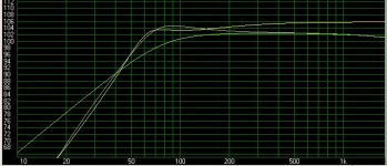

The Pioneer Driver:
It has a very low Qts and seeks an acoustic suspension alignment. If you seal the ports on your box and put one into it, you'll have f(-3dB) at around 180Hz and Qtc of about 0.363. This would be suited for guitar or bass use with no boom, and will sound thin.
That being said, if you leave the ports open, you'll have a gentle approach over a couple hundred Hz down to -3dB at about 100Hz, with a "bass shelf" extending from there to 70Hz. Followed by sudden assumption of -24dB/octave rolloff. The curves will cross at 42Hz, -15dB. Below there, the sealed alignment will be stronger, but this is the 1/32 power point.
I am attempting to attach the graphs my spreadsheet generated...
edit: typo
edit again: added thought
I think I'd go with the Goldwood sealed or Pioneer ported.
The Qts has it in your box (if sealed) at a nice quick alignment between Bessel and [closer to] Butterworth (Qtc about 0.67).
The ports have it tuned a little sharp though. It picks up a boom around 100Hz. If you tune it down with longer ports, the response starts to resemble the sealed alignment, and will lose control of the driver at resonance (you'll exceed Xmax at high SPL). A bigger box = a different story.
Happy shopping!
edit: "or pioneer..."
Goldwood in your box:
Happy shopping!
Yep, it looks like that Eminence woof is out.
Here's what I got and it was the same as Acoustimaxman.
I was surprised to see the Goldwood do so well. Both the Goldwood and Pioneer drivers ar a good fit in your box.
Gray - Goldwood Ported
Green - Goldwood Sealed
Yellow - Pioneer Ported
EXCELLENT Information
Thanks for the input. You guys are great.
The Pioneer looks like the best bet. It will fade off about 70hz, which will be fine because if I use a sub and x-over about 60-70hz, I'll be good. It's flat out the most efficient of the three which puts it closer to the mid/tweet efficiency. Even though it has the lowest power handling of the three, that shouldn't be a problem. Especially considering I had been using the Dayton 10" Classic, which has only 70rms rating....and it seemed fine.
