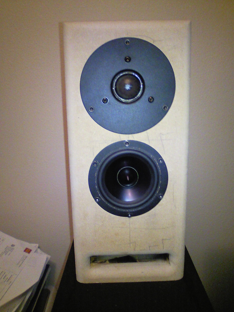

I have a DC28F with an RS100-8 in a two way ported system.
They obviously lack low end.
What do you think of using a DVC subwoofer crossed in at about 250hz on the first voice coil for the 3-way & and second voice coil crossed in as 80hz for a .5?
This may be the birth of a 3.25-way. LOL
I think it's BRILLIANT!!!!!
What do you all think?
perhaps cross the first VC a little below your baffle step frequency,
& the second will depend on the room, how low the DVC driver will go, & how much of a bass freak you are.... 🙂 go fer it....
