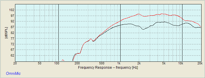

There is nothing inherently wrong with the Dayton RS Series. One should be aware that with metal cone woofers, it's not simply a question of severe cone breakup. The effects can be felt a decade downstream. In other words, if the sharpest breakup peak is at 10kHz, it is possible the cone rings down to 1kHz. This can be verified in measurements.
Obviously, the best way to use any metal cone woofers would be strictly for its' pistonic properties, but often times, we try to stretch it for a 2-way. Whether this causes the mid-range to "sound veiled and lack a natural smoothness" remains to be seen. Subjective opinions are fine but if a claim is to be made, they must be backed up with measurements. Otherwise, they are just personal opinions. Forum members should be aware of that distinction.
The attachment below is the raw frequency response of the Vifa XT25TG30-04 (black trace) and with the faceplate replaced with a 6.5"x4.5" Elliptical Waveguide by Pellegrene (red trace). The effects of the WG loading is clearly visible. This may help understand SpinMonster's preference to using a WG.

I used a 8.5x5.5 wave guide which loads the tweeter far lower in frequency and is important to note because it allows a far lower cross over than a 6.5" wave guide.
