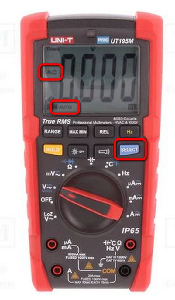

A 4.7 OHM resistor is connected to the output for the measurement. The DC offset is available for all channels. I will try it out with loudspeaker and "click". But a DC offset of 100mV and more is already very dangerous for tweeters. then do i have to use serial capacitor?

It's been a long time since I haven't written. I now have 4 pieces of the amp MA1260 and all outputs have high DC offsets up to 117mV! I connected 4 ohm speakers directly, as Mello4 said, and the crackling at each output. It is definitely not a measurement error! I measure with the UNI-T's UT195M DC multimeter. Who knows these problems with digital power amplifiers?

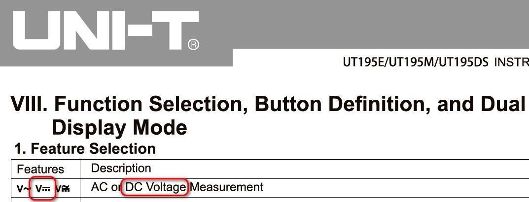

Are you manually selecting the DC mode (not the auto mode) on the DVM. If in Auto, it may give AC RMS of the amplifier switching noise.
Are you shorting the each input, to prevent stray signals from the input, when you measure the output DC offset?
