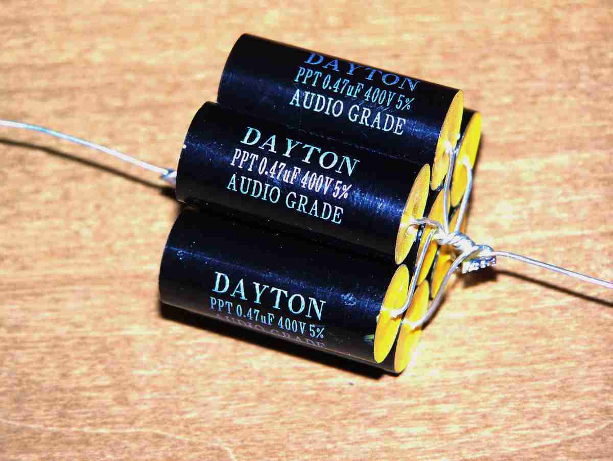

I finally got around to trying the big hype PPS caps at 2uf as coupling for the direct out of my CS43122 dac. Depending who you read, the micro thin Polyphenylene Sulphide dielectric is heralded as a giant step forward in measured distortion and sound quality in the audio band. I had high hopes for them due to the extremely small size which would allow a nice 7uf stack for the bass channels of my DCX mods but I am afraid the sonics fell slightly short of the Dayton foil which is so far in my experience unsurpassed in pristine clarity and tranparency of fine detail. They will trully spoil you from all other affordable caps for values up to 3.3uf. The PPS are pretty good though. Probably on par with most of the other metalized film caps I have tried at a fraction of the size but I will have to stick with the Dayton foils for their superior sound even if they are huge.

They are very transparent. If you want a euphonic cap these are not for you. $1.47 each for .47 uf.

Interestingly, the caps you linked to were SMD and (if you believe the specs) not PPS.
PPS has excellent mechanical and thermal characteristics. The dielectric properties are nothing special.
they never made a 2uf SMD panasonic pps, youve been using the PET.... the largest in that range in PPS is afaik 0.47uf, but only up to 0.22uf at digikey in stock
whatever they are film foils are much better than pps
thats a big and somewhat baseless call and far too general a statement. there are a number of situations where the SMD pps will outperform a 'huge' film and foil cap, especially for bypass use. PPS is not as good as far as dielectric goes (though not far behind) but the small size and surface mounting, makes the PPS a superior bypass cap, due to low inductance, small size, closer ground coupling/smaller loop area, low parasitics, less of an aerial etc
