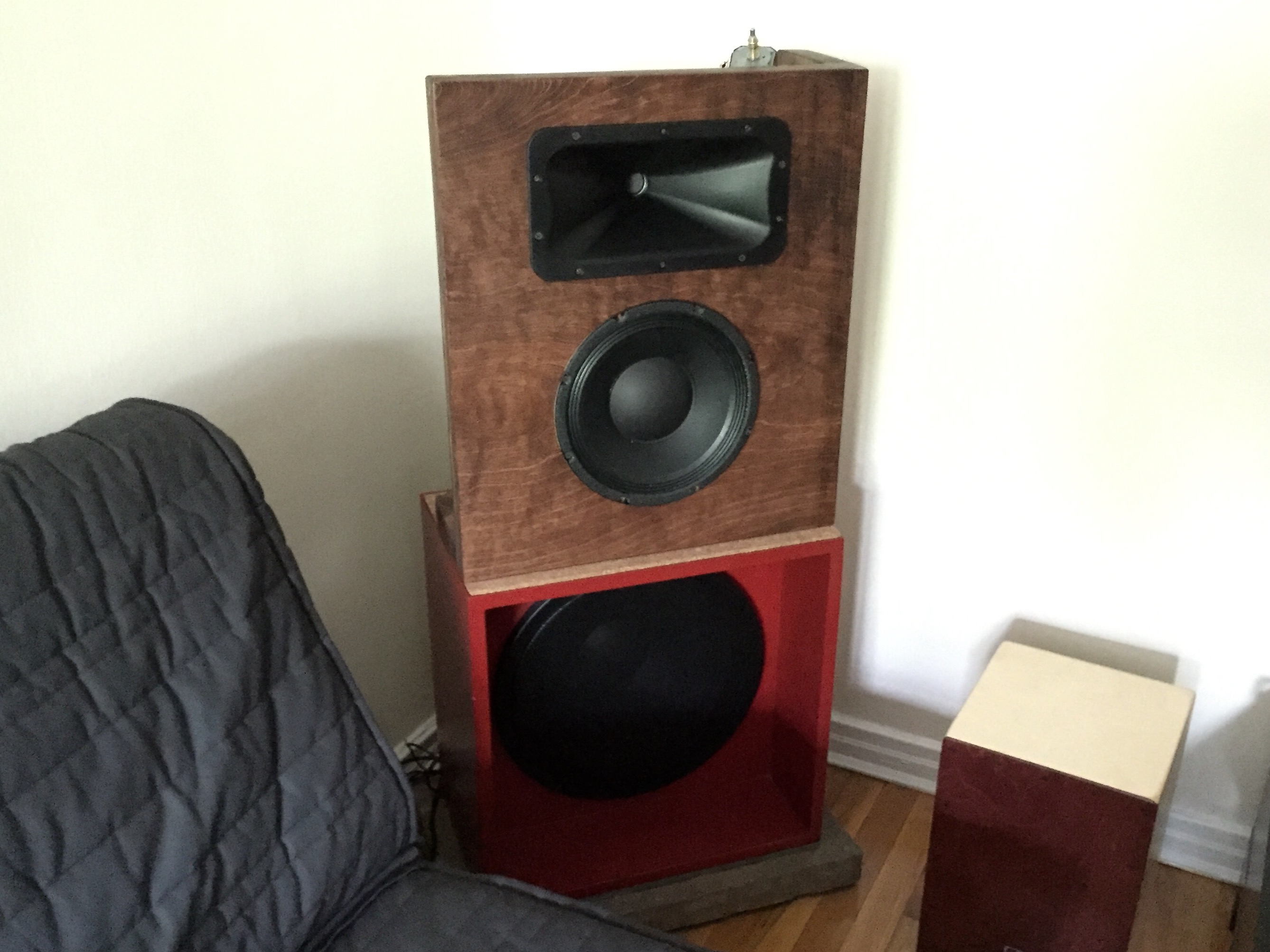

Hello all!
Dayton Audio DT250P-8 1" Polyimide Compression Horn Driver 1-3/8"-18 TPI 8 Ohm
plus
Dayton Audio H6512 6-1/2" x 12" Waveguide 1-3/8"- 18 TPI
plus
Eminence PXB2:1K6 2-Way Speaker Crossover Board 1,600 Hz
At first I thought it sounded too dull. Then I listened for a couple of hours. The more I listened the more I liked. This tweeter has barely any sibilance (nothing objectionable at all). Horns blare, vocals (both male and female) soar, strings sing. I really like it. Now I have to work on the mid/woofer. Currently an Eminence Beta 10A (originally I was going to put these components into a ported box but decide to go OB). I’m going to buy the Lil’ Buddy (same hole) and see how that works on OB.
The way it is now is actually pretty darn good (sitting on top of powered Alpha 15 H-frames) but I’m hoping for a bit more finesse thru the mids - currently a bit rougher than I like.

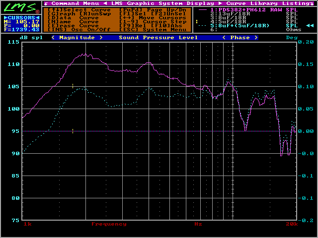

Hi "G",
You can restore a bit of Top-End ( HF-compensation ) to the horn driver by simply wiring a ( 2uF to 6uF ) capacitor across ( connecting ) pins 3 & 2 of that variable Lpad ( that I see hiding in your pic ).
- You'll need to tweak the cap value to taste since increasing the value starts to allow more & more midrange frequencies in to the bypass circuit ( plus, the position of where you have adjusted the Lpad makes a considerable difference to the needed HF "bypass" cap value.
This advice assumes the Lpad is wired normally & located between the output of the HF portion of the crossover & the HF driver.
An impedance correction circuit ( Zobel ) across the woofer would help insure that the LF portion of your network is behaving as was designed by Eminence ( ie; simplistically, for a constant 7 to 8 ohm impedance ).
Something like a 7.5R ( 10watt ) resistor ( in series ) with a 10uF capacitor, ( & this combo ) wired across ( in parallel with ) the terminals of the woofer, should help immensely.
I'd suggest implementing both of these tweaks before spending more money on other horns or woofers.
PS; - One can simply add ( parallel ) multiple caps together to achieve a larger values / meaning, you could buy multiple values of 1.5uF & 2uF values to create many possible combos.

Many thanks freddi, Flaesh, EarlK and JShadzi! I will continue to experiment. I'm certainly a fish out of water when it comes to pro sound components but I sure am enjoying them as an alternative to the usual 'home' brands I've tried over the years.
I purchased the Dayton exponential horn out of curiosity. It's similar in size and shape to the Dayton constant directivity horn. I didn't even know there was a difference? I wonder if the exponential will have that 'tunnel' sound some horns exhibit since it's got a longer throat? The one which sounds best to me will get the most attention as I continue to learn.
Meanwhile, the Dayton DT250P plus Dayton H6512 doesn't disappoint! It reveals a lot of texture and is very easy on the ears.
The mid/bass driver (Eminence Beta 10B) sounds a little thick thru the midrange and sometimes even garbled at higher volumes. I'm guessing it's upper frequency limits/breakups may be playing a role. I've ordered a Lil' Buddy which fits the same hole and will give it a listen in the coming days.

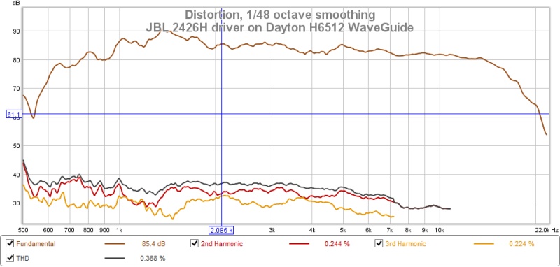

I took a chance and bought a pair of Daytons ( purchased from Solen, here in Canada ).
- I do hope to return them ( with their co-operation ).

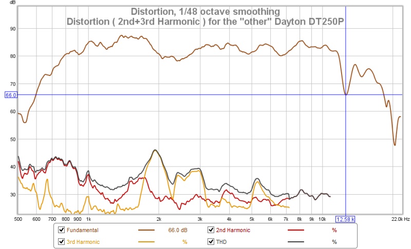

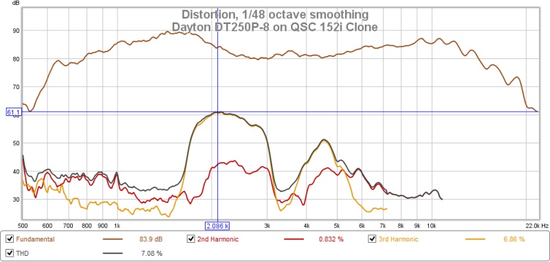

Here's the distortion spec for the worst performing driver;
Obviously ( at least to me ), this driver is quite sick and not performing up to a professional spec. ( though maybe it's good enough for the consumer who doesn't measure anything ) .
The following shows a healthy driver ( distortion-wise, under similar test conditions, though with a different waveguide ) ;
The other Dayton driver doesn't fare that much better ( re; 3rd Harmonic distortion at @ 2K, is about 1.6% ).
- This driver was measured on the H6512 waveguide.
The notch at 12.6K is caused by ( I think ) the Dayton driver being unable to fully thread into this waveguide's 1 3/8" receptacle ( Dayton made the plastic threading, too tight ).
- This same driver on the QSC 152i clone doesn't show the 12.6K notch / & neither does the JBL ( which I was able to force fully into the H6512 horn ).
I believe the high distortion specs ( for both drivers ) are caused by the voice-coil binding ( touching ) the gap of the drivers.
( If true) this might also be the cause of the hollowed out response of the FR ( from 2K to 6K ).
- I can understand how the "hollowing-out" could actually be attractive ( as a feature ) to those in the HiFi world who can't design their own networks ( ie; it's much like a built-in BBC hi-mid dip ).
