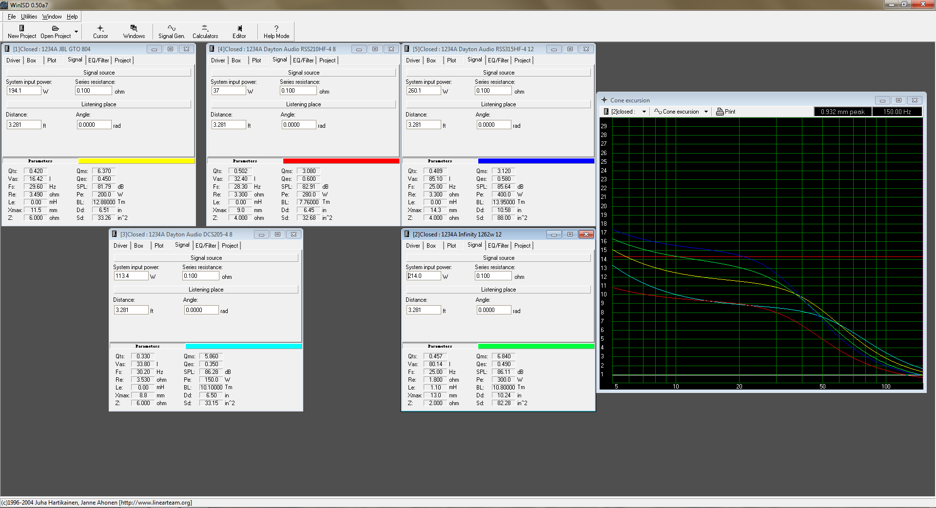

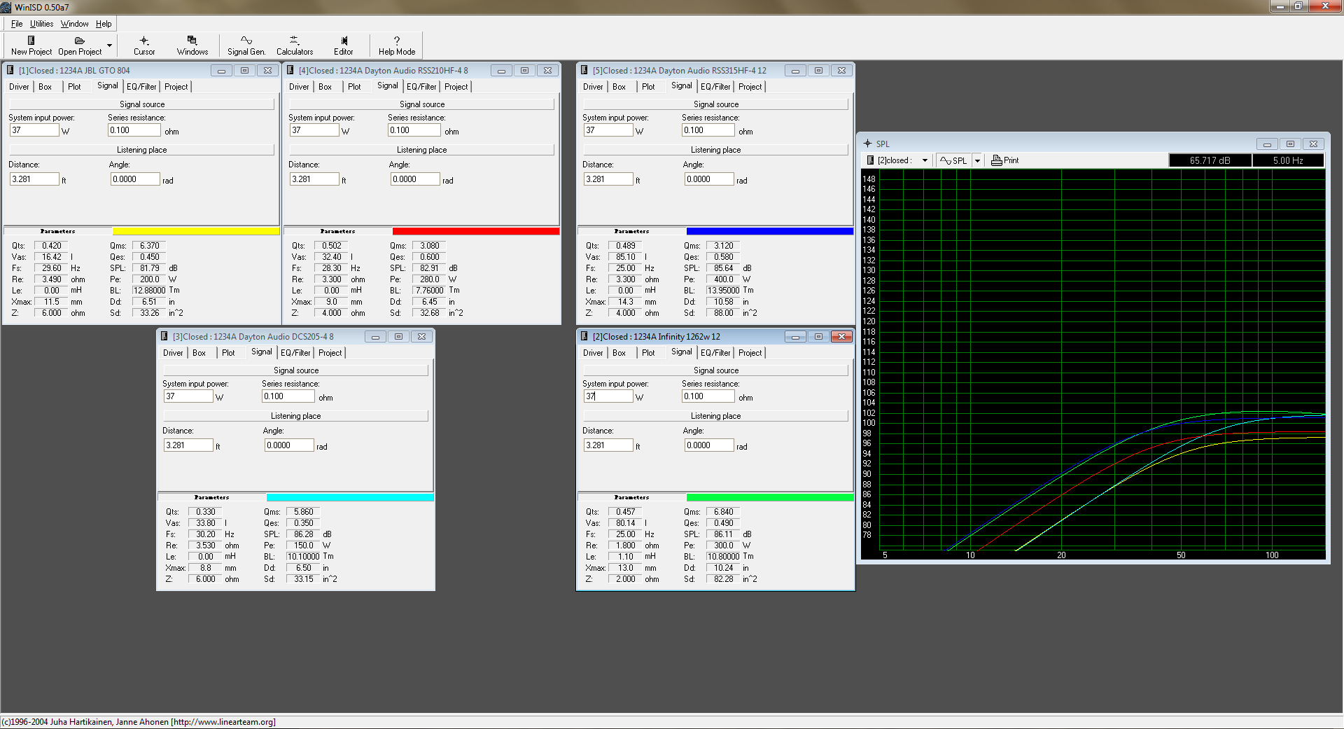

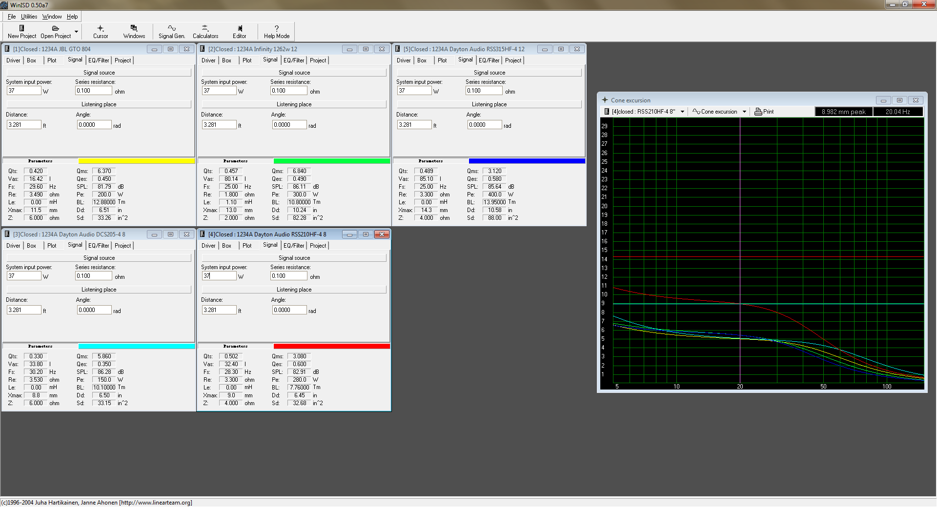

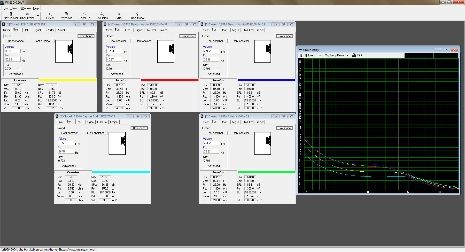

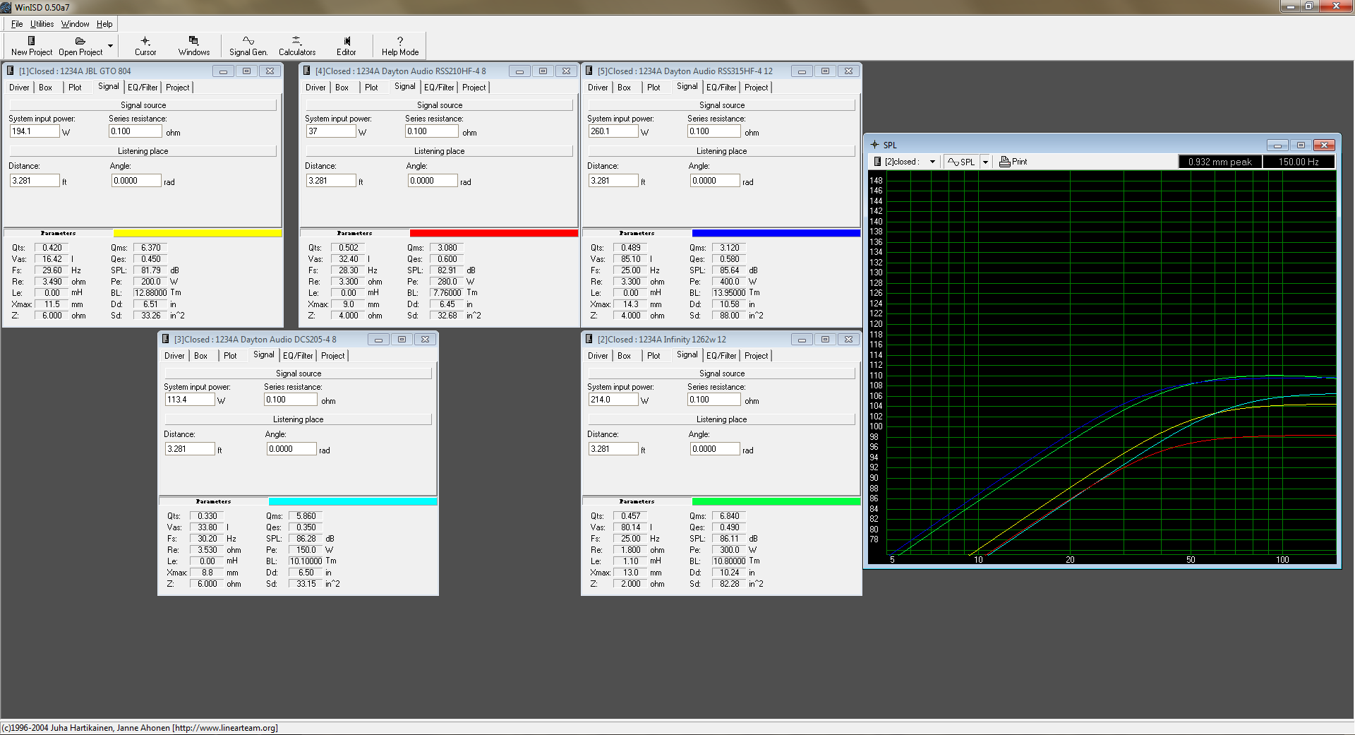

My personal conclusion is that the JBL GTO 804 is the best driver overall for your application.
The Dayton Audio DCS205-4 8" and the JBL GTO 804 both had pretty similar performance.
The Dayton Audio DCS205-4 8" had slightly better group delay, although this is probably an inaudible difference.
The Dayton Audio DCS205-4 8" has lower moving mass, theoretically giving it faster response/better SQ (debatable).
The Dayton Audio DCS205-4 8" needed 80 Watts less to get to max SPL (although lower on average).
The JBL GTO 804 had more output under 60hz, which gives it an advantage in output (although it is slight)
The JBL GTO 804's enclosure was a bit smaller, giving it a small size advantage (again, very slight).
The JBL GTO 804 has slightly lower Le, theoretically giving it a faster response/ better SQ (debatable).
The bigger difference here was that the Dayton Audio DCS205-4 8" has an EBP of 86.3, while the JBL GTO 804 has an EBP of 65.8. This suggests that the Dayton will do much better in vented than sealed. The JBL might do a little better in vented, but does just fine in sealed. Personally i prefer sealed anyway.
It's a bit of a tossup, personally I'd go with the JBL.
