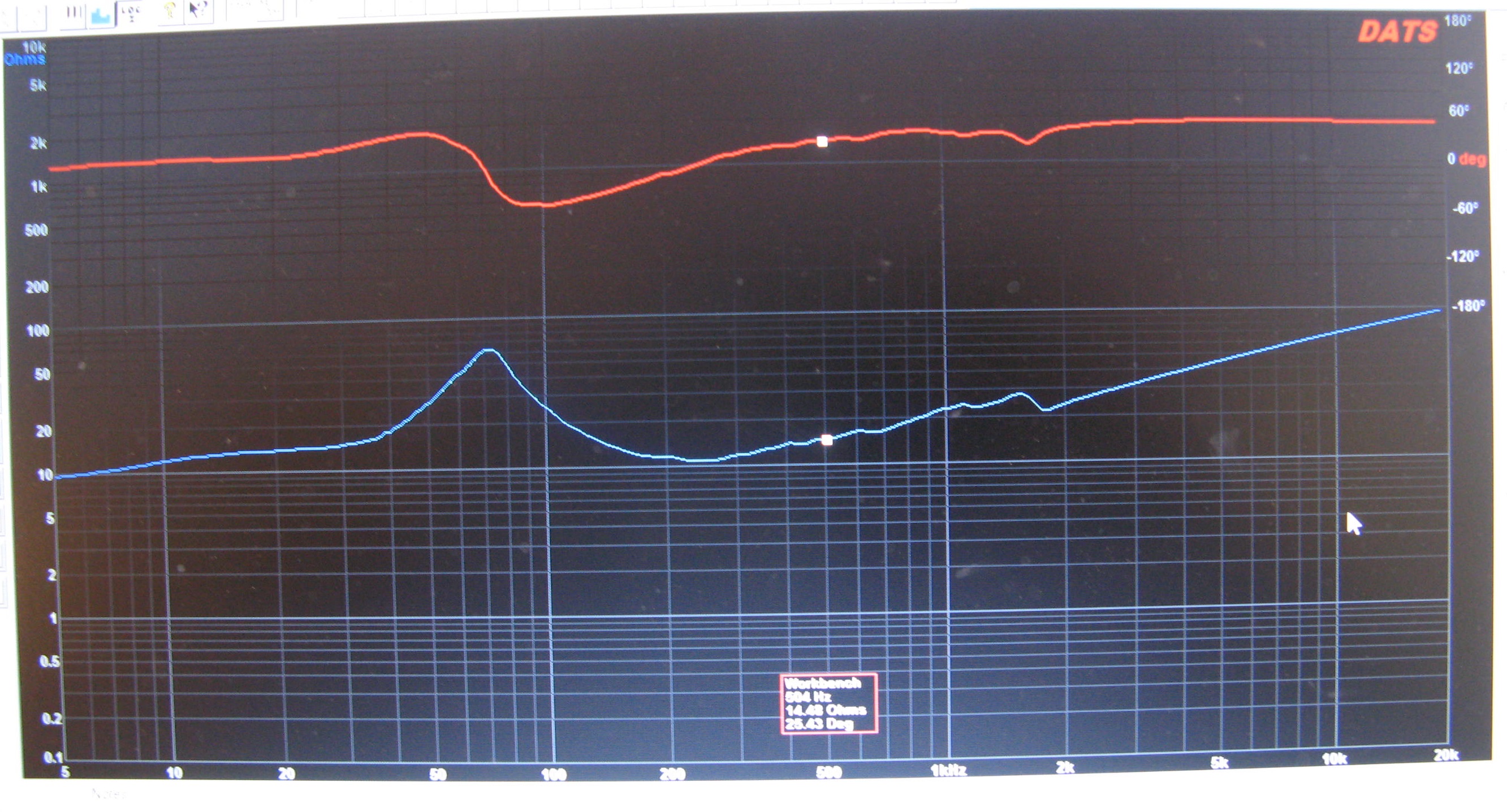

I quickly cobbled together crossover for speaker project consisting of Altec 803a (new cone old spider and VC ) a 12 ohm nominal impedance in ~ 4 Cu Ft closed box , JBl 2441 trurextent dia 16 Om in 270 HZ (estimate) Tractrix horn (Sierra , Brooks) and tad Et 703 super tweeter (8 Ohm) Crossover is all 1 st order: 3mH on woofer , 20 uF on mid plus LPAD and 0.1 uF on a supertweeter .
I hooked up DAT's V2 to that bundle and the impedance plot is ruler flat at around d 15 Ohm from 100 Hz to 20 kHz . There is impedance peak at 75 Hz (aroud 80 Ohm) where F3 of the sealed cab is. I must be doing something wrong. It shouldn't be so good should it??

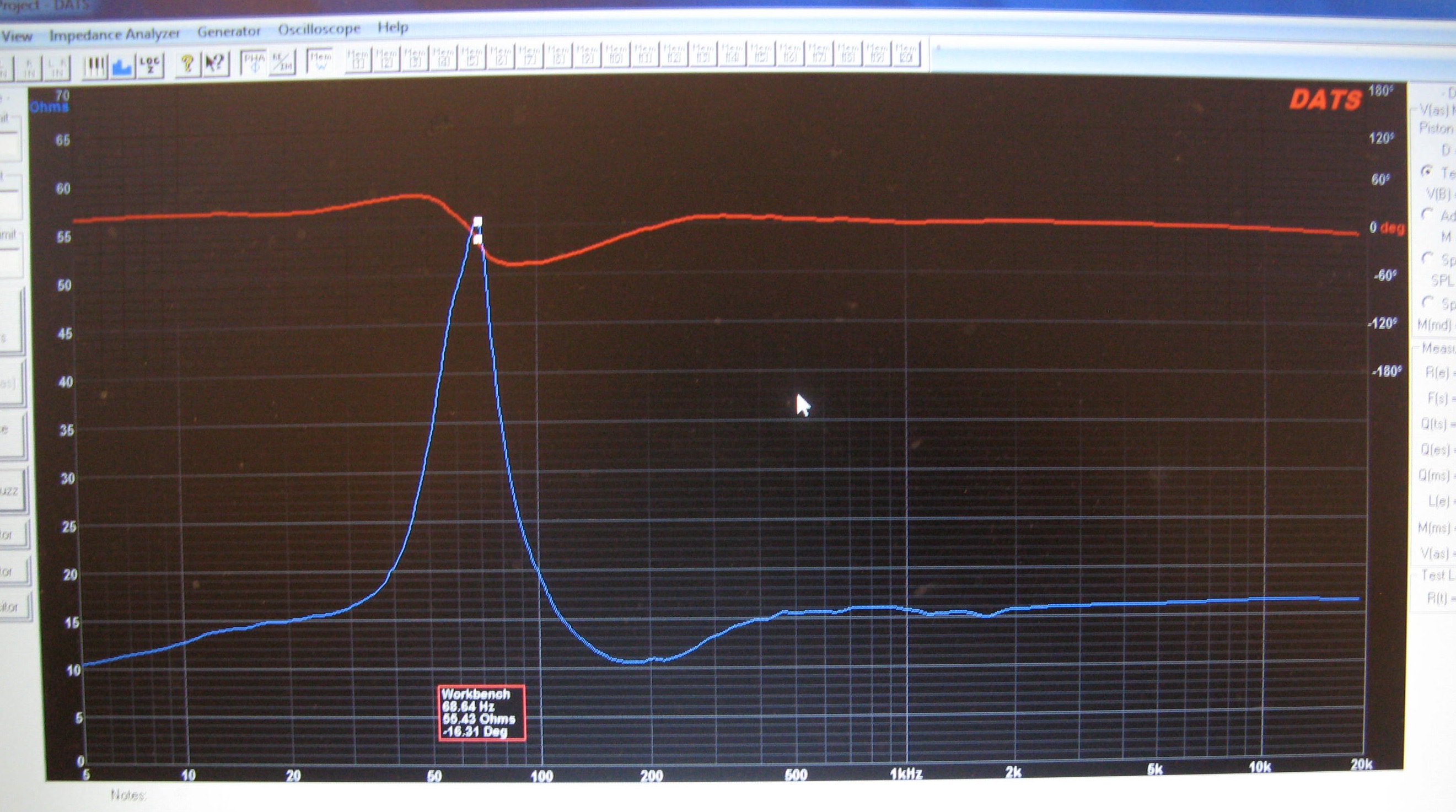

I took impedance sweep of just a midbass in the cab without filter to make sure the rig measures semi correctly .

I suspect it is: try adjusting your scale to something more 'realistic', since at the moment you've got DATS displaying impedance in logarithmic mode with a vertical range of 0.1 ohms to 10k ohms. Fine (possibly) for measuring a variety of resistors, not so good for a loudspeaker. 😉 Change the starting point to 0 ohms, and drop the maximum to about 70 or 100 ohms rather than 10,000 and you'll find your graph looks more as you'd expect. I suggest you also shift it to linear scaling while you're at it.
Scott is right of course, the scale is way too course. I haven't used DATS, but the WT3 would auto-range.
Thought the cabinet was ported, because it looks like a port above the woofer. Is that a horn cutout? A single peak is correct for sealed, and yours seems kinda high circa 75Hz.

The resonance peak is at 68 Hz which is kind of expected with woofer of Fs~45 Hz in too small of a closed box. Those woofers are 100 dB. I may have to use Zobel to flatten the peak (58 Ohms ) or it may not be needed. Once I pull the drivers from the cabinet (after I acquire those matching Santana boxes). I will measure the drivers again and maybe there will be a way to implement them better.

As a sanity check, measure impedance of the bare drivers without box/horn and without crossover. Compare to mfg datasheets, if they are close enough then you can also trust a measure in box with crossover. But I highly suspect that there is something wrong.
