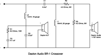

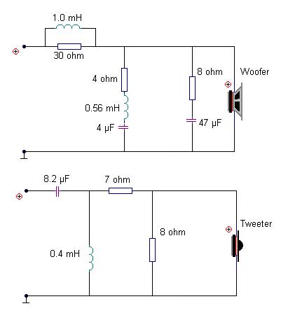

Hello everyone. I'm thinking of building a pair of Dayton BR-1 speakers.
I would be interested in your opinion on whether to do it with your original crossover or with the crossover modification proposed by Dennis Murphy.
The drawer would have the measurements of Paul Carmody's Classic II.
The position of the drivers would be respected according to the original BR-1.
The duct would be later.
Another question is if the tweeter in Murphy's crossover mod is the Dayton DC28F-8 or does he have another.
First is original and second is Murphy.

I had the opportunity to assemble a stock BR-1 kit from PE for a friend and have a good listen. The original crossover is minimalistic with cost in mind and as such doesn't correct the short comings of the midwoofer. The mids are a bit veiled and muddy, but for the money the kit is a good value to get started. It would be best to consider Carmondy's or Murphy's crossovers depending on how much you are willing to spend. Both are said to clean up the sound nicely, but I haven't heard them.
Anything I've read about Mr Murphy's revised XO is positive - it's a significant upgrade in sound from the stock. However, Dennis did two crossovers for the BR-1 due to the changes in the tweeter which have happened over time. The one on his website is the original, so if you're using the latest DC28F, there is a better XO. You might find it on Parts Express Tech Talk.
One good thing about Dennis' XO - either version - is that he crosses the tweeter over a bit lower than the BR-1, which is a good thing as the DC160 doesn't have the best mid-range.
However, in your position, I'd also consider Paul Carmody's Classix II; the Vifa tweeter sounds a bit clearer, to my ears anyway. The DC28F can sound good, as in the TriTrix, but it has a sticky dome material which attracts fluff and insects. It has a soft-ish plastic mount with only three holes.

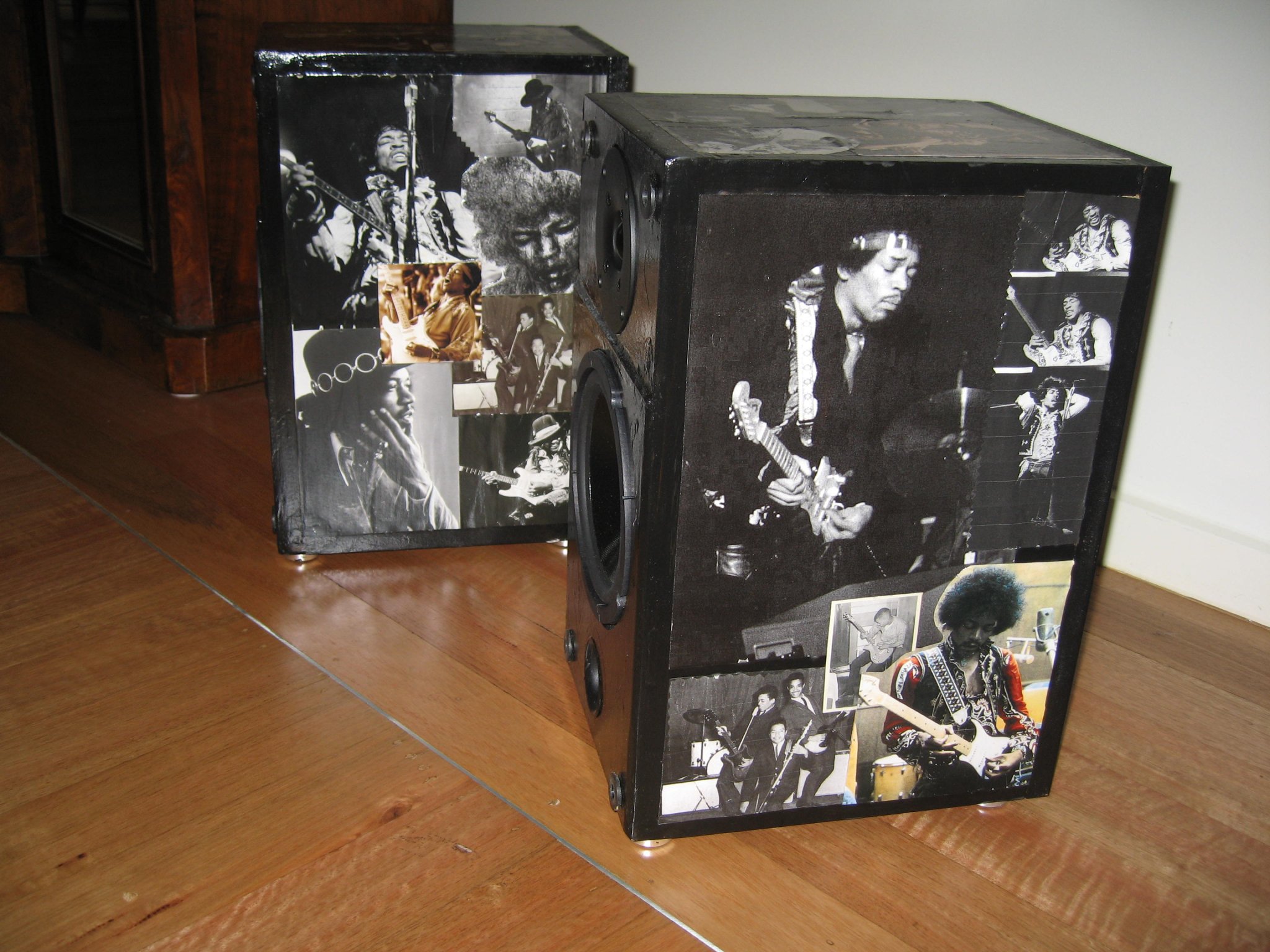

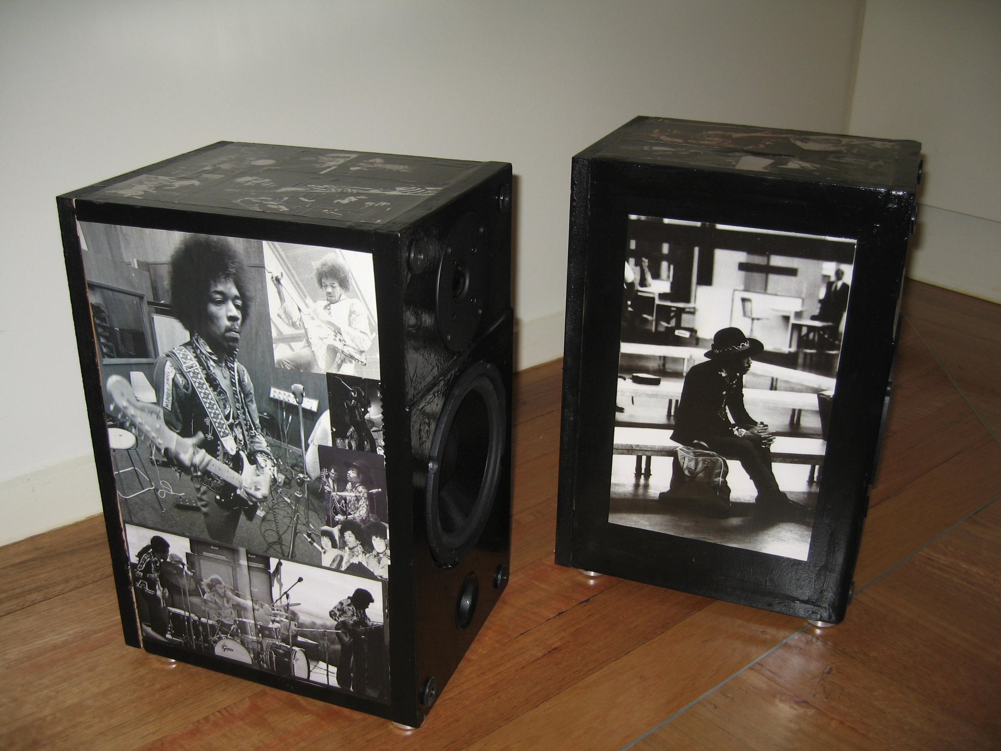

An advantage of buying the BR-1 kit is that you get the finished cabinets and don't have to make them, although Parts Express does sell the Classix II kit with a knock-down cabinet. I just bought all the drivers and XO bits and used Paul's excellent website to build them.
I made my cabinets myself, you can tell!

Your version of the BR-1 is very interesting.
I've emailed Dennis. he has answered me and sent the current diagrams.
They are much more complex, mainly in the tweeter sector, and also more expensive.
Since he has not published them, out of respect I cannot publish it.
