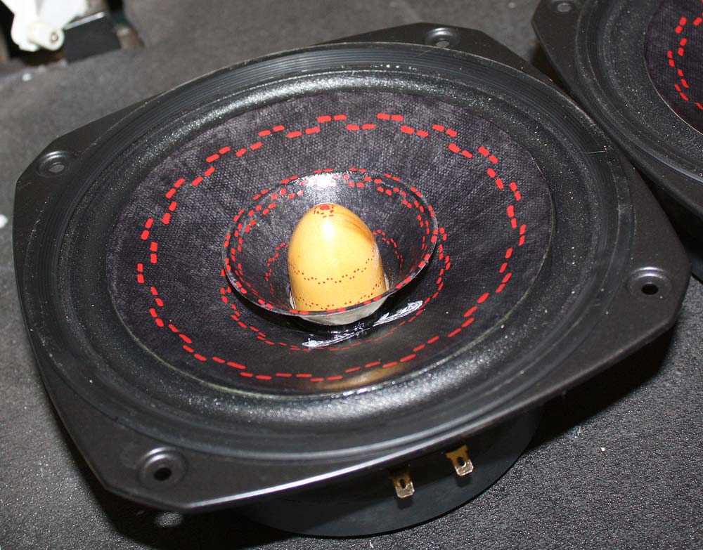

Re colouring the Fostex cones, Dave's been doing that for years as part of his modification packages, which in my experience significantly improve the raw drivers, so that's something you may wish to consider. For completeness, I should point out that Dave is a personal friend -however, I have no involvement with his Planet10 driver modifications, other than having had (and still have) some of his modified units, which have been a significant improvement on the unmodified Fostex drivers.

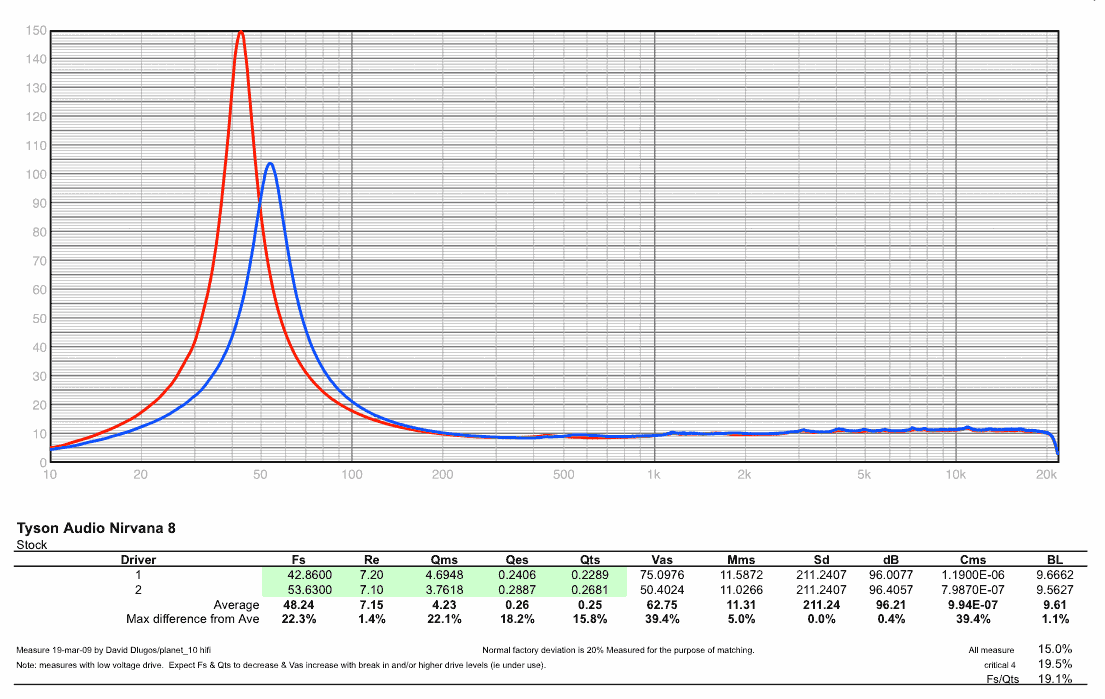

I had a pair of the old Super 8 here and the 2 drivers measured so different i would not consider them the same driver at all. near +/- 20% from the average.
You have to keep the coating light and it does not create a consistent black, but it does help suppress the HF ringing.
Ouch. Not pretty.
Rarely a bad idea with whizzer cone drivers. 😉

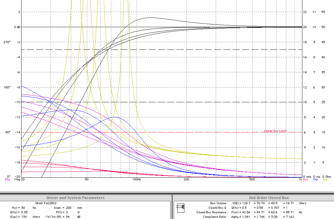

So , I opted for the Seas 22 in a 2.8 cu. ft. vented cabinet
I have the AN cast frame 12" drivers too which I enjoy but don't have the room available for the cabinet it wants to be in.
The FA22 is also happy with a sealed enclosure which makes it a rare beast. Above is a recycled KEF Calinda box, a bit smaller than optimal but still good.

So Dave. It sounds like the seas drivers would be a good Match for my friend? A sealed box. Wow I haven't seen a sealed box design in a long time. Wondering ?How much is it for the Enable Treatment to these drivers? Just trying to give him all the options? Also good idea about using a aready built box. Thanks Jeff

How much is it for the EnABL Treatment to these drivers?
Jeff,
It includes phase plugs so EnABL/treatment would be $180 USD. I have a new pr here, so that would make logistics easier.
Here is the sealed sim, looks like a well damped sealed box between 35 and 70 litres is appropriate.
