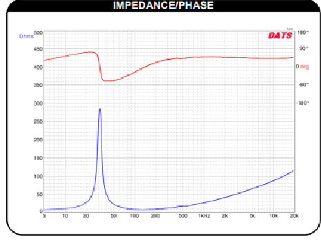

It doesn't matter. All woofers have a peak at their Fs. Put it in a bass reflex box and you'll have two peaks. 🙂
The peak won't effect your crossover unless you are crossing very, very low. You aren't, are you?
In which case one needs a series notch filter 😉: Series Notch Filter Designer / Calculator

Actually, the resonance peak is around 32 Hz. Nothing to worry about. Have purchase quite a few and they, so far, have been very consistent and very close to spec.
The peak is of little or no concern when properly used in either a vented or sealed box. Can even be used in an open baffle. How do you intend to use this driver?
