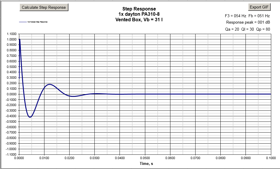

Your measurements are VERY close the the manufacturers with the exception of the le and a bit off on the VAS. Did you use added mass or volume method?
The final qts is almost identical. It's not at all uncommon for people to be posting their measured results being 20 - 50% off manufacturers specs so I think you are fine.

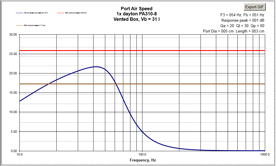

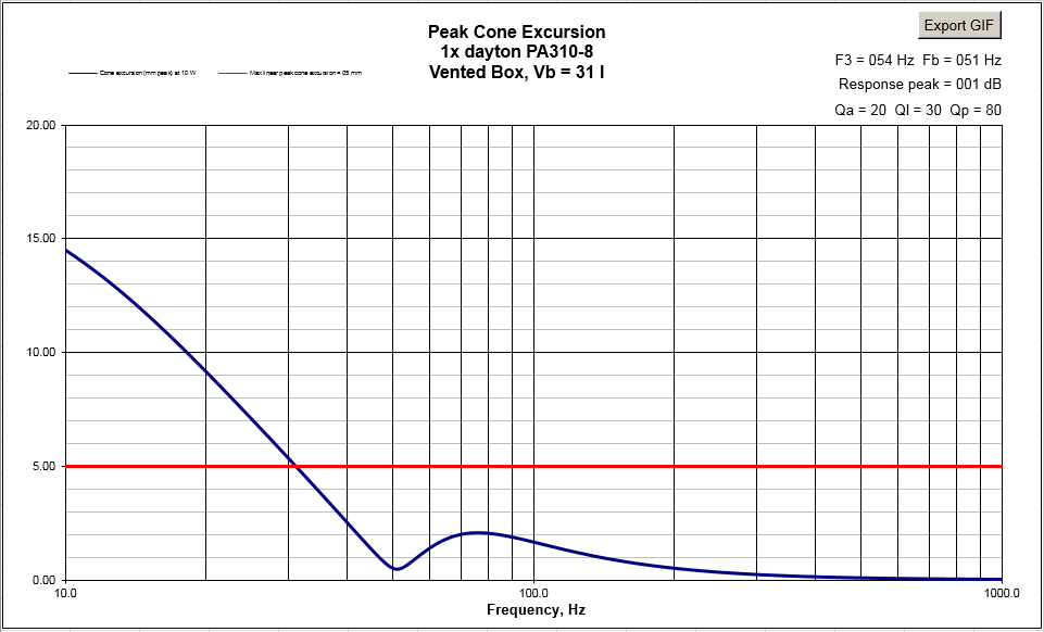

Are you sure you haven't made a mistake in your winisd sim? I just modeled your specs with a 31L box tuned to 51Hz and it is one of the best looking BR I've ever modeled. So good to make me wonder if something is wrong!
Tony.

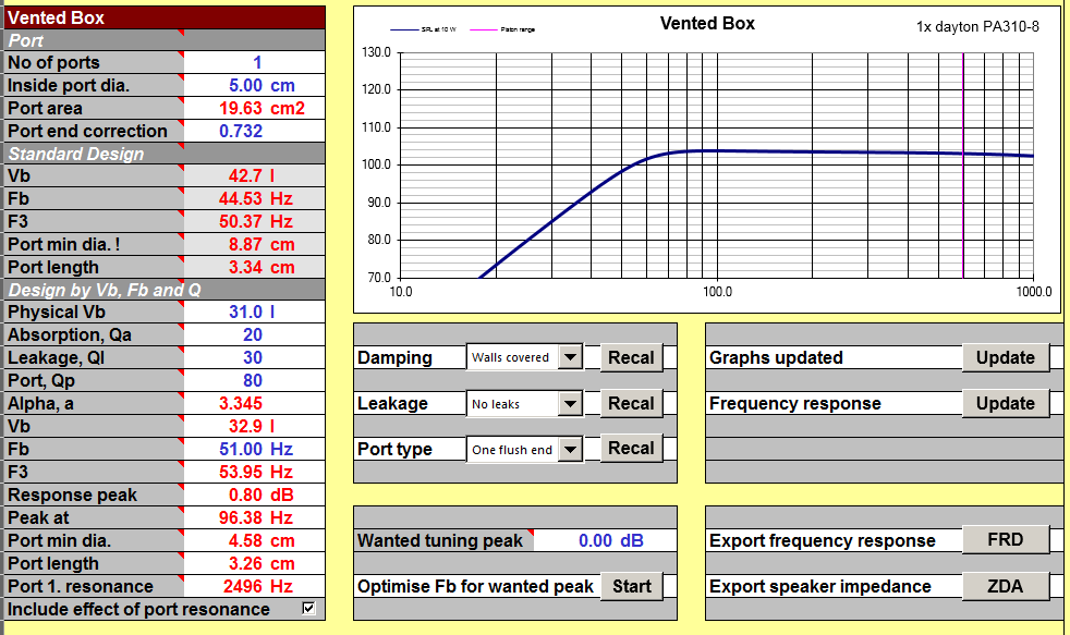

With my measured values, it comes out to be 37.8L at 44 Hz. This is better, but now I wonder why there is a difference between out programs. Which are you using?

I'm using unibox which is an excell spreadsheet. Note I ignored what unibox said (it recommended 42L and 44Hz tuning, and put in what you had as the factory recommended box. That is what I posted, and to me it looks very good.
If you use four different box programs, you will most likely get four different recommendations 🙂 whilst there are various recommended alignments, you don't have to be bang on one or another to get something workable.
Tony.

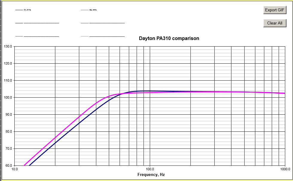

Here is a comparison between the alignment recommended by unibox and the factory manufacturer recommendation. The factory one being the darker one. Obviously the recommended one is more extended, but if you want to go with the smaller volume I don't see any issue with it at all.
edit: didn't refresh before posting 🙂 ok I think the winisd recommendation looks good with your measured specs, and it looks like this driver is well behaved over a range of alignments so yes do some experimenting and come up with something that suits your requirements 🙂
Tony.
