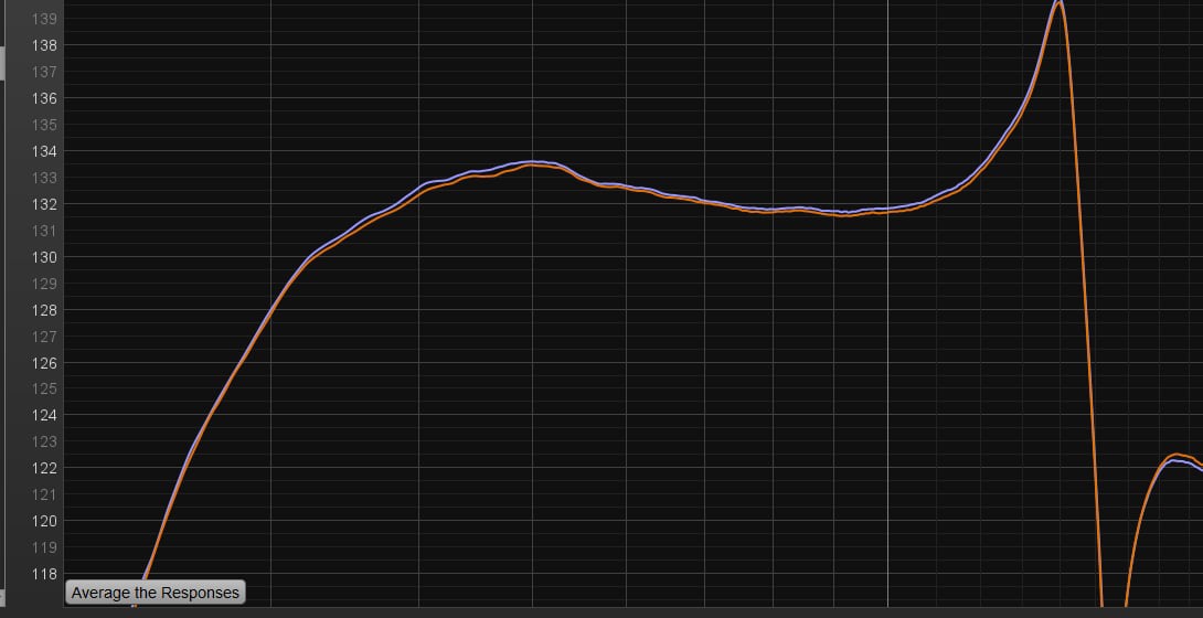

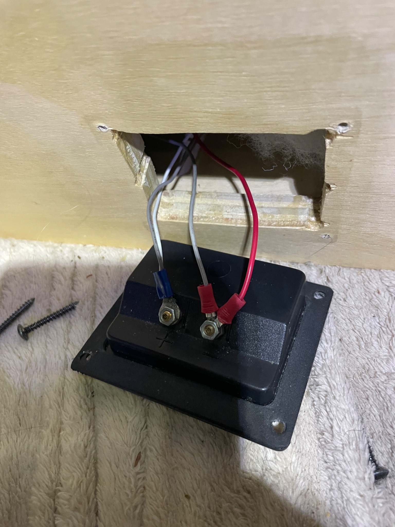

How come I’m getting the same exact measurement with dual voice coils connected or only a single?

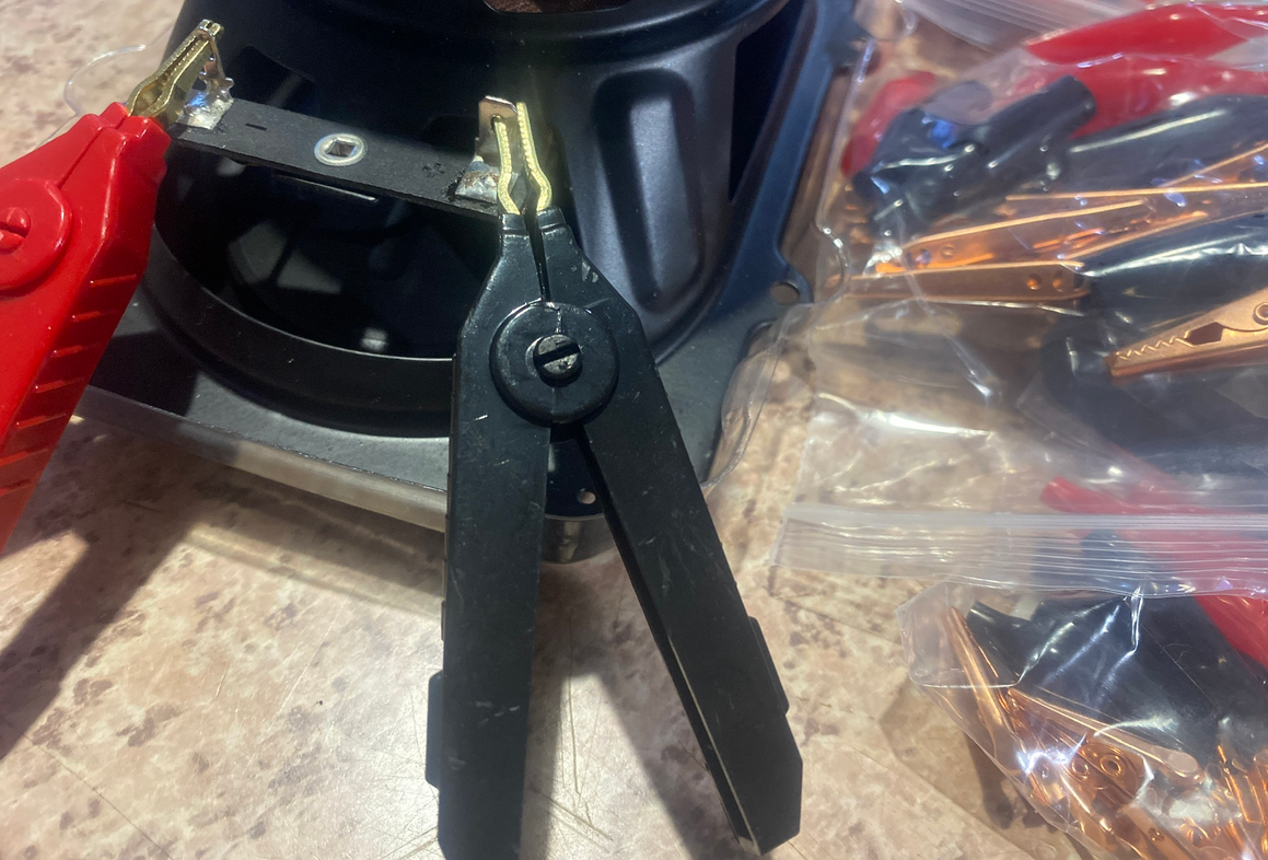

Check each coil one at a time. Maybe the second one is open circuit and not changing anything when connected?
Here is the thing with Dats, the silly alligators make for some wild readings depending on the weather, time of the day and the neighbour's underwear colour. I found it very difficult to get the reading for the racer. Check your connections inside the box too
Should I replace the alligators with those needle nose stronger units that I got in?

This is my fault….
REW is often complaining when I take measurements through the dats due to insufficient output levels, etc.
Works fine if I use an amplifier.
I dunno why it shows a previous measuremebt (again) (or why the drastic change in TS parameters with the single voice coil and RE would be ‘the same’

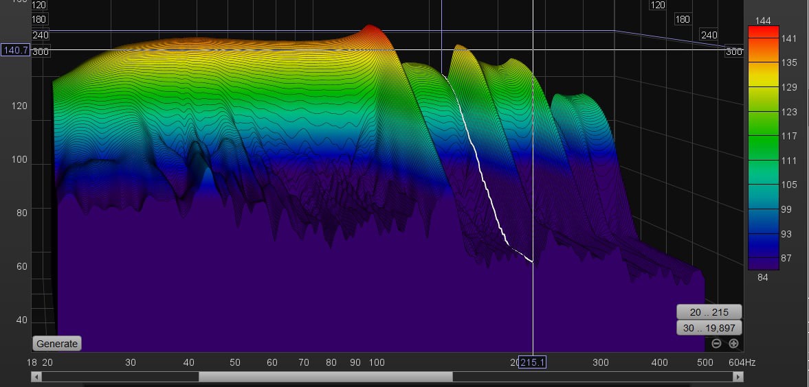

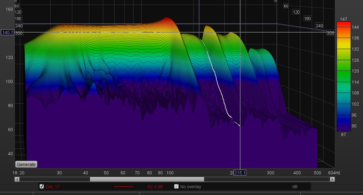

Everything works fine if I don’t use the ‘dats’ in the signal chain….

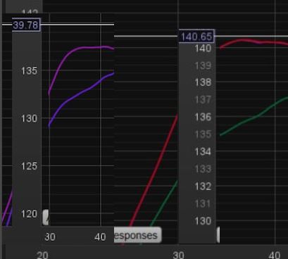

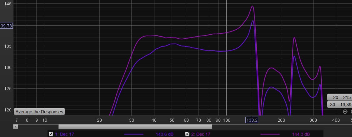

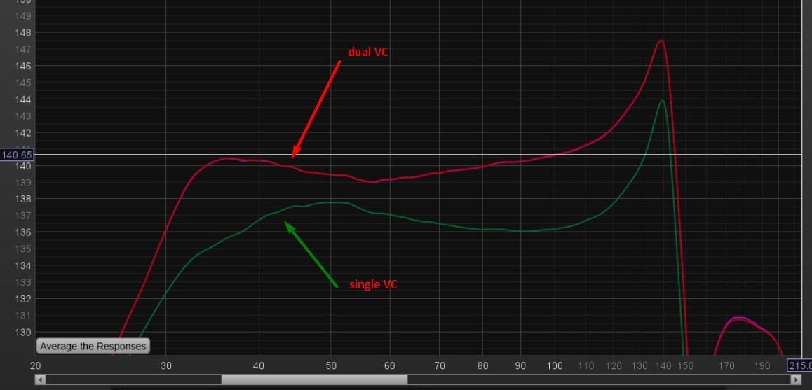

(I was studying the affect of a weak/strong motor in my most recent TQWT subwoofer)
More than 6dB difference using a single vs dual other than in the 50Hz range, that's even more than I'd have expected.
Have you checked if there is a difference in the response between the two single coils, in other words, does using only the inner or outer coil make a difference in the motor force?
