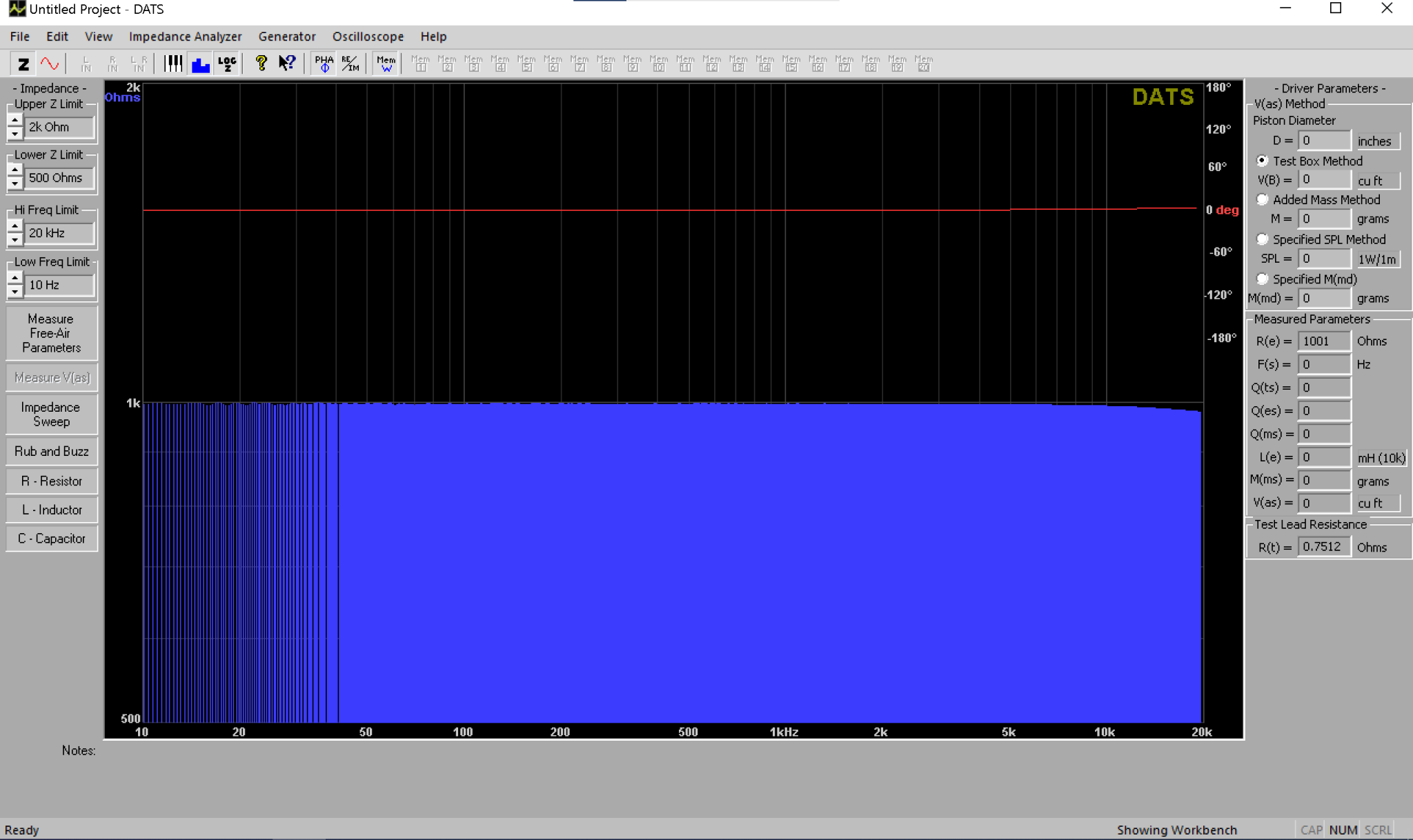

Simple question: What the heck? I used to be "good with computers," but now I'm not as good as I was. I know that the sample rate for the audio device is correct, and I know that there is some performance/priority tweaking that Windows 10 can do for USB devices, but I don't know where to look.
The screenshot is the result of "Calibrate Test Leads," but I see similar blue fuzz any time I try to do a resistance or impedance measurement. Using the cables provided by Dayton or any other probe leads that I have handy.
I've tried a couple of USB Type-C to Type-B cables, and each of the 4 Type-C ports. This is an all-Type-C machine, and I don't even know where the Dayton USB cable is, but I can look if you really think that's the problem. No devices attached to any other port, running on battery, same result with Windows in Airplane Mode or not.
Intel i5 MacBook Pro (iMac14,3 A1418)
Windows 10 Pro via BootCamp (not parallels)
DATS V3 (H)
