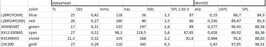

Here's a list of drivers that I either had sitting here or I could get from stock and at a reasonable price. I threw in the venerable Beyma 15K200 that I also have a couple of. The original housing can accomodate two XXLS12 in the original V-baffle if it is made about 1 cm wider (which is possible if you use thin sides as SL did with his prototype). The 15 inch RSS would probably have to live a solitary life in an S-Baffle (but it has about the same displacement as two 10 inch L26). I think it should be possible to put two 15K200 in a W-baffle and just make it fit.

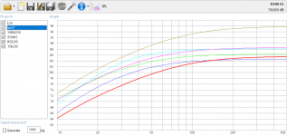

I entered the parameters in WinISD to see what kind of efficiencies I'd really get, and I plotted the SPL of 1000 l closed boxes as an approximation of the FR in an open baffle.

The biggest surprise for me was that the datasheet values are all over the place compared to what WinISD calculates. I was familiar with prosound midbasses that had SPLs based on midband on axis SPL, but I hadn't come across this in sub drivers.
WinISD outputs "USPL" as the SPL at 2.83 V / 1 m and "SPL" as the SPL at 1 W / 1 m, so USPL should be the same as the data sheet value.
Seas quotes an SPL of 86 dB for the L26RO4Y which is close enough to what WinISD computes for 500 Hz (ignoring Le effects, because I didn't enter Le). Their L26ROY is quoted at 1 dB more, but this clearly is not the case at 500 Hz, wehre it is 1 dB less efficient. It is correct relative to its sibling if you look at e.g. 80 Hz, which may be considered the upper range of where the sub might be used. But why would one manufacturer who updated drivers and data sheets within months of each other when production was transferred from Taiwan to Norway use two completely different definitions, i.e. the asymptotic level for one and a realistic one for the range of a sub for the other?
Little surprise then that the numbers given by Tymphany, Scan Speak and Dayton make little sense, too.

So what does this mean in my application, which uses a 120 Hz LR4?
Let's look at the L26ROY (blue) vs. the original L26RO4Y. Although it is nominally less efficient at HF, it is really 0.5 to 1.5 dB more efficient throughout the range where it would be used. Its Q in the baffle might be very close to the 0.5 preferred by SL

Ok, and then if it is ok to use a higher efficiency, slightly lower Q driver, the next more sensitive is the 30W4558T that gains another dB but has an even lower impedance, loading the amp more. There are HobbyHifi magazine tests of the old L26ROY and 26W4558T that seems to share its motor with the 30W, and the 26W fared substantially better in terms of LF distortion, but then we know that SL saw the need to improve on the old L26ROY. The 26W and 30W are also supposed to be similar to Peerless 835016 and 017. The 835 16 did not look nearly as beautiful in Vance Dickason's Klippel tests as the new L26, but it had significantly lower HD3. We don't know the box volume in each of these tests, though.
The Peerless XXLS 830845 is a different story. It is an 8 Ohm driver, so it is much easier on many amps. The voltage base graph here does not tell the full story. It is nearly 3 dB more efficient than the L26RO4Y! It is also very quiet in terms of wind noise. Since I have it sitting here, I will probably try it first.
The RSS is impressive in that a single driver has the same displacement as two L26. However, if I used a single driver, sensitivity would take a hit. It would also have to live in an S baffle, though, which is a significant change from the original design. I haven't been able to find how it performs in terms of wind noise, and its mechanical losses are double those of the L26RO4Y, or the same when scaled to Sd but suspension hysteresis might matter most at small displacement. So not a good choice at this point.
The 15K200 looks more attractive, but it would require a W baffle. Wind noise is not a problem but some units have problems with ticking noise from surround or tinsel leads when operated free air. While it is theoretically 10 dB more efficient than L26RO4Y, due to its low Q, it really is only 1.5 dB more efficient than 830845 at 30 Hz so might need current drive and MFB to realize its true potential.
