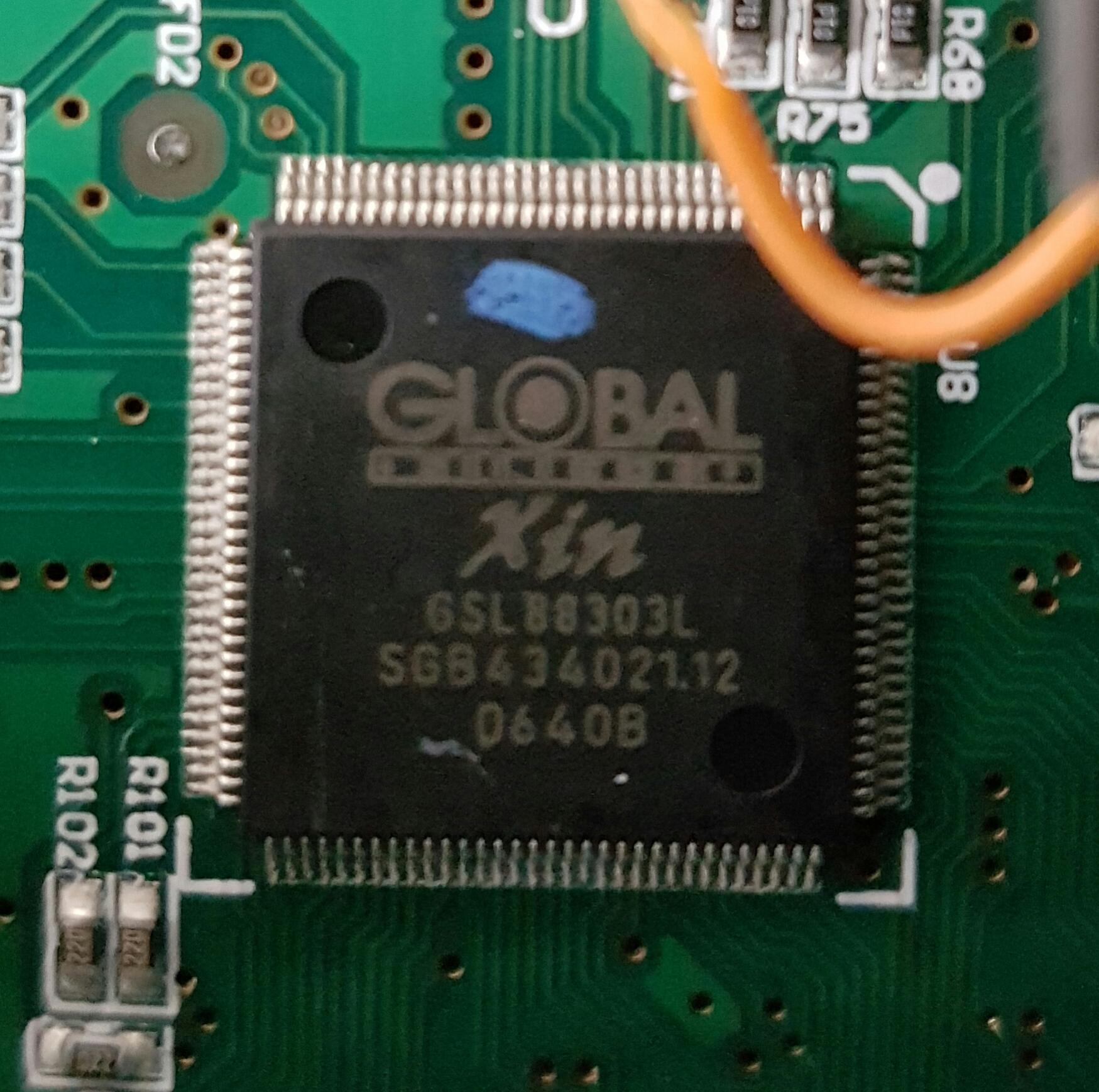

Hope I can get some help here. Does anyone one have a data sheet for the Global Xin GSL88303L servo chip.

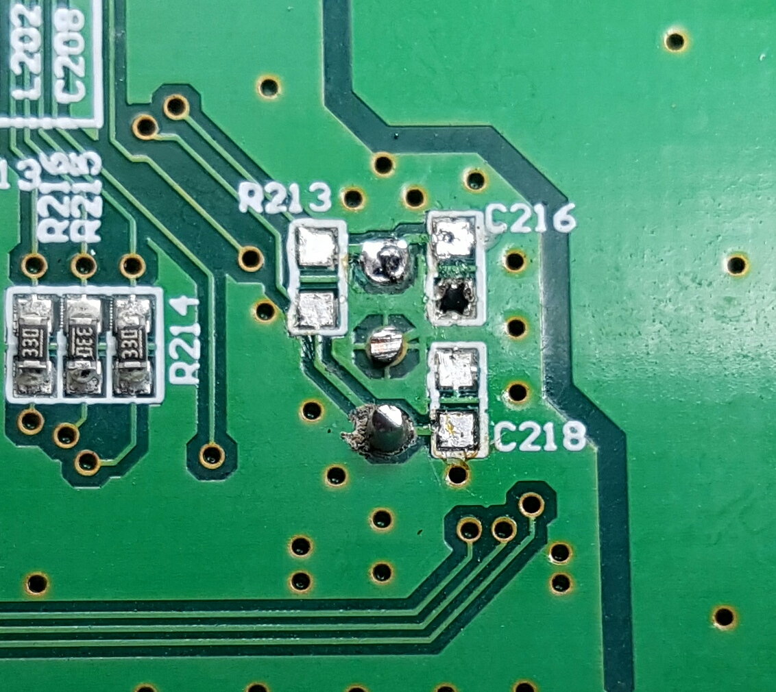

It is used inside my Rega Apollo R cd player. The problem is I was using a clock ( net audio ) that has a 1 megohm feedback resistor across the output. As you can see from the photo I have removed the feedback resistor on the Rega board( r213).
I am now using a Newclassd clock which does not have a feed back resistor on the output and although the cd player is working it drops out more than it used to
So does anyone know the value of r123...Rega were no help.

Contrary to the advice: I have seen a few CD players that behaved erratically without that resistor !
BTW that soldering joints look quite bad. Please redo with good old 60/40 leaded solder and clean the PCB afterwards with isopropyl alcohol. Maybe it is just a bad connection. Also make it a habit to cut first and then solder the wires. Just adapt and enjoy more reliable electronics with better looking joints as a bonus without any negative side effect ! The way you have done it puts mechanical stress on the joints which leads to premature failure/non successful DIYing.

Modded a lot of CD players and some skip when leaving out the resistor. Value is between 220 kOhm and 1 MOhm I noticed but I don't know the right value in the Rega. This is a one chance only affair (PCB tracks may come loose) so I think it is wise to wait for another owner of the same CD player to check the value.

If it is a one chance only affair I would not gamble but send a PM to that guy and ask him if he can tell the value. Apparently he has replaced those chips more than once. Low effort big gain. No place for gambling in electronics. Why would you solder in a possible wrong value only to discover you have to take it out again and pulling off the PCB tracks in the same process ? At the cost of one resistor you could destroy the device. The technical (and right) approach would be to first find out the original value in whatever way. Just one email.....
