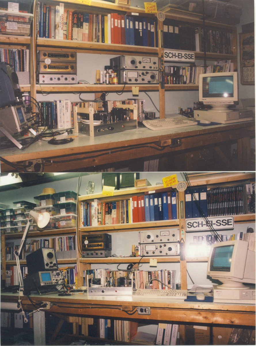

Think I will pass on your advice anyway. My workshop about 10 yrs ago, a laptop now replaces an old CRT thing, All hooked up to some test equipment, I gave away my 2-channel, 100 MHz scope several years ago.🙂
But I like the wine jug in the photo. Did it contain some of California's best?
