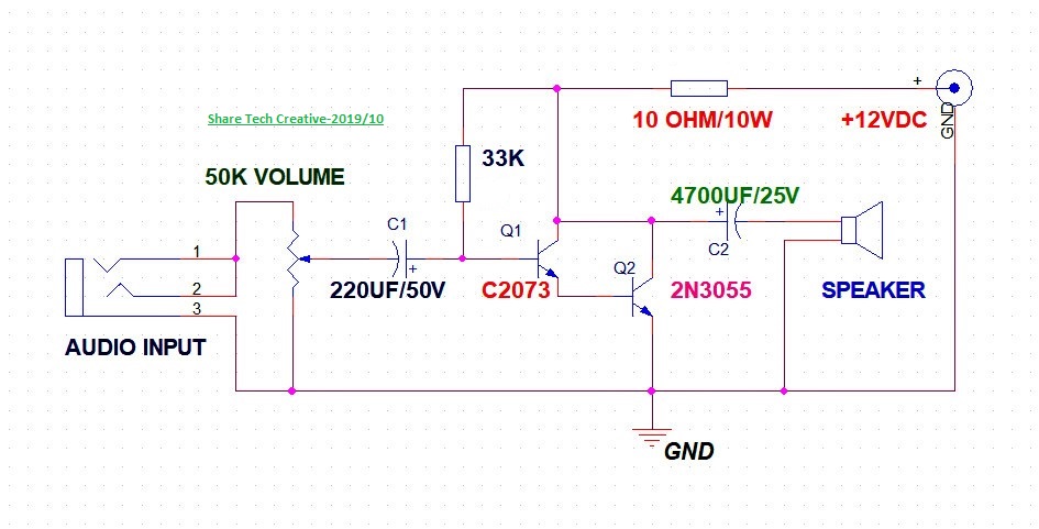

Darlington amp built on heat sink.
There's a Youtube channel where a guy makes clever little audio amps using one or two transistors with no circuit board. I've attached one of them. Interested in hearing your thoughts. The name of the channel is Share Tech Creative. English is not his first language.
