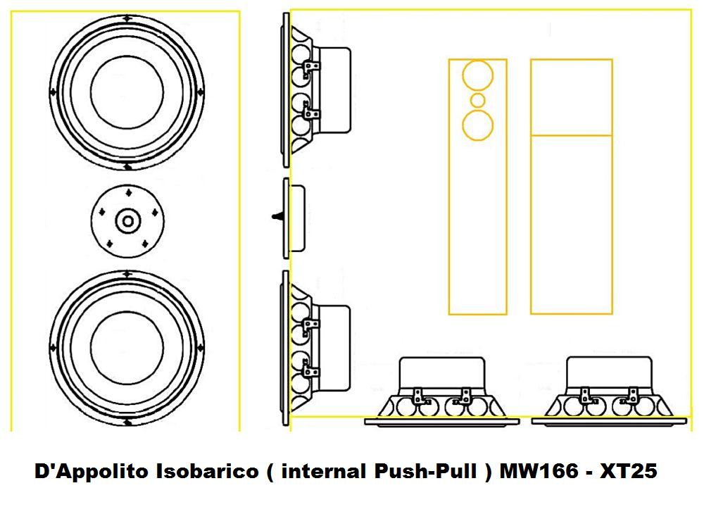

Modern loudspeaker configuration is an internal Push-Pull 😕
natural sound comes from complementary copules

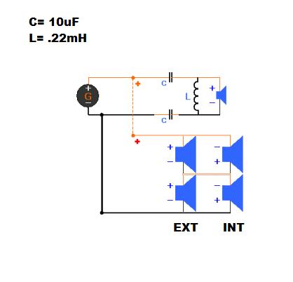

two drivers are mounting inside an isobaric volume
and connected in reversal polarity 😎
the other bottom volume (about 2X Vas) is closed
in my case four Morel MW166 plus tweeter Vifa XT25 for each channel

I built a couple pairs of MTM isobariks back in the early 80s (KEF T27+B200x4 and T27+B110x4). They both suffered from the predicted suckout of an isobarik operating into the midrange. The upside was a very distinct removal of box signature from the sound.

Hi
I built A LOT of couple pairs of MTM isobariks back in the 90s

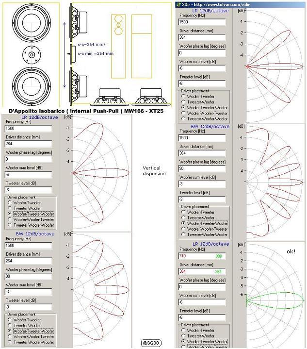

now i have found the secret:
it's very important have distance between external/internal wfrs
inside isobaric room
that create a tuning in different tone ( do - mi - la )
distance m - t - m is 150mm (axis to axis)
so totally 300mm m - m
at the moment just twt is filtered
