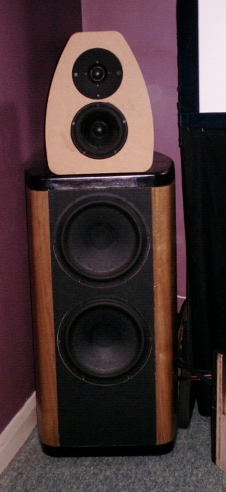

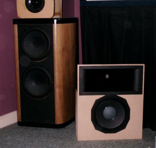

And a sneak peak at my new toys in the making:
PD107 10" mid, beyma 380 cd on a td250 horn. (Did someone say dynamics ?😉 ) Will sit on top of a jbl 15" (sealed) - jbl 80 - 250Hz, PD 250 - 1200 ish Hz, horn above, tempests below atm...
Rob
Am looking for a jbl 2226G in need of a recone if you know of any Al🙂 (got one, need to make a pair)
Rob

The PDs are great drivers, and paired with the JBLs, you sbould have a really dynamic system. I don't recognise the compression driver from the numbers, but I'm sure I would if I saw it. 😉
Crystal Pro Audio

The PD is 99dB sens - I'm only adding a 6dB high pass on it as the bafflestep and sealed roll off do the other 18.
Did anyone mention amp noise😉
Rob
