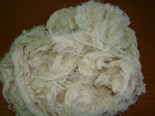

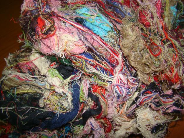

The industry is selling for many uses, like for garages (to clean the oil).
The properties are some what different between wool, cotton and rockwool (use this instead of glasswool).
Here pics of recycled cotton.🙂
